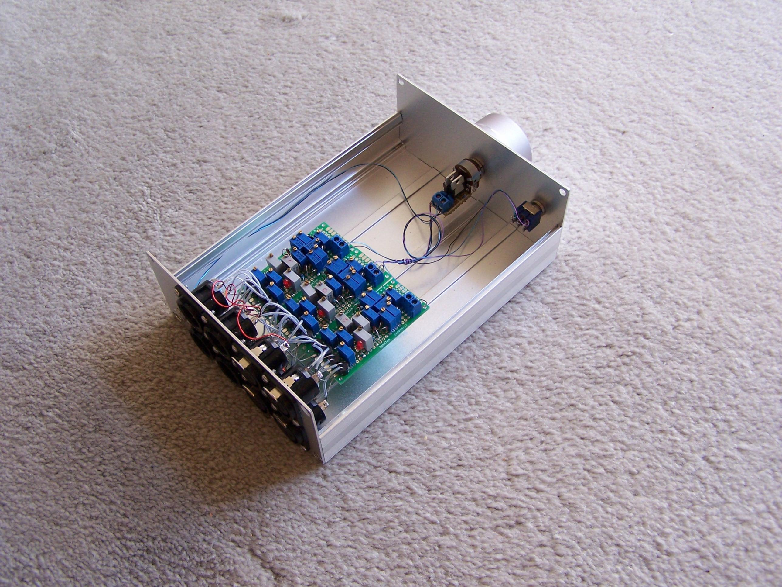

Looks like you had fun?? and would have had trouble, looking at the amount of trimpots you needed for this balanced one.
As I've said many times I will never do XLR, to do an XLR Lightspeed is more than exponentially harder to do, even impossible.
And to do any form of auto calibration is also fought with problems, as the active auto calibration circuit has to be attached the the signal output.
And whatever type of auto calibration circuits we used with all our prototypes, it had a detrimental effect on sound quality compared to doing it the hard way and just matching up quad sets.

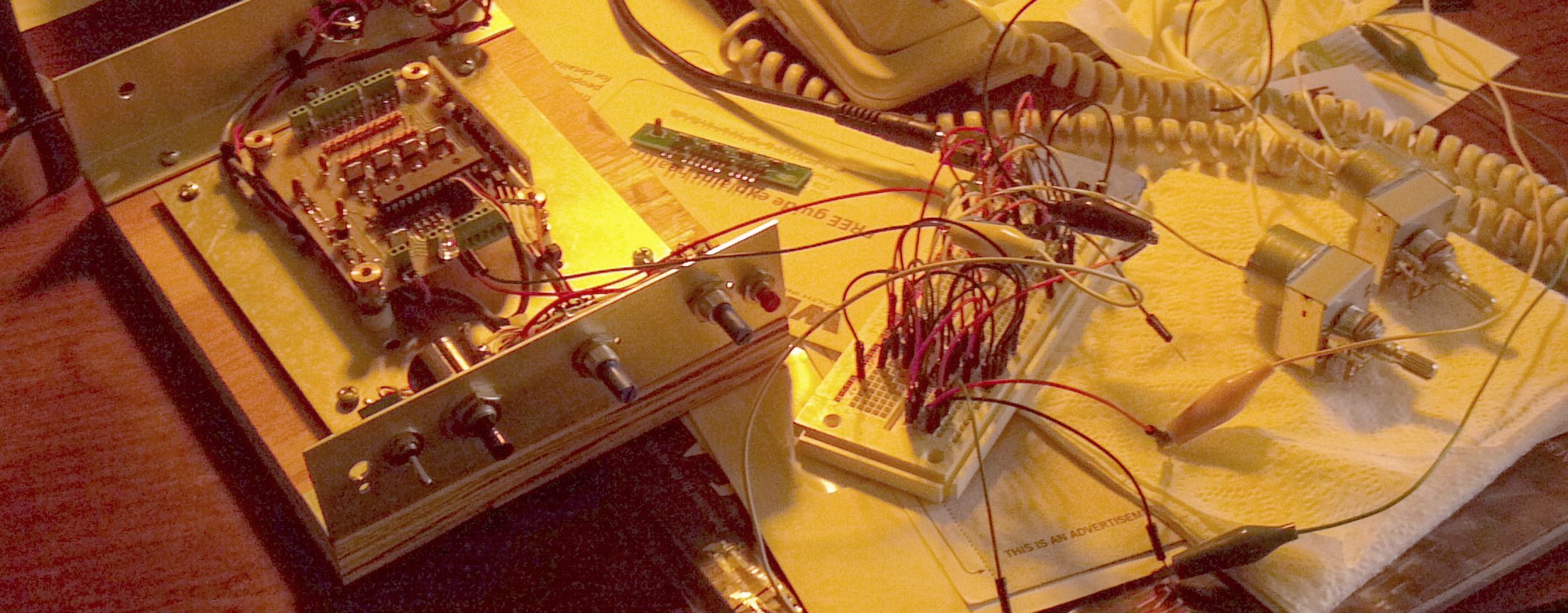

The final piece has come together. Have now breadboarded the IR receiver and it works perfectly. Since the breadboard wiring is per the PCB design I anticipate no problems from here out.
I was running the pot motors off the LDR board 5V regulator so, after subtracting the 1.4V lost in the H-bridge chip, the 4.5V motors were underpowered and didn't run very fast, but operated correctly.
I will now order some boards and see how the real thing works. The IR PCB has a 6V regulator dedicated to the motors so they'll run well in the final configuration.
l think I'll go pull the cork on a beverage and relax for a while. 😀

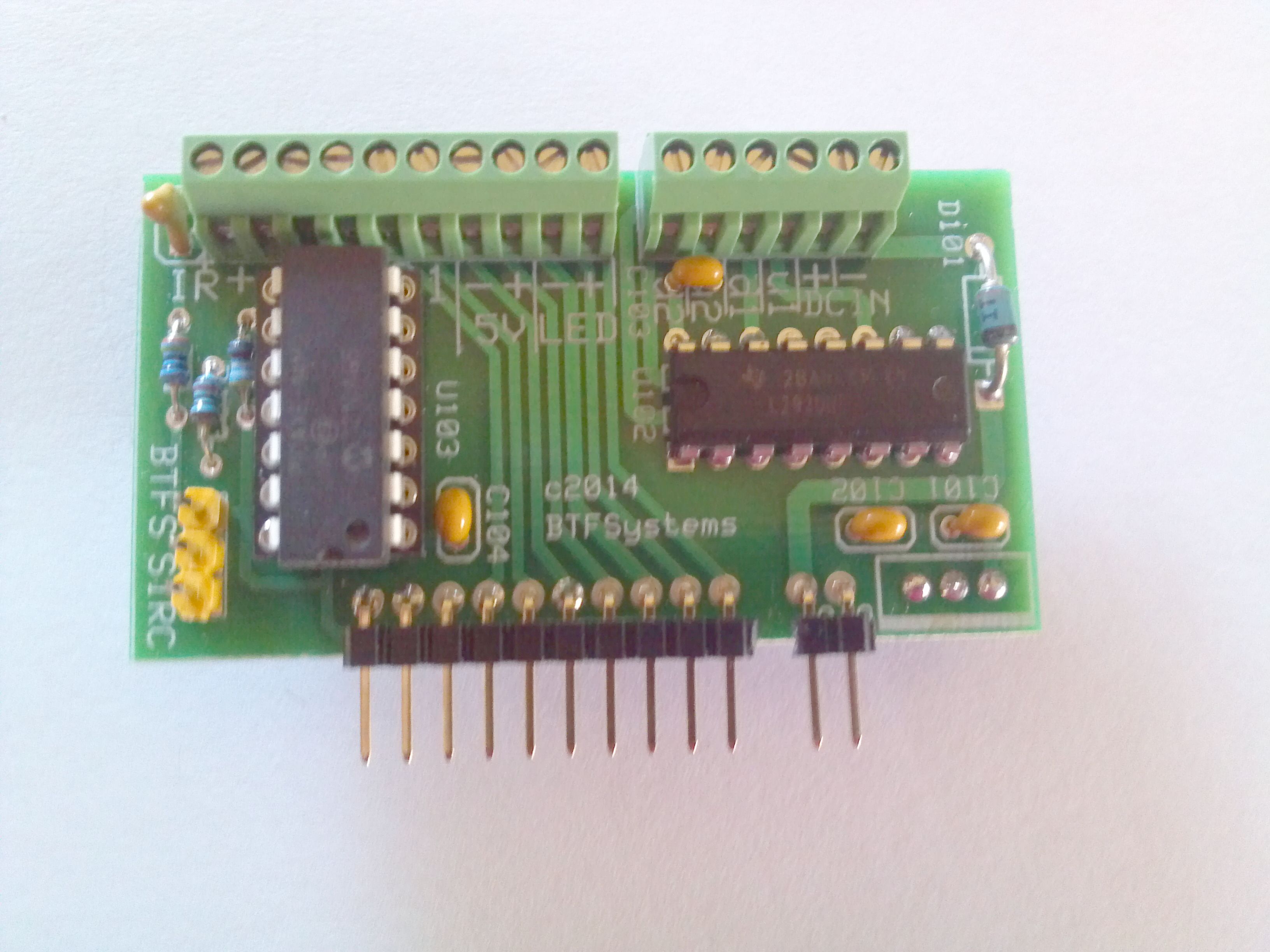

Here is the (un)finished IR board -- works a treat, but I've already decided on final-final changes.
I've already decided to convert the pins to screw terminals to match the front side. That way if someone wants to use it stand-alone to put IR in their own amp, the connections will be easy. Alternatively, if used in conjunction with the LDR board then all that's needed is a row of header pins inserted into each side to connect the screw terminals to the screw terminals on the main board to make a rigid connection.
Also changing back to 2.5 inches wide to allow space for standoff holes on each side of the board to allow separated installation or standalone use.
Also moving the "DC IN" off the IR board to the side of the main board and taking power from there for the regulator on this board. That will reduce one of the screw terminals on the front from six to four connections and eliminate the diode which duplicates a diode on the main board.
I'm making the main board 2.5 inches instead of 2.3 inches. First, I don't see the benefit of squeezing those last .2 inches and, second, it will match the size of the IR board. And I suppose, third, down the line if I want to add something I hopefully won't have to change the size of the board so it will continue to match the IR board.

Very neatly done - can still mount on it's side if short of room if terminals used - useful option - suggest you keep the diode as extra protection, maybe stand it up vertical.
Any possibility of small SMD diode(s) to indicate when the motors are activated (and hopefully the volume changes!) - a sort of 'function check' indicator?
Can use those plastic standoffs or even the self adhesive ones - they work really well if the surfaces are clean and seem to stay glued okay for years - can make/cut some round/rectangular supports from that automotive double sided flexible/cushion tape for vehicle bumper strips/ornaments/etc - 'sticks like mad' and useful anti-vibration.

James, your post is timely, I'm wondering how to go forward from here and how to beta test is on my mind.
But first regarding the SMD diodes, there is no room, I struggled to make it all fit as it is. The problem is the crosshatch of traces across most of the middle of the board. I tried to find alternative placement of the components, but nothing else seems to work. Also, I like to keep my traces pretty big -- a result of having ruined lots of traces with a soldering iron in my earlier days. Off the board you could parallel the motor leads and have different colors for different directions. The voltage will be about 4.5V with different polarity depending on which direction the motor is running.
The power diode is no longer necessary because in my next "final" version the IR board takes power from the downstream side of the input diode of the LDR board.
