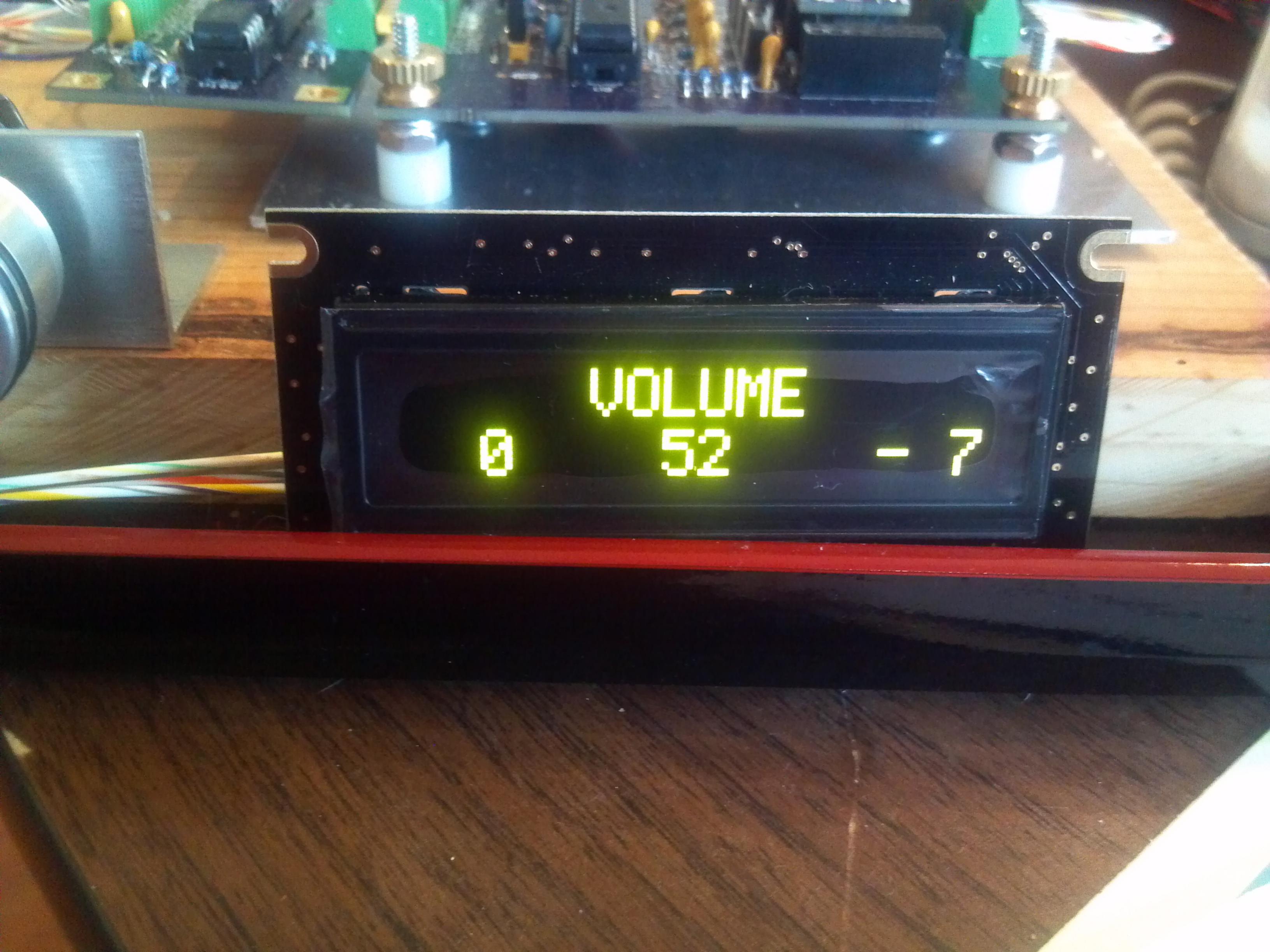

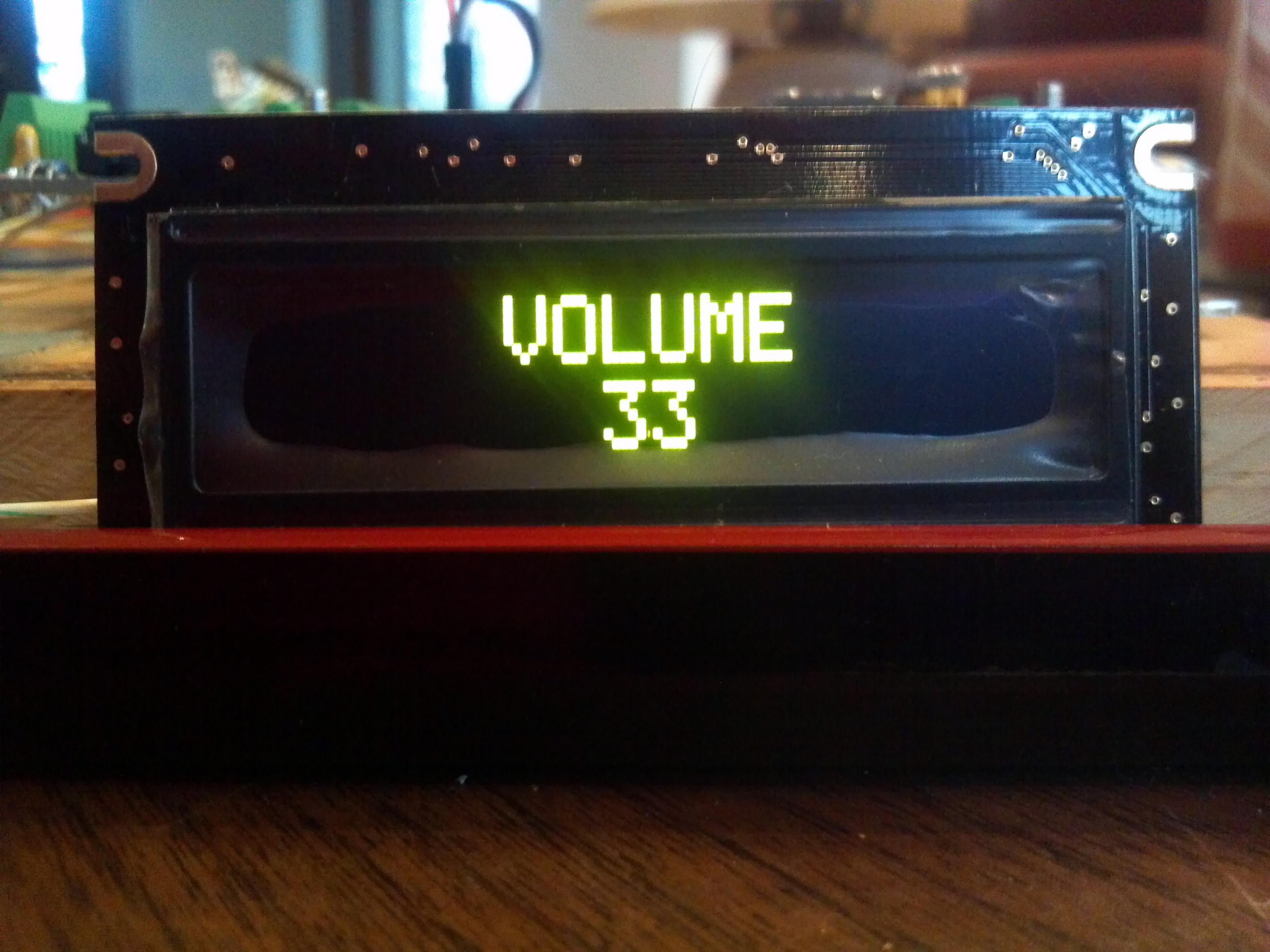

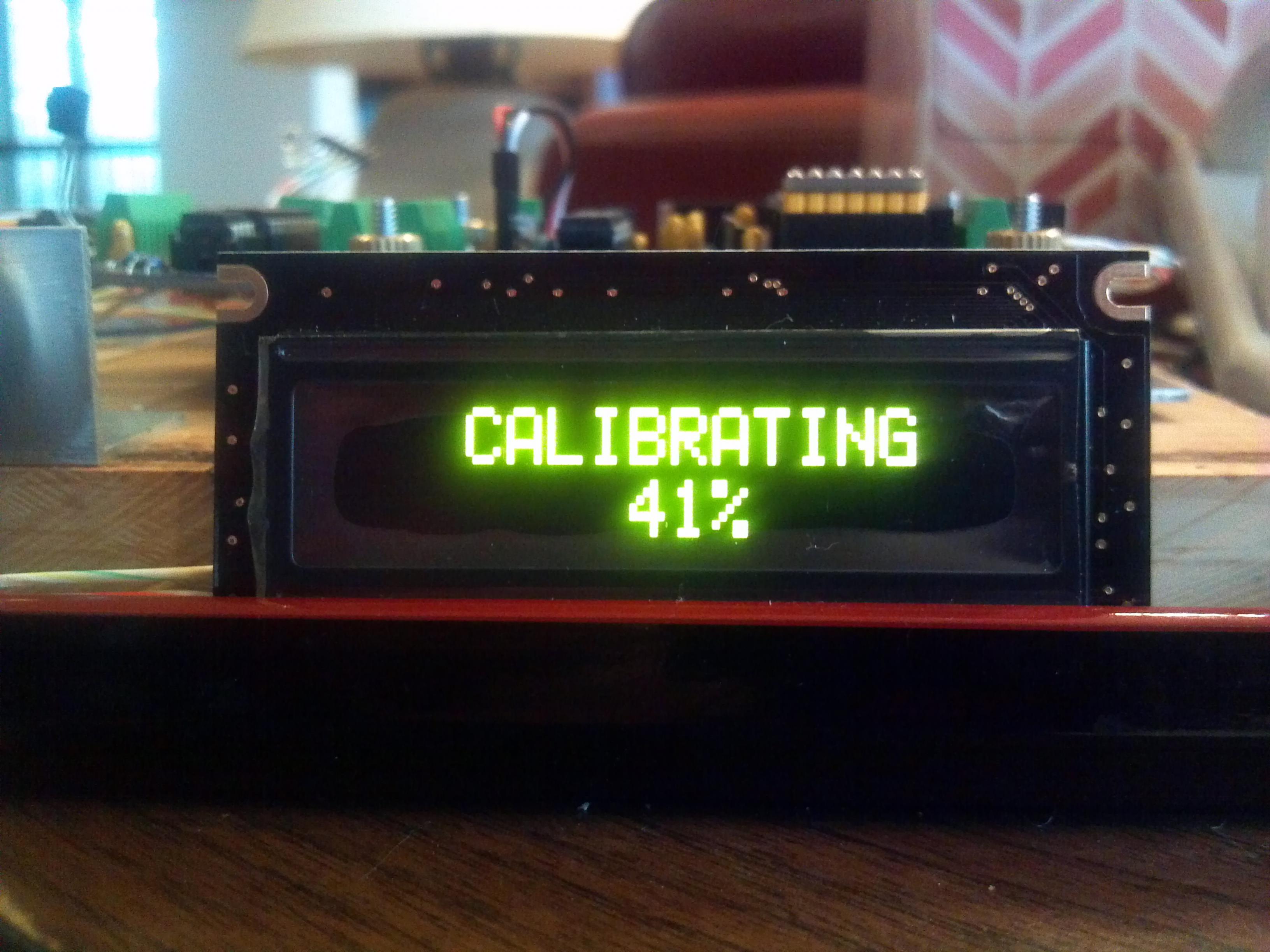

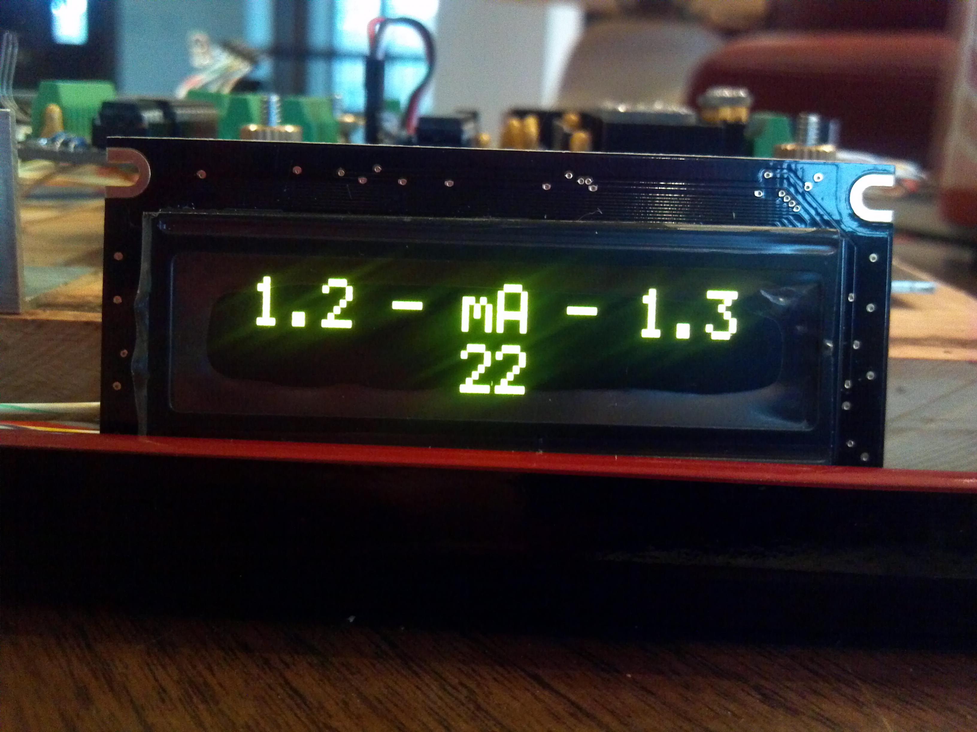

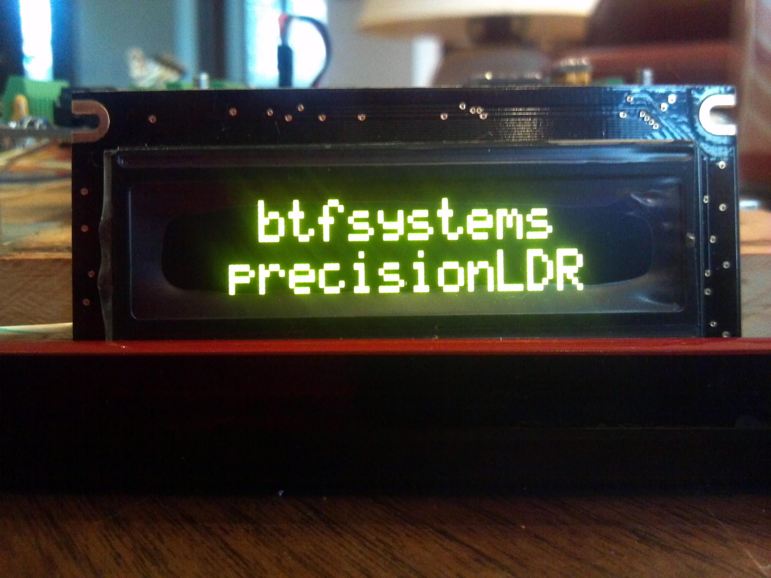

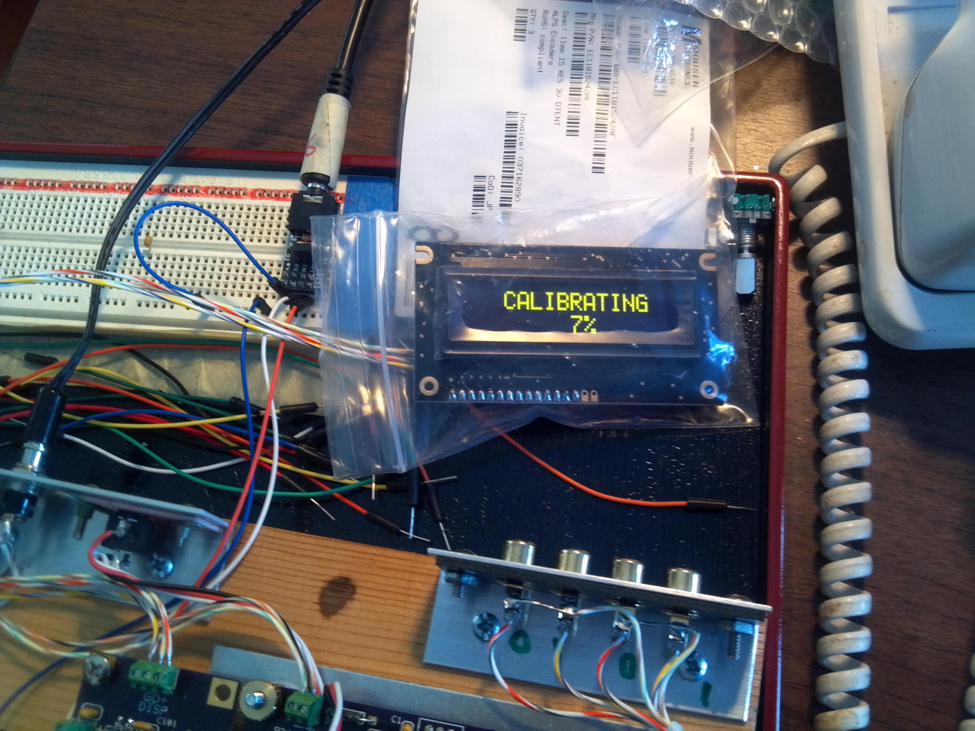

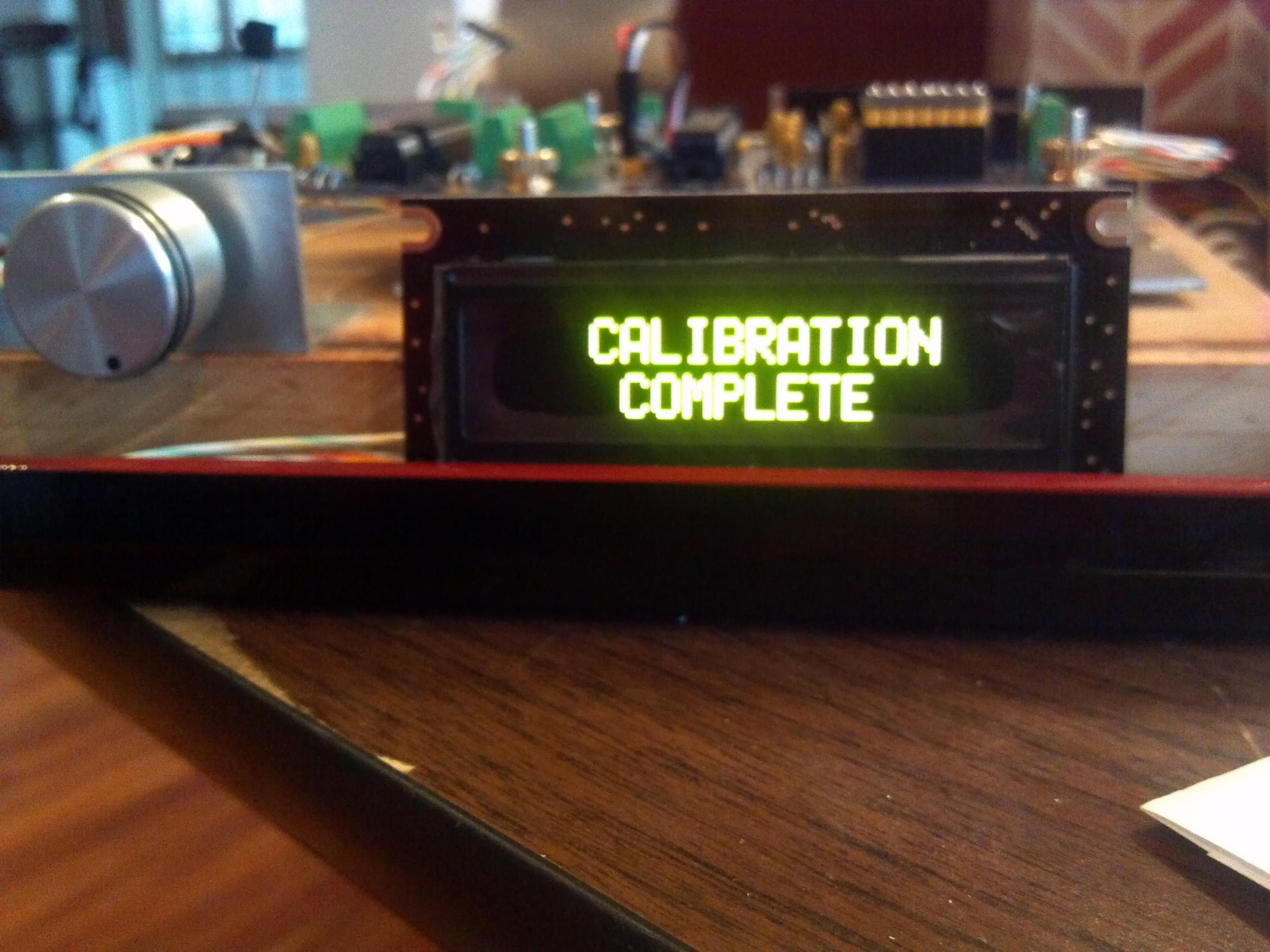

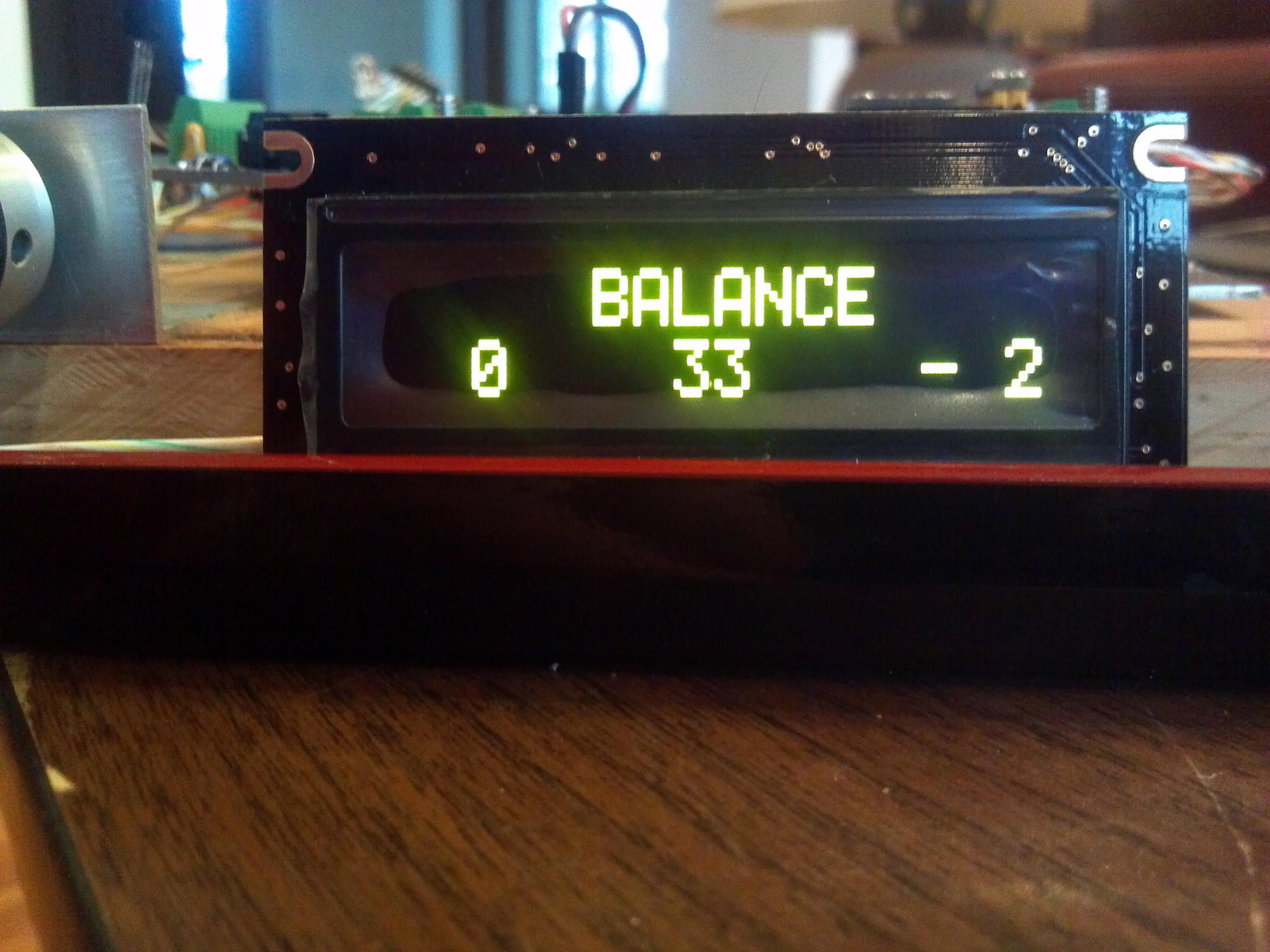

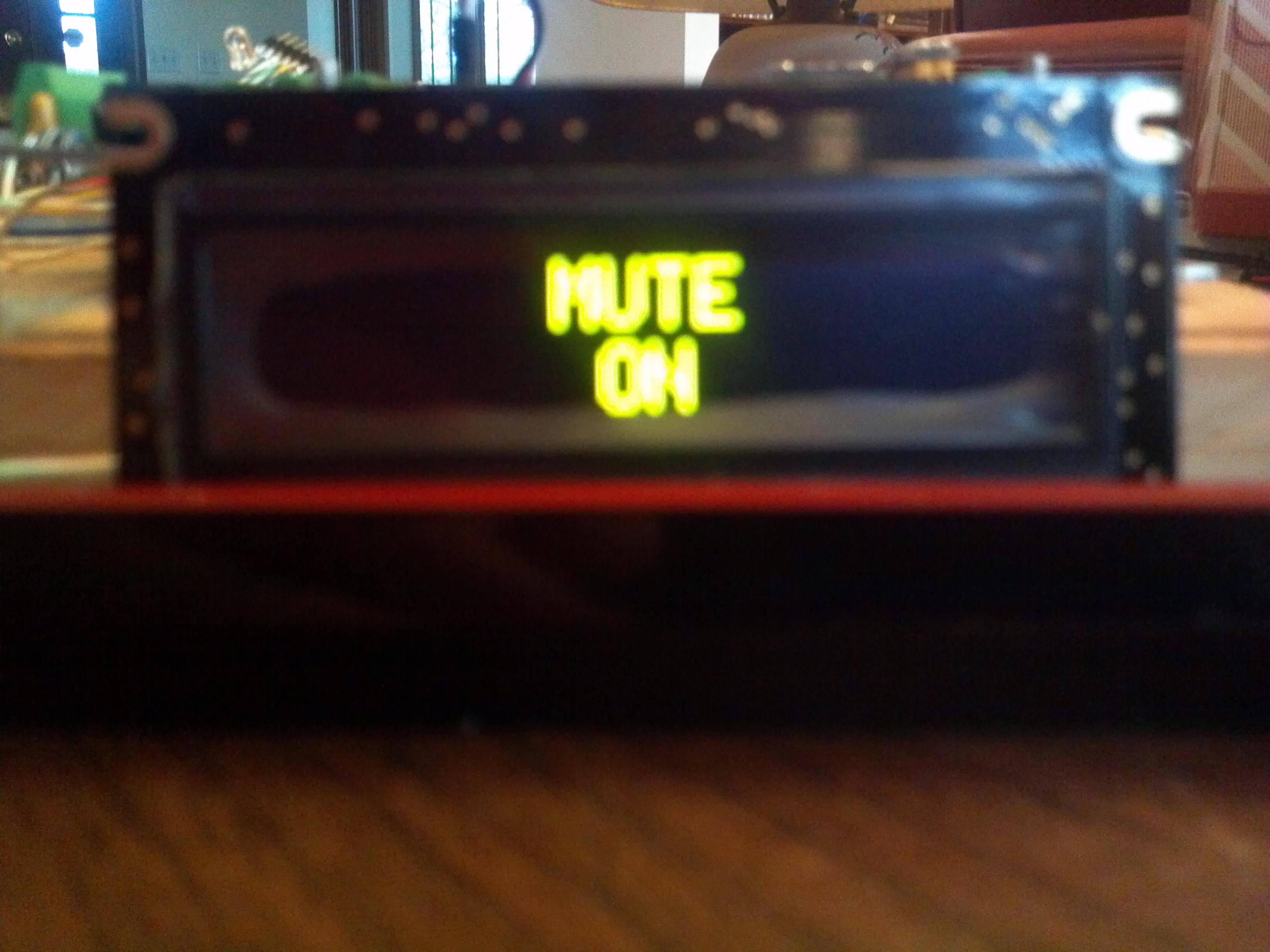

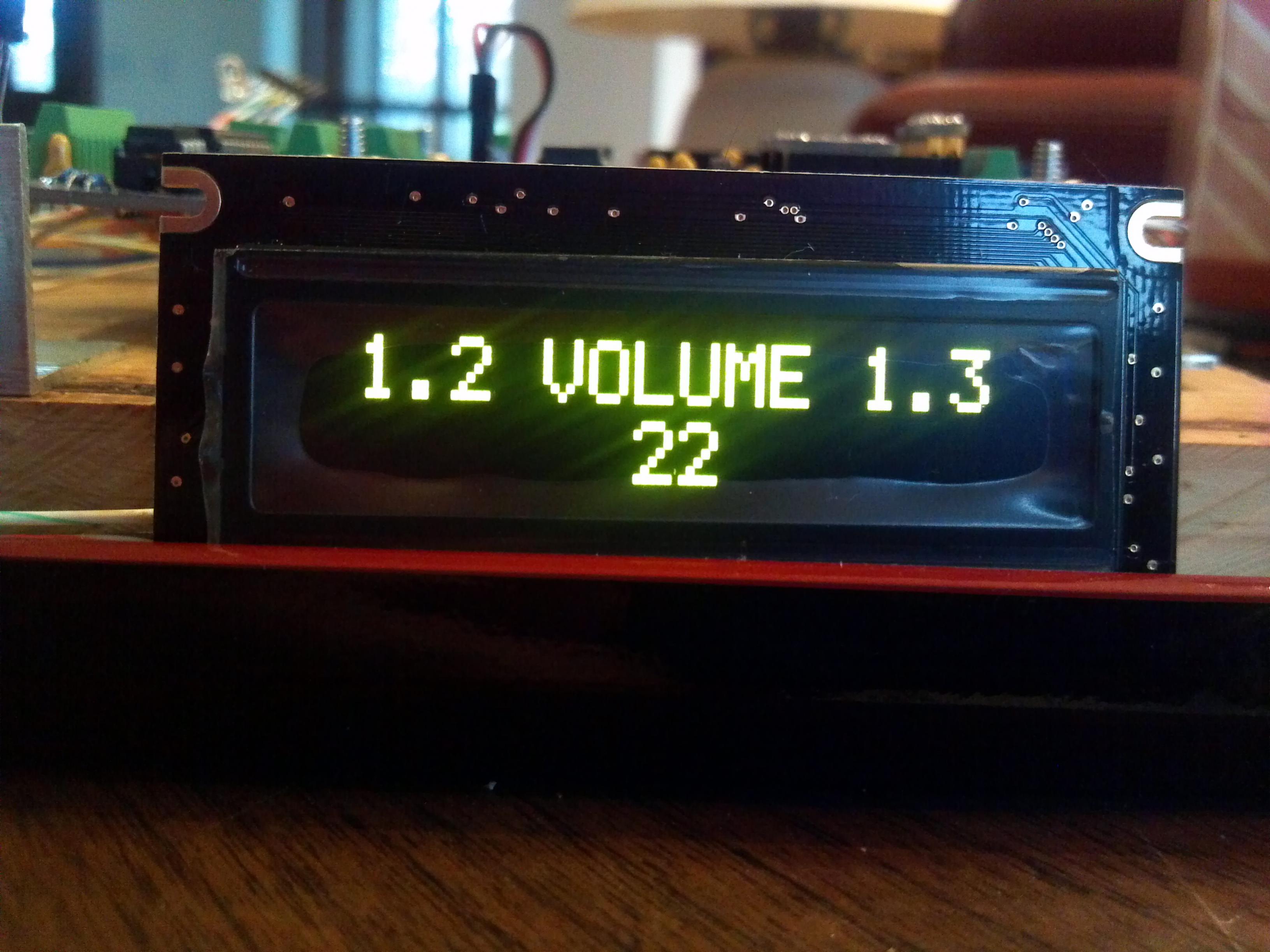

I think I've arrived, the job is done and the software is worked out.
Here are images of the main screens:
1. Startup screen
2. Calibration screen tracks Calibration progress to 100%
3. Calibration completed (flashing)
4. Basic Volume Control screen (adjust Volume Level)
5. Main milliamp display (includes 2 digit volume) (adjust Volume, watch milliamps)
6. Volume Screen with milliamp display (same as 5)
7. Mute On screen (flashing) Remains flashing as long as Mute is ON
8. Balance Screen (adjust Balance <-->)
9. Volume with Balance (on when balance is not centered) to keep you aware that balance is not centered.
Not shown is the 'screen saver' which is the two-digit volume value moving randomly from position-to-position on an otherwise blank screen.
Onward and upward . . .

1. Startup screen
Hello Wapo,
nice to see finalization of the system.
If you don't mind me asking, a small question :
when you display the current through the Led's it is not clear to me if it is for shunt or series LDR and both channels. I suppose it will be indicated in the user manual.
On the last sentence I understand that the volume level wanders over the screen if I have understood this correctly.
Personally I would prefer a static indication when I'm lissen to music (other persons may enjoy this though)
Best regards,
Edwin
Best regards,
Edwin
