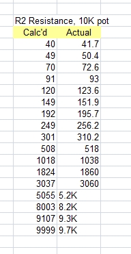

Have done some tweaking of the control code, here are latest results from my test board which I have programmed to be a 10K pot. I don't know how these numbers would translate in dB error, but I think the channels will track very nicely. I'm particularly happy because these numbers show not only 'relative' accuracy in a curve, but also an absolute accuracy to the specific curve I was intending. Just shows the system works well.

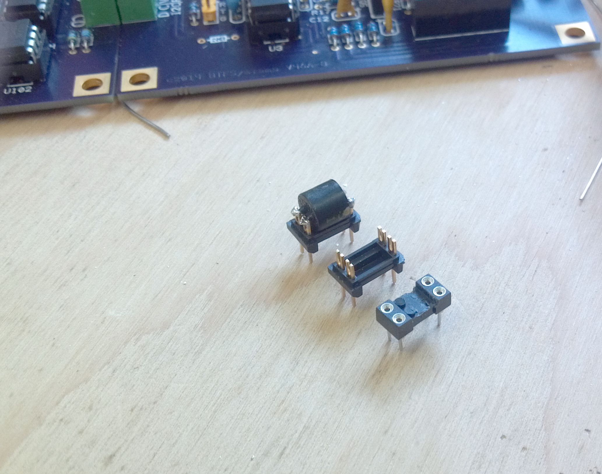

Here is what I believe is the final solution of the problem of how to mount the LDRs on the board -- very similar to George's 8-pin DIP, but individually on a 4-pin DIP header.
It uses the least space while keeping the LDRs user-replaceable without soldering -- which I view as essential -- and the legs of the header are very firmly held in the DIP socket.
Total height above the board is just at one-half inch, exactly the same as my earlier design. This works so well it could become the new standard.

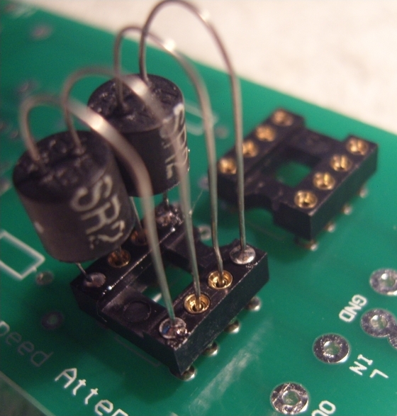

It is imperative to use heat sinks on the leads if you are going to solder with the leads this short. As you will cause heat damage to the led or ldr.
When using an 8 pin DIL socket the leg length is left as it is from the factory, and you have to be a very fast solderer as not to damage the led/ldr this way.
Cheers George
Cheers George
I went back and looked at the spec sheet -- it specifies 260 degrees max at 2mm from the case for 5 seconds. It's not as bad as you suggest, but it's not as good as I need to use my solution, either. Back to the drawing board.

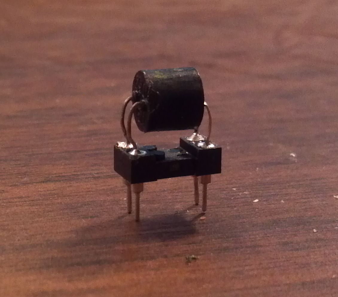

Here is one solution for the LDR mounting problem -- it does meet the published requirement -- 2mm distance from body of LDR to solder point.
This is surprisingly sturdy -- much more so than it looks.
I'll probably go with the 8-pin DIP rather than the 4-pin to ensure the correct LDR is used in the correct position -- the shunt must do 40 ohms at 10ma, the series doesn't need to come even close to that.
