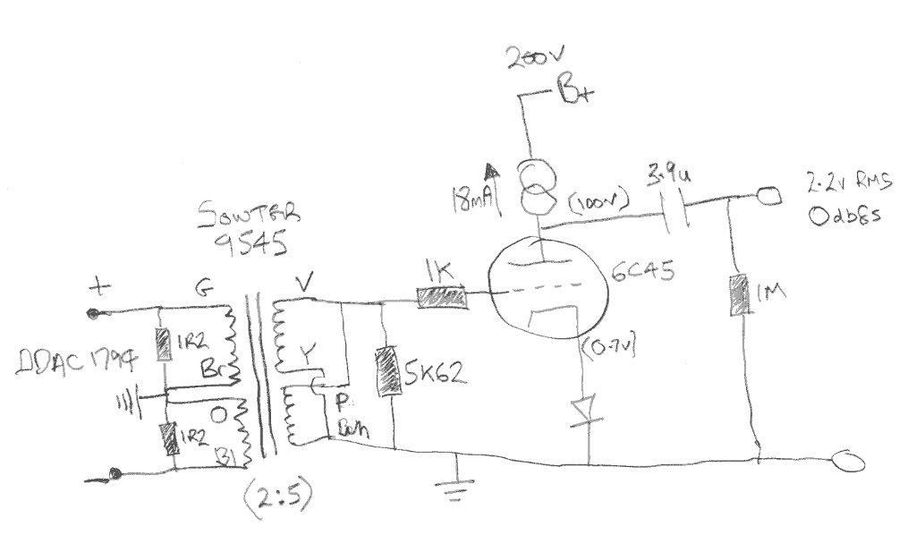

After reading kevinkr's Tube And Transformer I/V Converter For Differential Current DAC thread, I remembered that I have a spare pair of Sowter 9545 I/V transformers.
Sticking with the 6C45 tube output stage that I had been using with a ~5R I/V resistor from the + out, a quick back of an envelope calculation and I soldered 4x 1R2 I/V resistors to the DDAC board. I have the secondaries of the 9545's in parallel, so ratio is 2:5. Output is ~2.2V RMS for 0dbfs signal.
Not had a scope anywhere near it yet, but it sure does sound good! 😉

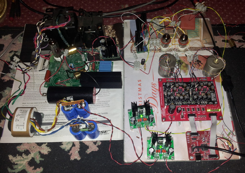

clivem ... is the big black cylinder situated next to the big black box a cap? The function of the black box is ... ? Thanks. Project looks good.
I think you must mean the 100uF/400V Obbligato PSU capacitor. It's a film PS cap. No "nasty" electrolytic caps used here! 😉
The black box.... Not 100% sure what you mean. Directly behind that cap is the HT regulator for the tube output stage. It has a fairly large black heatsink strapped to the cascode transistor. Right at the back/left of the picture, there is a Hammond 370DAX PS transformer (260V-0-260V & 0-6.3V), and next to that is a Hammond 193C choke (20H / 100mA). HT is rectified by the EZ81 tube, and followed with 1uF / 20H / 100uF Pi filter before the regulator.

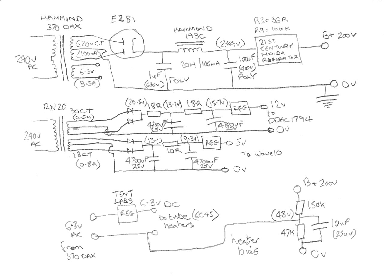

I have attached my power supply schematic, which might make more sense of the picture of a pile of parts and wires. (Apologies for the hand-drawn low quality).
The "black-box" regs used for the 12V and 5V digital sections are these pre-built VERY LOW NOISE <40μV Adjustable Voltage Regulator Board, out 2.5 - 19.5VDC / 3A boards purchased from eBay, based on LT1764. PDF schematic: A-270.
The HT regulator for tube B+ is the Tom Christiansen 21st Century Maida Regulator. (R3=36R. R9=100K. All other components are as per his schematic.)
The reg for the 6C45 tube heater supplies is a Tent Labs Tube Heater Supply, biased up to ~50V from the B+.
