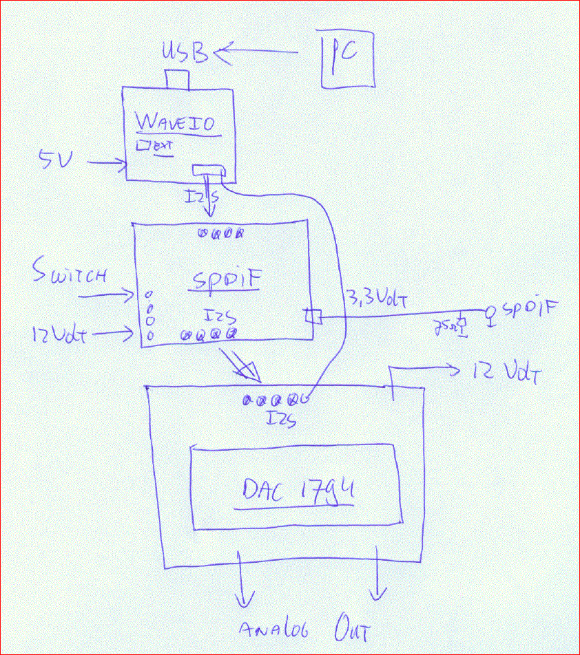

Looking forward to having a go at my first DAC build project but with my limited electronics knowledge I might need some advice on the switching for USB/SPDIF inputs. Any thoughts to get me started?
Actually the spdif board allows for this. it has an auxililary i2s input which can be selected. it is all the board and in the kit.... better download the schematics from the dddac1543. there you can see how it works. you can also send pm of course
and here is a small sketch / drawing how to connect it as the spdif board has relays on board to switch between I2S from the spdif decoder or the aux I2S input

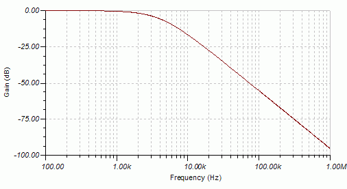

Thanks for this Input. I will check (measure) later on my own DAC if it is the same here. The filter which Comes after the Regulator (LC) filters -70dB at 200 kHz, probably hence it is not noticed on the analog side of things. But as said, let me check this. Better to have no oscillations left over on the Regulator of course. Will do some tests and chime in later today
