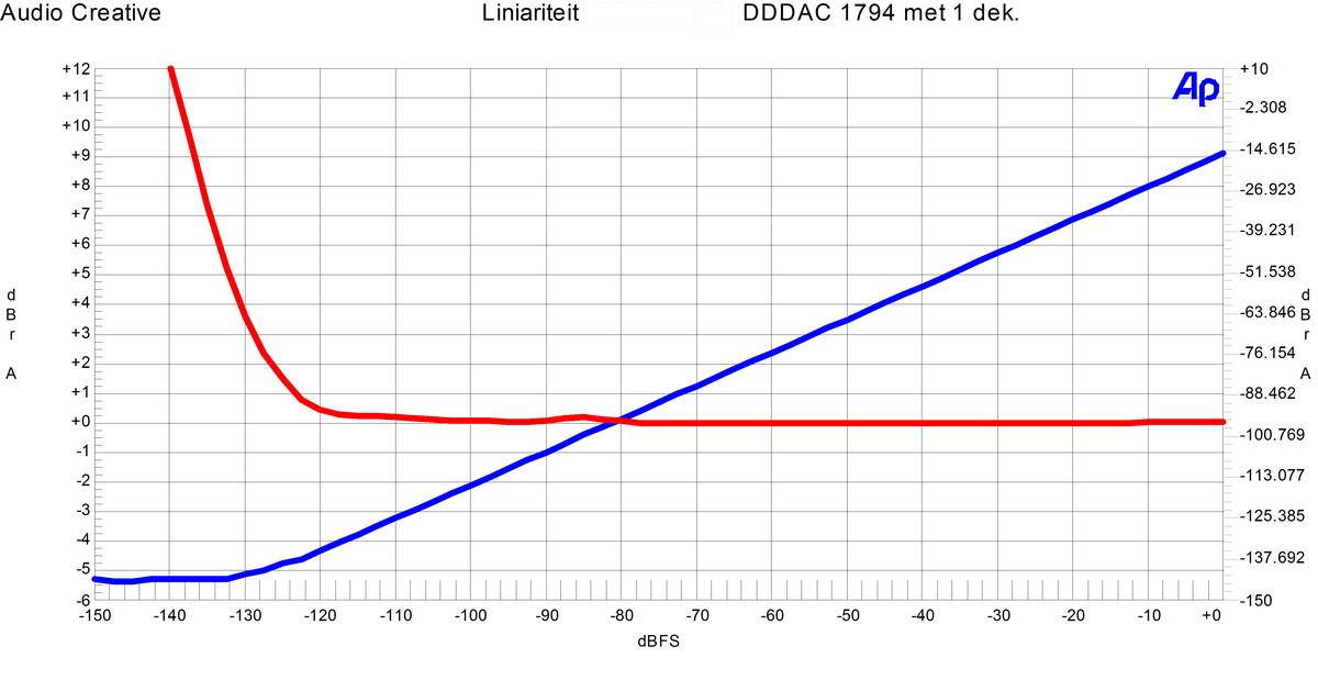

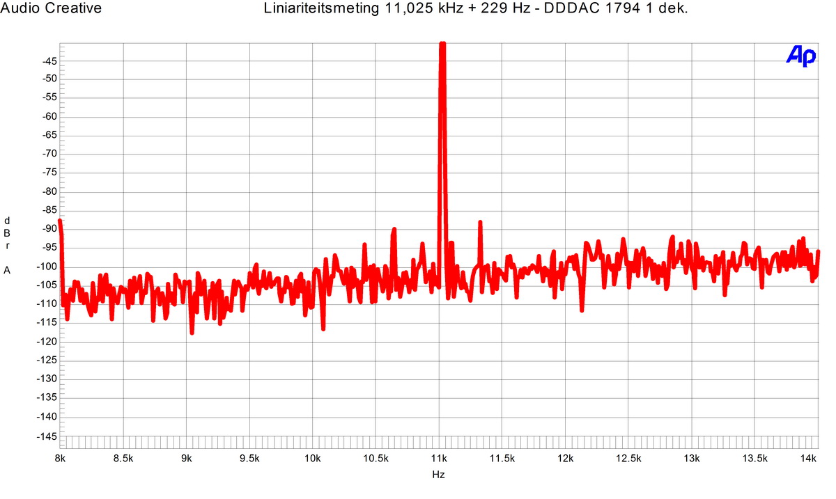

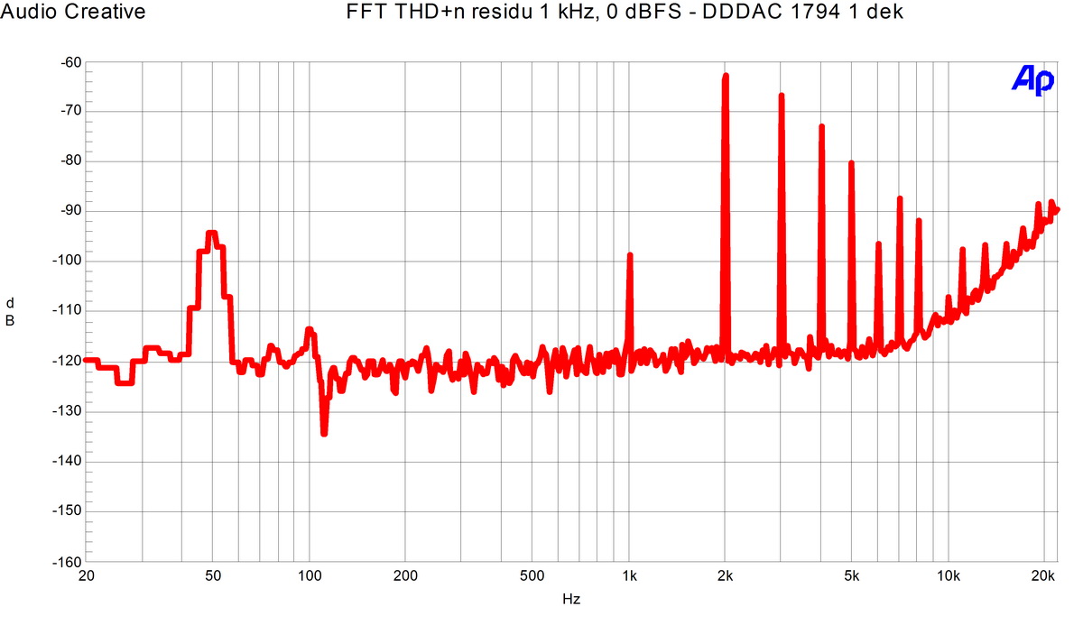

Here are some preliminary test Images done by Triodedick on a one deck DAC connected with a spdif Receiver
Results speak for themself. Very linear, tube like distortion on the analog side and very low jitter
