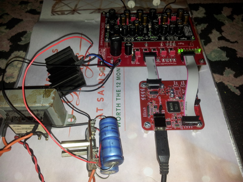

My kit arrived today. Built and running. I'm intending to put together Salas shunts for both 12V and 5V for the WaveIO, but for the moment WaveIO is powered from USB bus and a quick dig through my junk box earlier turned up a transformer and 12V linear regulator mounted to a heatsink, so that is pressed into temporary service for now.
I am pleasantly surprised. I have only spent a couple of hours listening, but I'm pleasantly surprised!
Nice clivem. Interested to see how far you can tweak your kit.
I'm using a 12V 'audiophile' linear power supply to power the mainboard/dac and the standard usb power for the usb board.
Waiting for Doede to release the power supply kit.
I have mine connected into my Silvaweld valve preamp. Probably my favorite sounding digital combo I have owned.
Enjoy!

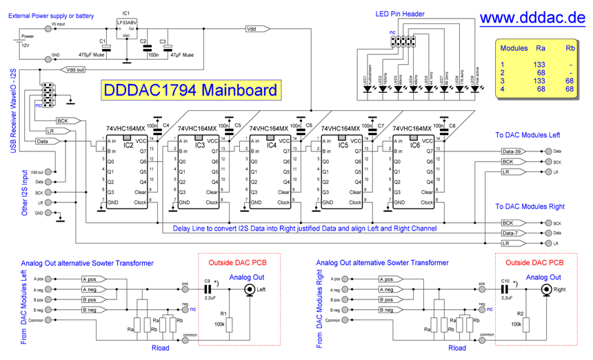

But I did remember reading this from Doede's site. Does it change anything to what you have suggested?
Mainboard
The 10 position pin headers are used for easy connection with the WaveIO Board. Please note this is a proprietary design, so not according to any standard. The LED signal section is on the main board, but is completely isolated from the other electronics. The WaveIO board is driving the LEDs with 8mA current sources. So any LED can be used, color and light intensity are not relevant. There are LEDs for the sample frequency (Fs = 44.1, 48, 88, 96, 176 and 192 kHz), Host active and Audio stream. Very helpful indications!
Thanks. I will try it.
In that case the isolation that I mentioned before isn't an issue, so please ignore that.
I have read somewhere a while ago that some LEDs can be more noisy (in terms of radiated EMI) than others, might be worth looking into that still, once everything else is optimised.
