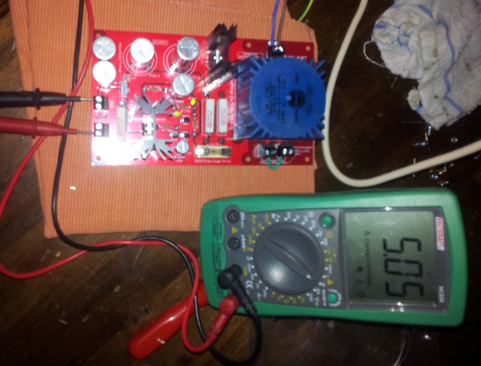

First things first. The psu was the first thing I tackled. And before I went on to the other boards first a quick check. Yes! It all worked first time.=

Did you also order the psu for the WaveIO. That really improves things. Or at least power it seperately with your own psu.
The package came yesterday and hope to start assembling soon.
Good luck.
I just ordered the 12v psu as well. Because yesterday I changed the 12v psu from the rakk dac mk 1 psu to the rakk dac mk 2 deluxe psu. The mk1 only supplied something like 170mA and has minimal filtering (Something Dave Davenport later fixed in his mk2) since more filtering gave the sound more body. Anyway to make a long story short. The improvement from mk1 psu to mk2 psu was nothing short of stunning. Suddenly I had George Benson in my room 😉.
So now I want to try Doede's psu. And return the mk2 psu to its rightful owner the RAKK DAC MK 2. So I can use that in my other system.

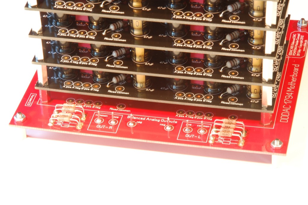

Balanced Output Options
Hi All,
after following this thread I've taken the decision to order a kit. It is on its way and initilaly I will build it as is with the single ended outputs. Can anyone recommend an add on board or circuit that would provide balanced outputs though please.
Regards

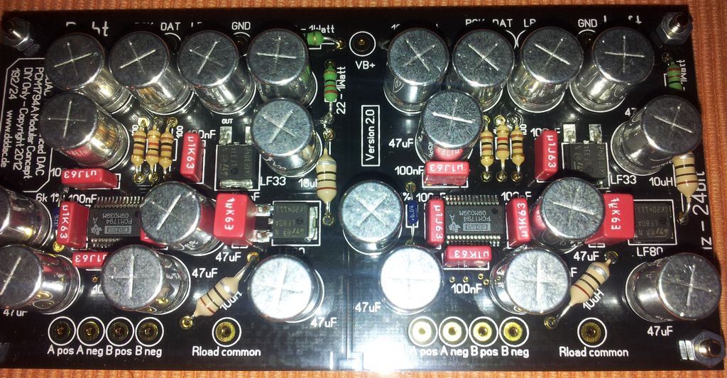

Hi Doede,
I have read your explenation on your site, and make mine decision to make one.
Words are words, but still there is something , I think your design is right.
Mine knowwlegde is not sufficient to design the delay in the I2S line.
So, I have order a waveIO board, and collecting / buy parts.
Still a few questions, I can't determine what is the L or R channel, i have read the
blue line in the delay circuit. and,
you use a output trafo, are you still use the A B iv resistors on that position, or
a ristor on the sec side?
I have good experiens with an outputtrafo.
