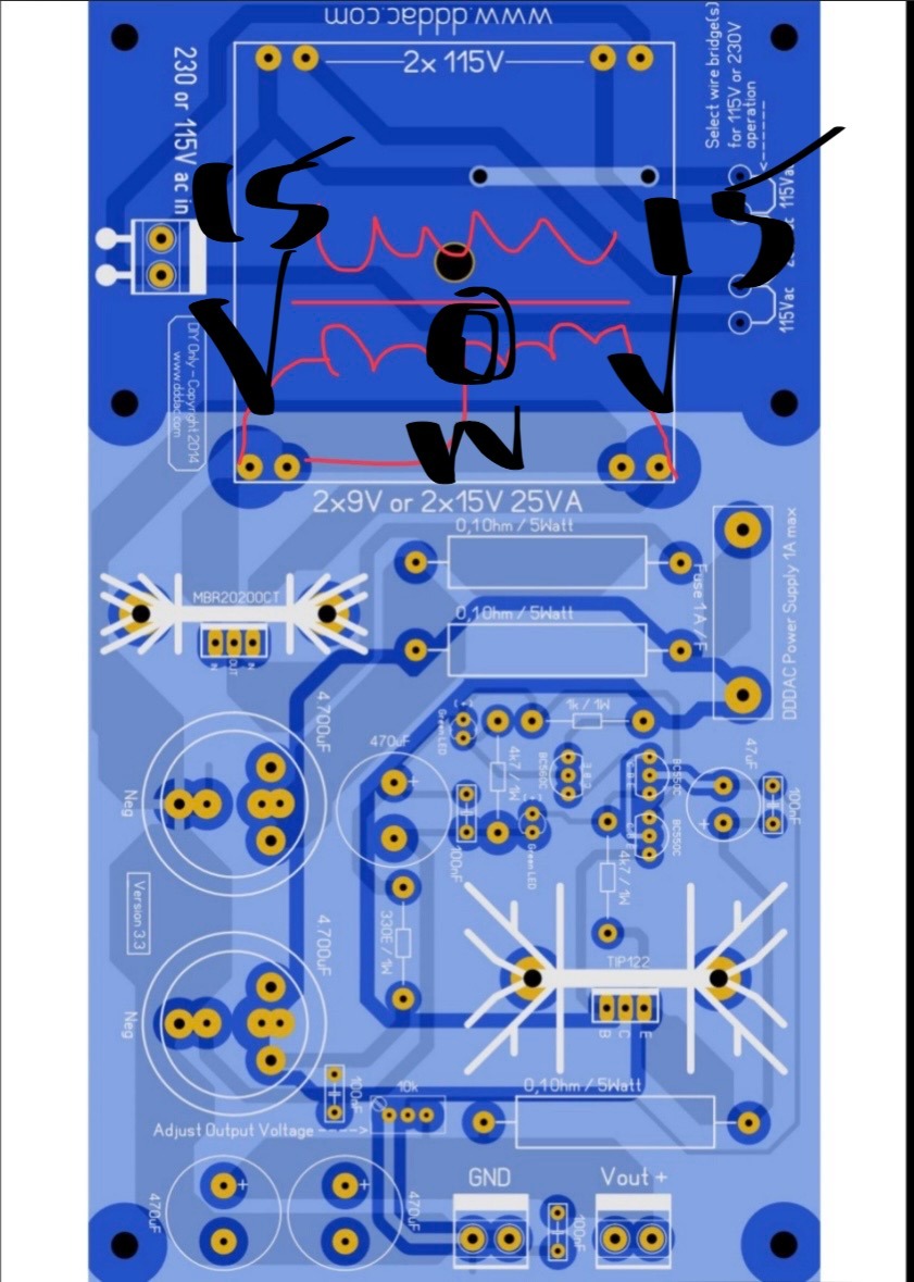

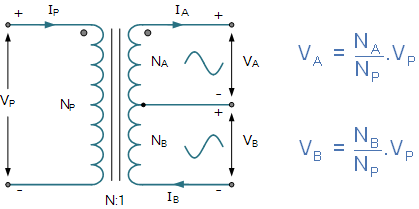

Dammit, I just see the posts in between and that the transformer has two separate windings. To create a center tap, it is more likely you need to connect one grey/white and one violet wire… best check is to do this and measure if you have 15 volt in between end 30 between the outer wires
I hadnt seen your message and went ahead as per your previous suggestion. I checked the voltage without connecting the supply to the dac first. All worked fine actually. I could use the trimmer to bring the voltage up to 12.5V and it has been 30minutes since i first powered it on and it has maintained the required voltage properly. Nothing overheating as well. Then i connected the psu to the dac and it played fine without any issues. Should i correct anything now? Do i need to shutdown the psu?
