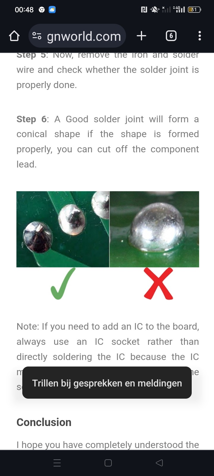

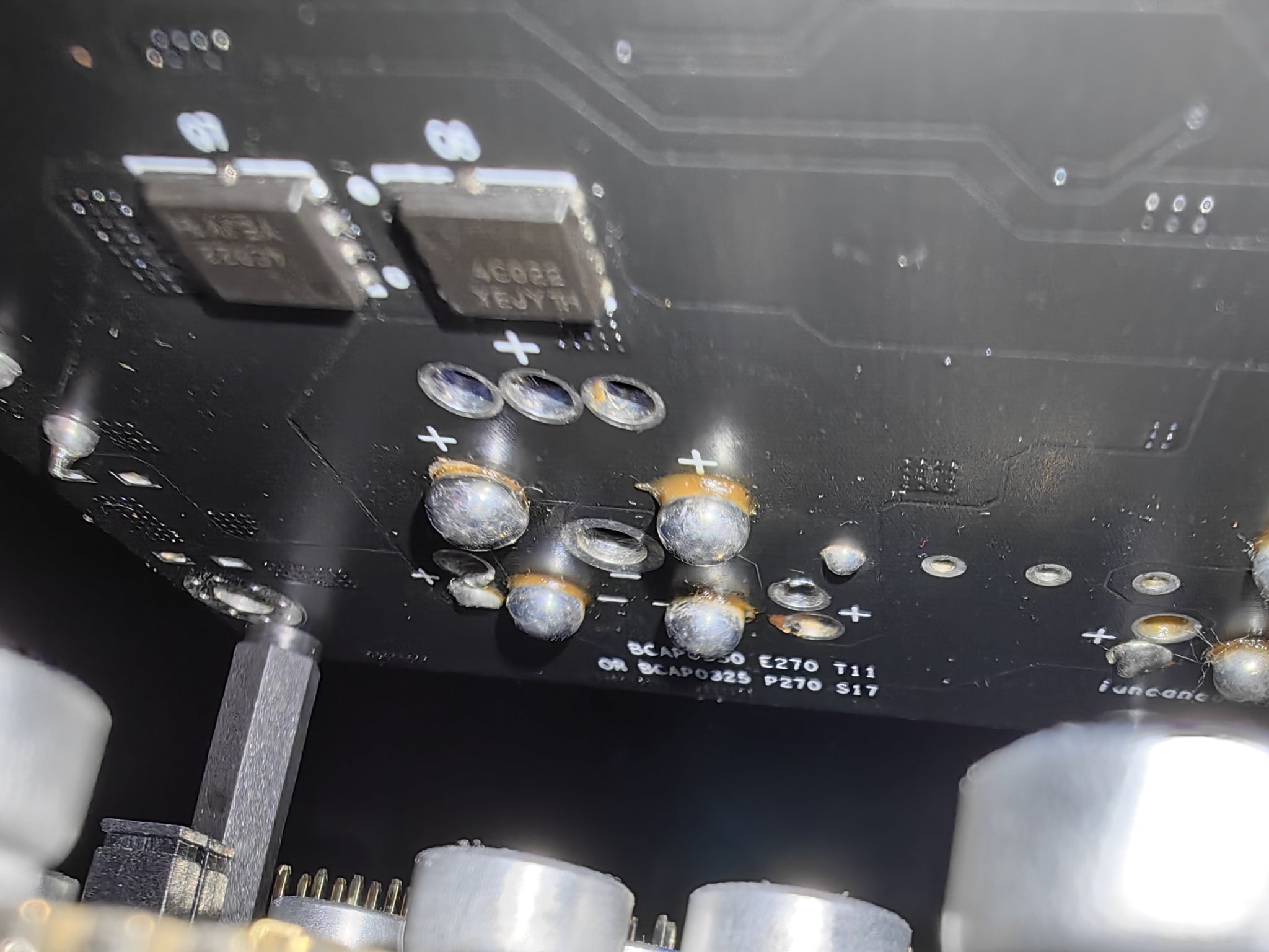

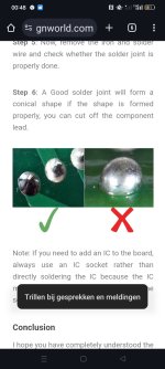

Everyone will still have his own favourite but that judgement could be based upon Roon being used as intended and another one completely wrong. AND would you trust a judgement by someone who solders his caps as being shown one day ago? He should have wondered what he just has done and then also selling it. Suppose you would buy a diy tube amp from this person?
It shows again that people are not willing to invest time in reading manuals or learn some basic skills or is it just not seeing the necessity of proper tools?

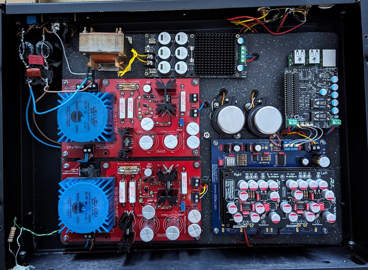

I wanted to add an external led on my the 12v psu for the DDDAC mainboard. Stupidly I did this with the power on. The fuse blew on the 12V board.
No sound out of the DDDAC anymore. Did the DDDAC die because of the short-circuit? Or just the regulators on the mainboard?
Replaced the fuse and the psu is up and running. But it looks like the DAC is not working...i.e. not drawing current...because the heatsinks remain cold.

Oopssss, not a good start in the new year Bas. Best is to measure if the 12 Volt is arriving at the top of the DAC board Stack? Than check if 10 volt is available? And thirdly, check if the 5 volt regulator (the LF50) is really giving out 5 Volt…. That should deduct if and where the error is. If all is fine, check if the 8 volt is present
Looks like the psu is kaput. 23v is what I'm measuring from on top of stack. That means everyting is kaput right?
Luckily I have still have 5 dddac boards.

That is indeed way too much, but Regulators should not die at 23 volt…. Puzzling… can you just supply the DAC with 12 volt from something else and measure again at t the points i suggested ? Also the 3.3 volt regulator on the DAC module(s)
but if the psu is outputting 23 volts, that would suggest a defect as well. Probably the TIP122 comes under suspicion. All the rest is less endangered … Easy repair and 1st check I would say

Good news! Replaced the 12V psu. I had an extra dddac psu 12 v to power a turntable. Ripped that out an put in the dac.
Works! Thanks for the help Doede!

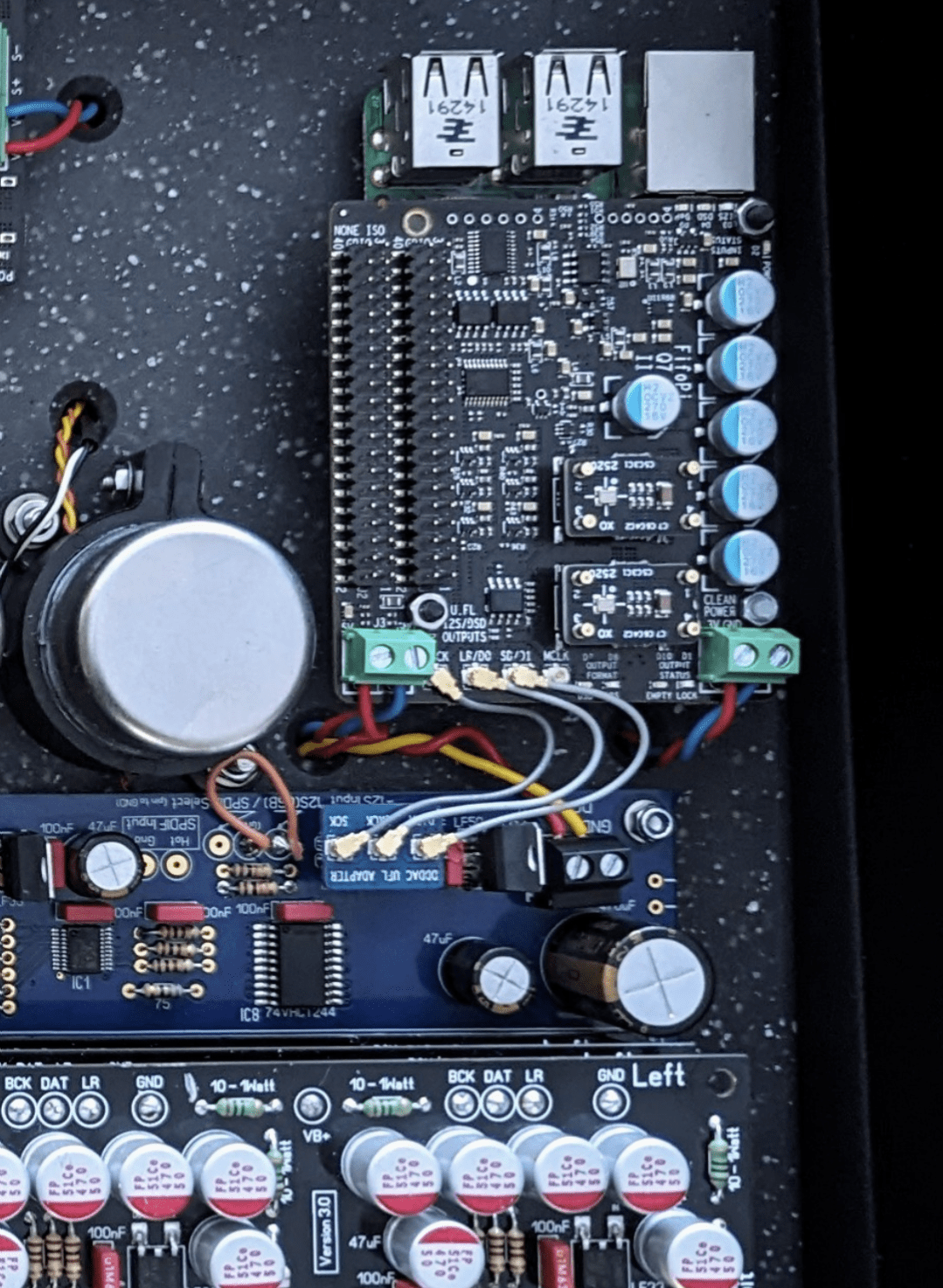

Just did a rebuild since I got the FifoPi7 mk2 instead of the hifiberry. Was so happy everyting was together..and one small mistake spoiled it.
but all is well that ends well.
Fixing the psu...probably the tip122 that's kaput?

Indeed. Very stupid.
Ps the transistor was faster than tbe fuse. It died first. Then the fuse went.
That power supply is simple, easy to fix. The fuse only protects the secondary of the transformer, nothing more.
