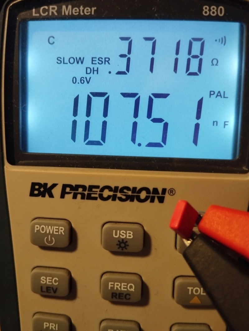

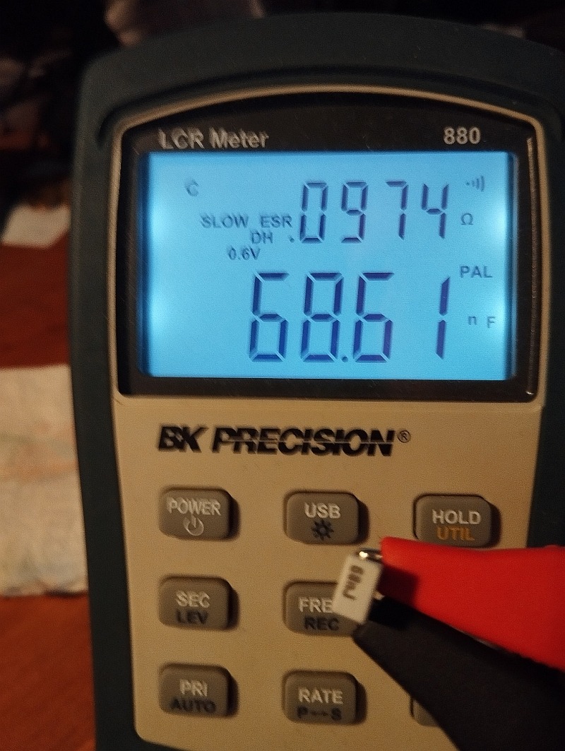

I remember a discussion in this tread about possibile benefits by replacing standard Wima 100nF bypass with Kemet 68nF (even if I not remember which positions should be replaced, I'm not able to find the original post).
Today I measured both capacitors ESR at 100KHz using an LRC meter and result is Wima ESR=0.370 ohms and Kemet ESR=0.098 ohms.
Sorry for my question, I'm a Newbye in electronic : is the lower ESR the main reason of reported overall benefits ?
Thank you.

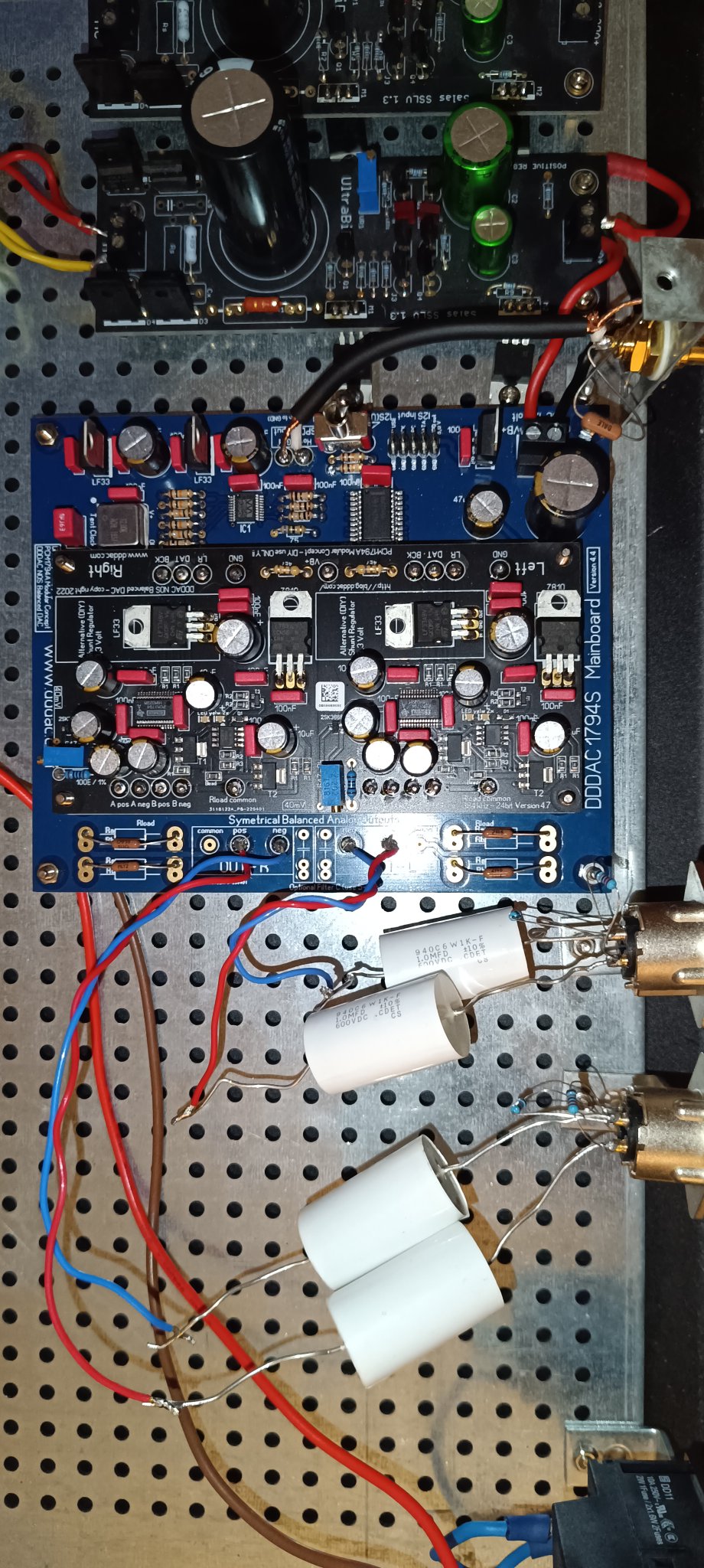

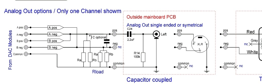

Finally I have my DDDAC up and running again🙂 there is one issue that arises with the balanced output. If I use balanced output without caps to my amp, all seems fine. Except I don't feel comfortable using it this way (dc still present).
So I add caps in series on pos and neg and connect pos and neg via XLR to amp. When I use caps, I have a weird noise upon amplifier shutdown that is not present in the capless situation. Any pointer as to what that could be? I tried parallel 150k resistors from caps to gnd pin of XLR, but that did not work.
Known PIN1 issue. When I had capacitors on the output (Jantzen Silver Z 4.7uF 2%), there was some small noise when switching off, this is probably unavoidable. There is no such thing with a transformer. As for Pin 1 ground, I tried tying it to both signal GND or chassis, I didn't notice any difference in use. The signal GND is connected to the chassis indirectly, using GREC+100nF+100ohm. By default, Pin1 connects the chassis of two balanced devices, DDDAC and Preamplifier/Amplifier. XLR cable shield is also connected to the chassis. If Ground Loop occurs, Pin1 and shield should be disconnected, but only on one side, it must be grounded somewhere.

This is still my "testbed" trying different things, LT3042 regulators, adding a second board, looking forward to that! Adding Iron Pre as buffer. I will reroute power lines as this indeed might influence results🙂
As for pin1, it is grounded at amp side.
I will try as suggested in documentation though:

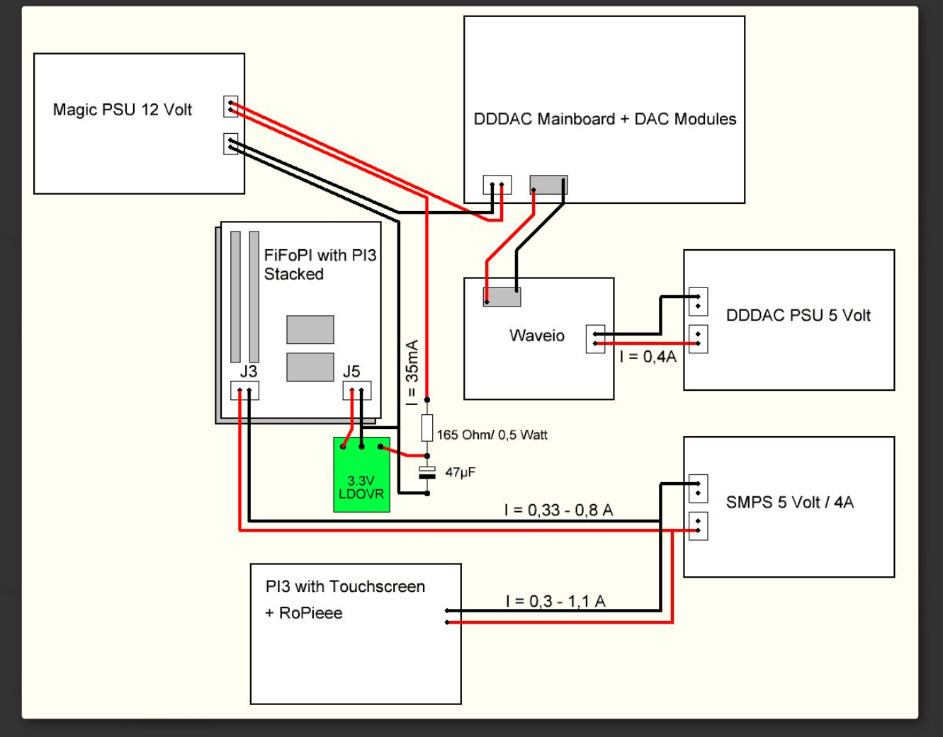

I would like to improve FifoPi J5 psu. Now, I found below drawing of Doede:
In my situation I want to feed FifoPi J3 with Ultrabib shunt at 5V and then add RC filter plus LT3045 regulator to J5 (3.3V).
For the RC filter I ordered 162R resistor and accidentally 4700uf capacitor instead of 47uf.
What would be the workable value for the C in the above mentioned RC filter?
Thanks!
Robin, please have a good look what I did with the RC filter. The 165 Ohm is reducing the input voltage to the LT3045 to reduce power dissipation. The value is totally depending on the voltage drop from the 12V PSU to 6 volts input. Reason being is, that the current drawn by the Fifopi clock side is also dependent on the type of XO clock, as well on which FS frequency the track is playing. The value of 165 was measured in this very particular case ! With Accusilicon by the way.
so in summary, I would use the 5 volt regulator followed by the LT3045 and not use a RC filter unless you can make it totally specific to your application
Reactions: Robin De Wolf
Oh yes, now I recall, I intended to use the ultrabib that feeds the DDDAC mainboard (12v) so then the RC would make sense, as I have Accusilicon so expect the same mA draw.
Thanks for the explanation though, as I aim to use 3.3v and not 6v😉
I will proceed without RC.
Thanks Doede!
