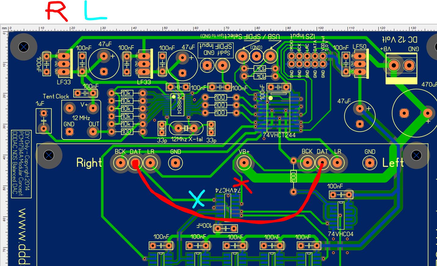

I am planning my DDDAC build for quite some time now.
Your above quote especially took my interest: I want to build full dual mono, AND by doing that I want to double the DAC decks per deck. So installing one deck means I already have two, for one channel offcourse.
However, I don't understand the quote by "rewiring the LR signal", as per schematics the LR signal is the only one that is shared for both Left and Right side DACs. I took the I2S wikipedia for details on understanding the digital signal (have some skill into understanding, not into I2S).
LR
Apparently the LR to DACboard can just be constant-low (to GND) for Left, and constant-high (to 5V) for Right, without R inbetween.

Attached is a picture of the circuit, with RED modifications for LEFT channel, BLACK (pen) modifications for RIGHT channel.

HI DCTRL,
Just wired the mainboard as indicated, that is enough, no need to tamper with BCK or anything else. Using 2x 150 Ohm is a clever idea for spdif and yes, just route through the power and I2S inputs signals.
in Summary to your question:
LR
*** NO ! that would not work - use the scheme as indicated and leave LR untouched!

Hey doede,
thanks! It is even simpler than I thought! Only the data lines have to be altered, and paralleling the outputs If I’m correct.
both L and R need data lines connected right?
greetings
greetings
Yes, both former L and R channels need data, one mono unit from Right data the other only with Left data. See my drawing.
outputs together, ready

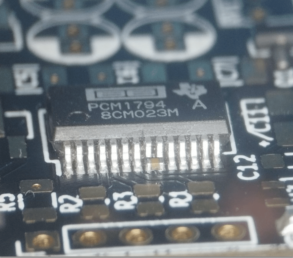

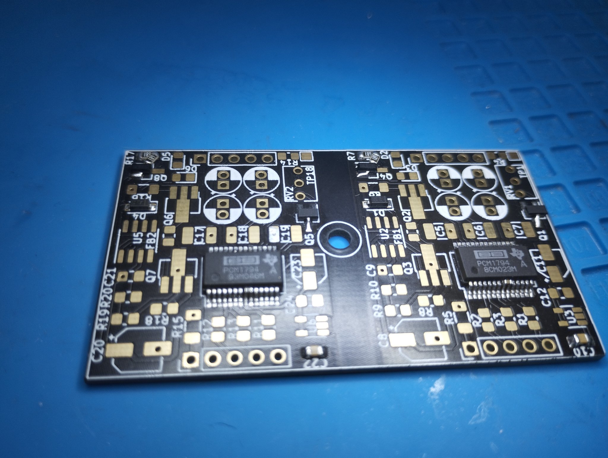

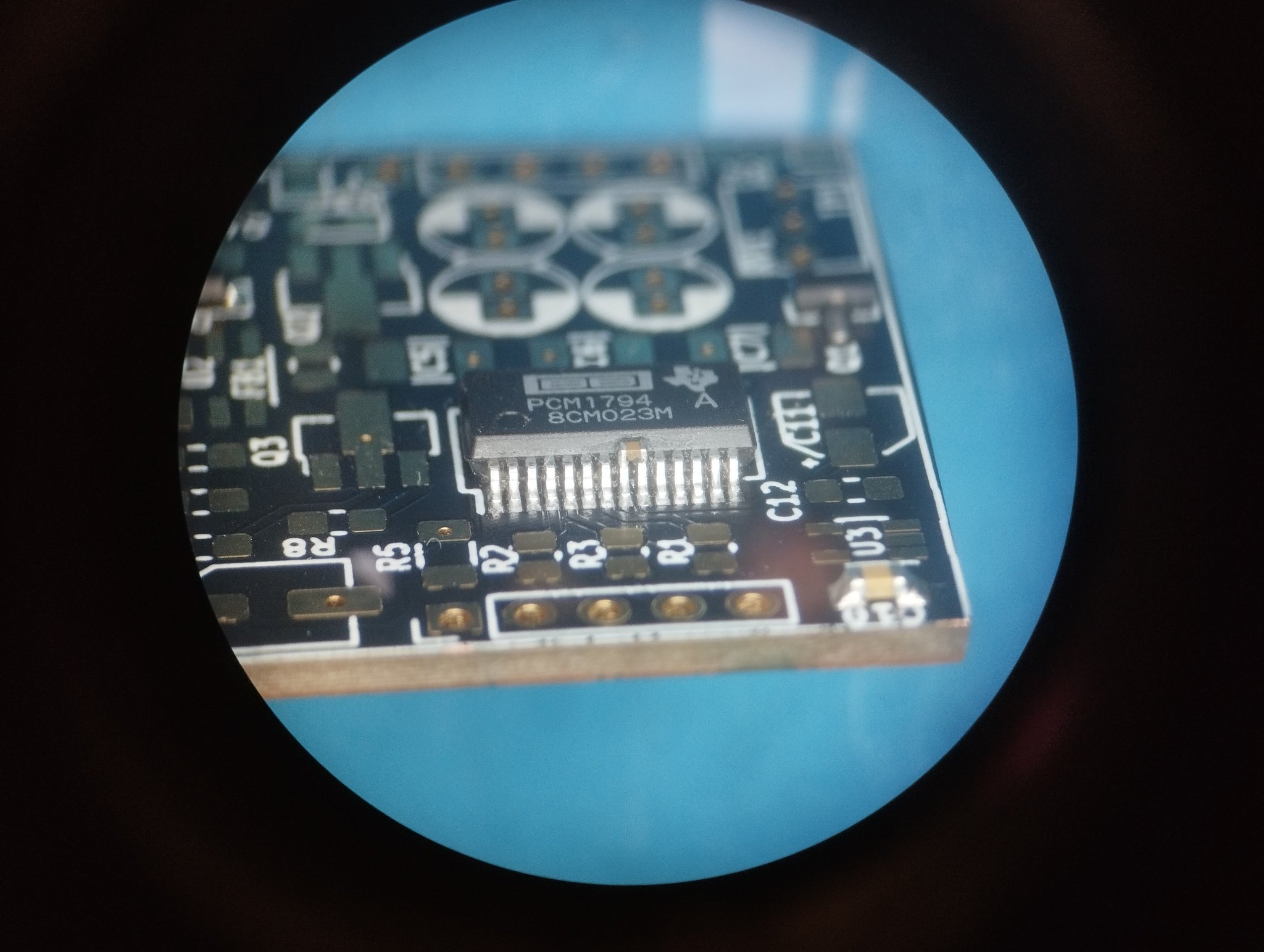

We were reorganizing our flat and I had my DDDAC stored upside down for a while after hooking it back up again last night. There was only a bit of noise and after looking around a bit saw, that the ground connector had slipped of from the I2S inputs. I connected it without switching the DAC off and instantly had music but only on the left channel. Could it be that the boards got damaged running without proper GND connection to the input signal?One thing I seem to remember about DDDAC is that the DAC boards will be damaged if powered up while there is no clock signal to the board.
I think the situation Bfpca described was not happening, as the main board has the Tent clock installed and the boards where still connected to the main board?
It is a 5 deck DDDAC, shunt version decks, current main board, fed from a Raspberry Pi with ReclockPi and FiFoPi into the I2S input.
I appreciate any help troubleshooting this. I checked all other connections and power supplies. That all checks out.
I borrowed a streamer with S/PDIF out. Using the S/PDIF input on the DDDAC I have output from both channels, so the DAC is fine and the problem is elsewhere.
Or is it still possible that the I2S of the mainboard is damaged?
