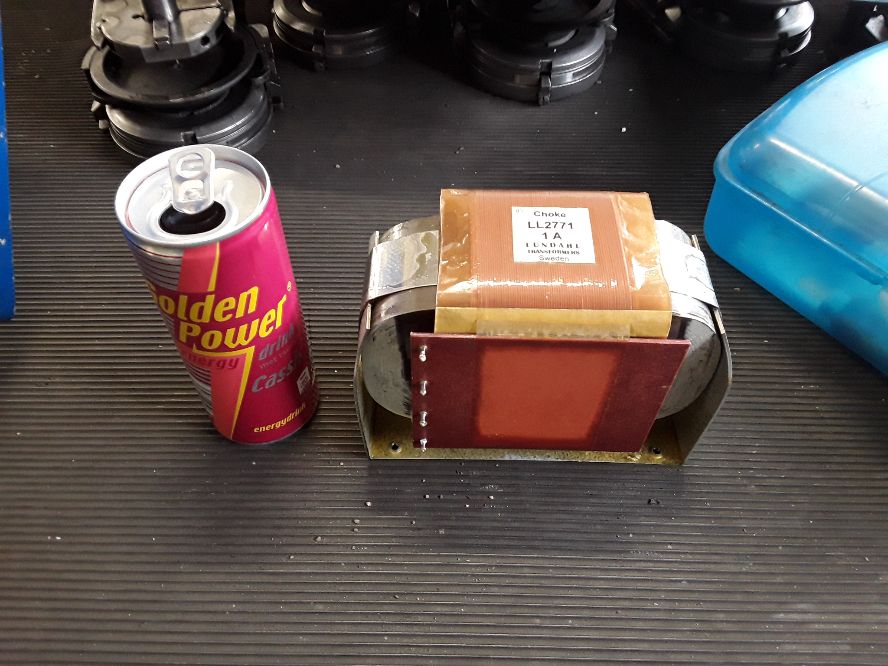

Hello,
For those people living in France and using a DDDAC with 4 boards.
There are some Lundahl LL2771 3H 1A on ebay by someone living in Bordeaux. He only wants to sell them in France otherwise i would have bought them.
If you wire the two coils in parallel ( it will reduce total DCR to 2,8 ohm ) you could also use them in some Hiraga or Nelson Pass power amp designs.
Greetings, eduard

From the datas LL2771 is power supply choke?
It is not designed to use as signal transformer.
Yes it could be used as transformer - but it is the power supply choke.
And yhe inductance of 3Hy is given for the coils in series.
So the individual coil is 1.5Hy.
Maybe it is not suficient for the good LF BW?
Please try to clculate Fo within the source internal resistance value.
That will be the output impedance od DAC or paralleled DACs...
cheers

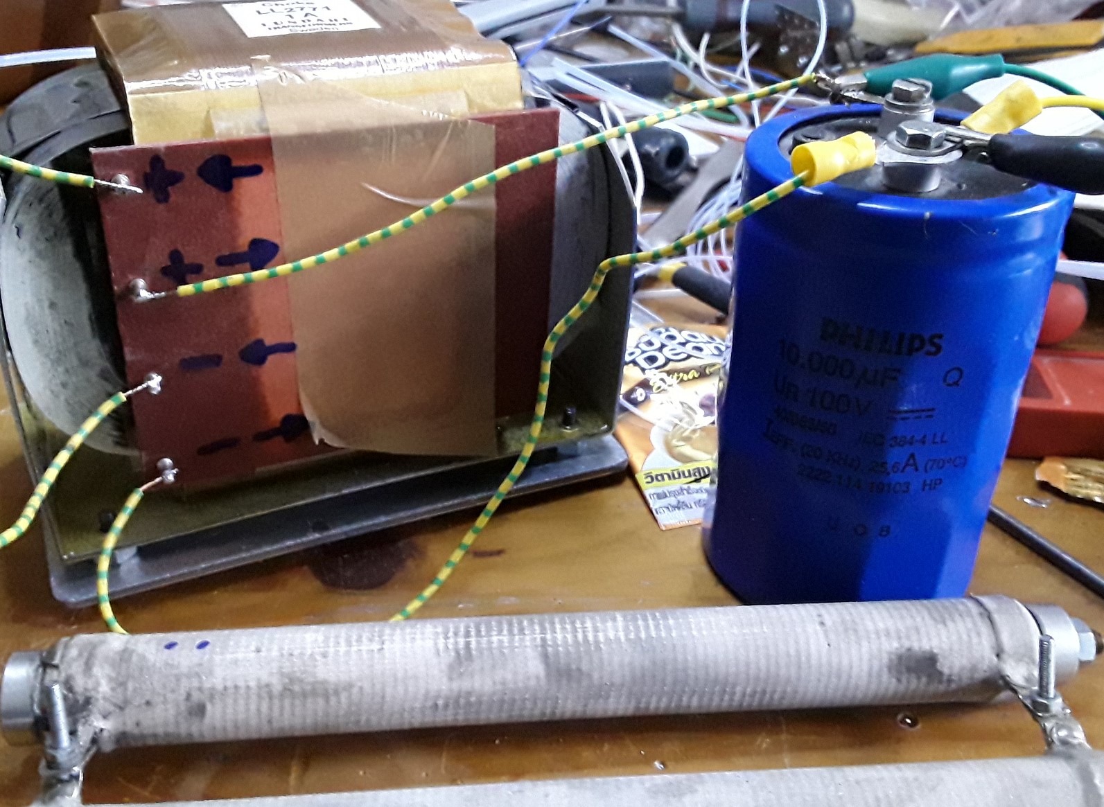

Hello,
Sure it is a power supply choke!
I use it myself too for a choke input power supply for the dddac
Also use it for Roon Nucleus power supply, for Virtue sensation m901 integrated amp and for raspberry pi3 power supply.
My friend uses it in Hiraga 20 watt power amp CLC power supply.
Greetings,Eduard
Hello.
I went from big transformer and not so big choke ( ll2733) to a smaller transformer and a bigger, much bigger choke. From 525 mH to 3000mH. Dcr is of course higher but current draw from Dddac is rock steady because of Tent shunts so i dont think it is a big issue. But you will need a transformer with a much higher ac . With 4 boards close to 30 volt ac for choke input wired as pictured on the bottom of the Lundahl pdf. Greetings Eduard

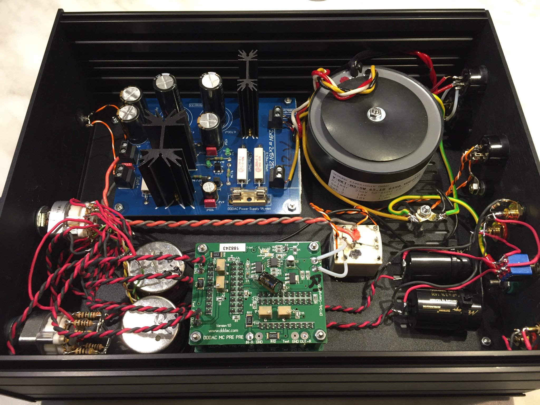

Hello all, I've been using 12VDC super regulators in place of 7810s on the analog side of PCM1794 chips (I have one single dddac board and blue motherboard) with external psu with no issues so far and good results.
A couple of questions:
- would it be better to lower their output to the tent shunt inputs to 10VDC and is 10VDC optimal or... ?
