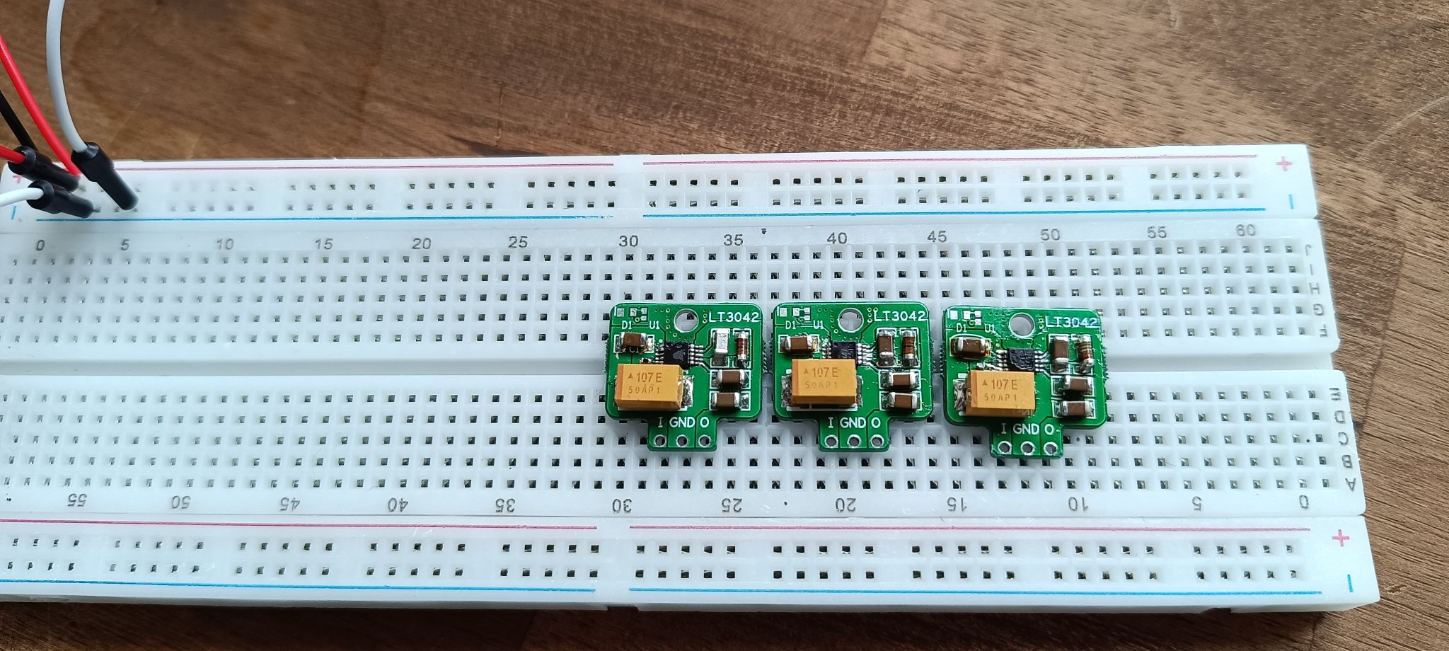

These lt3042 regulators I mounted instead of the LF50 and LF33s on the mainboard. I did do it all at once but after two days of listening I can easily say it's better, more so in imaging.
Be aware, I use SPDIF (SHD studio source), hence the LF33 replacements. Which of the three contributes the most I can't tell😉

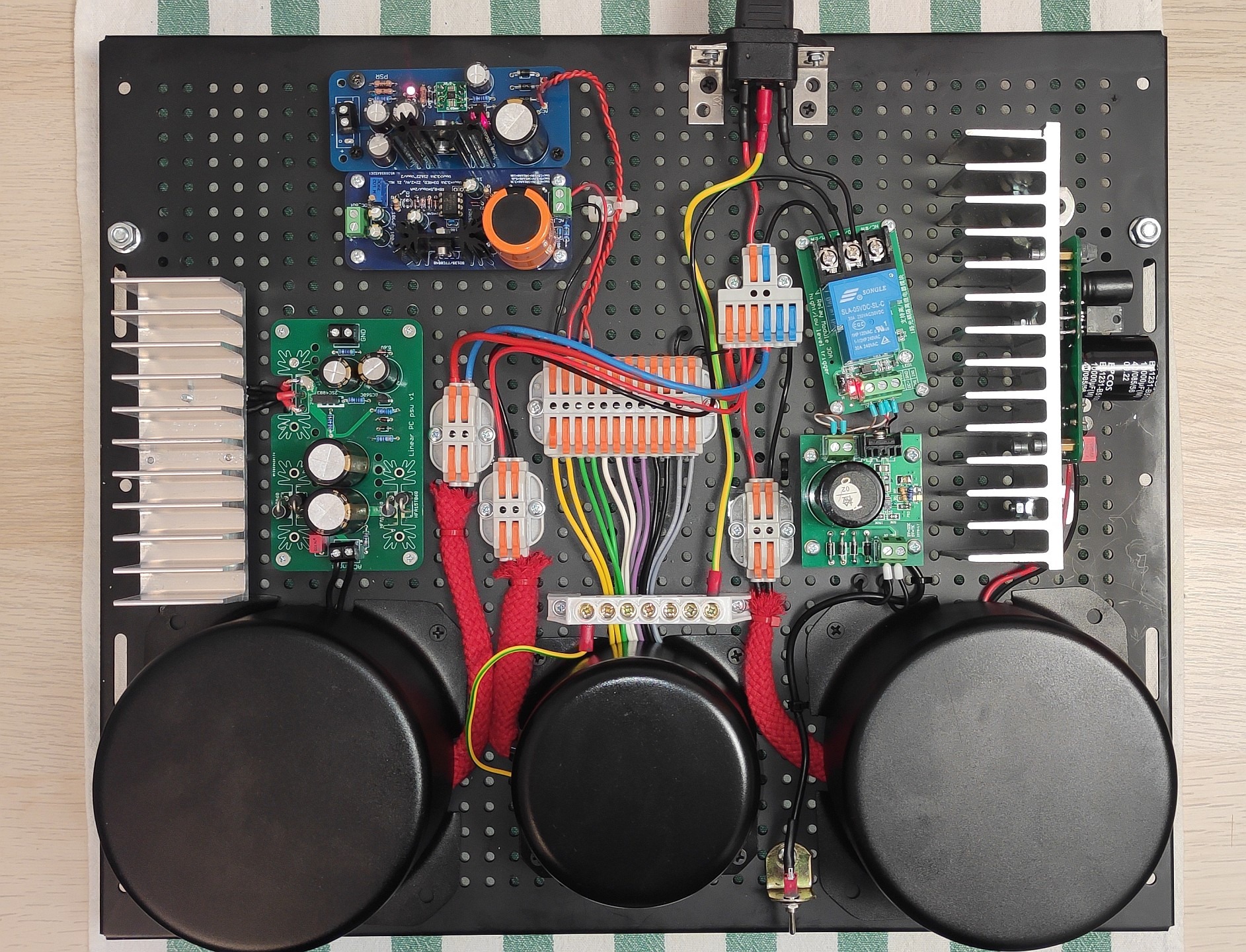

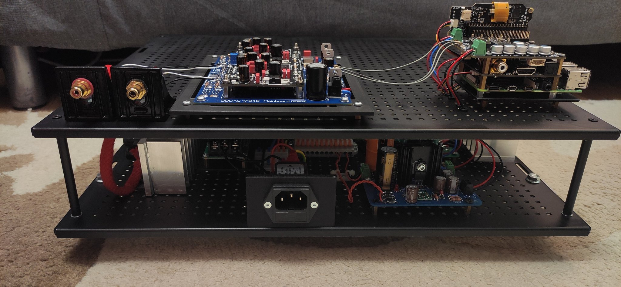

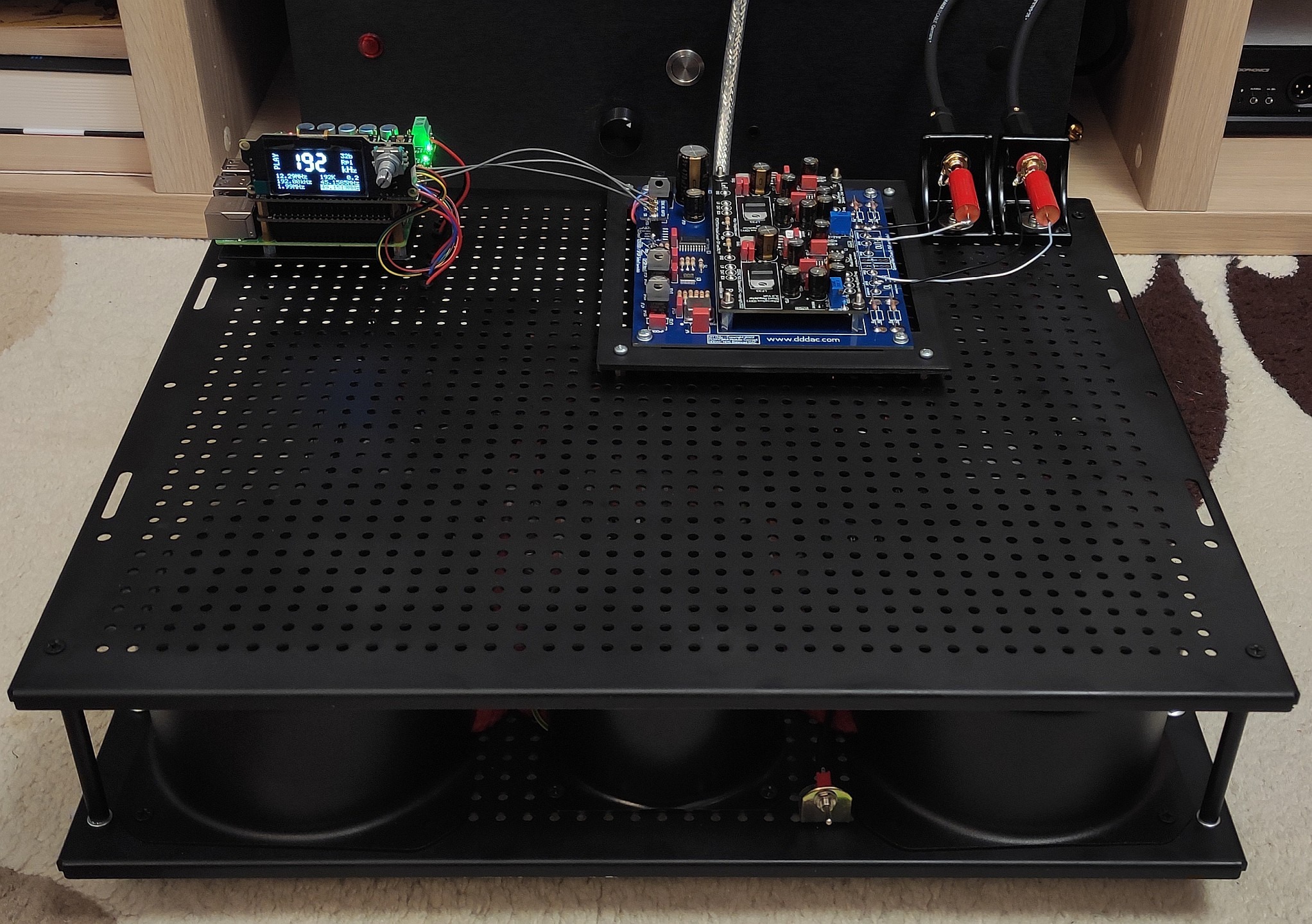

Finally I finished the DAC 😀
Here are some pictures.
Stack on stack 🙂

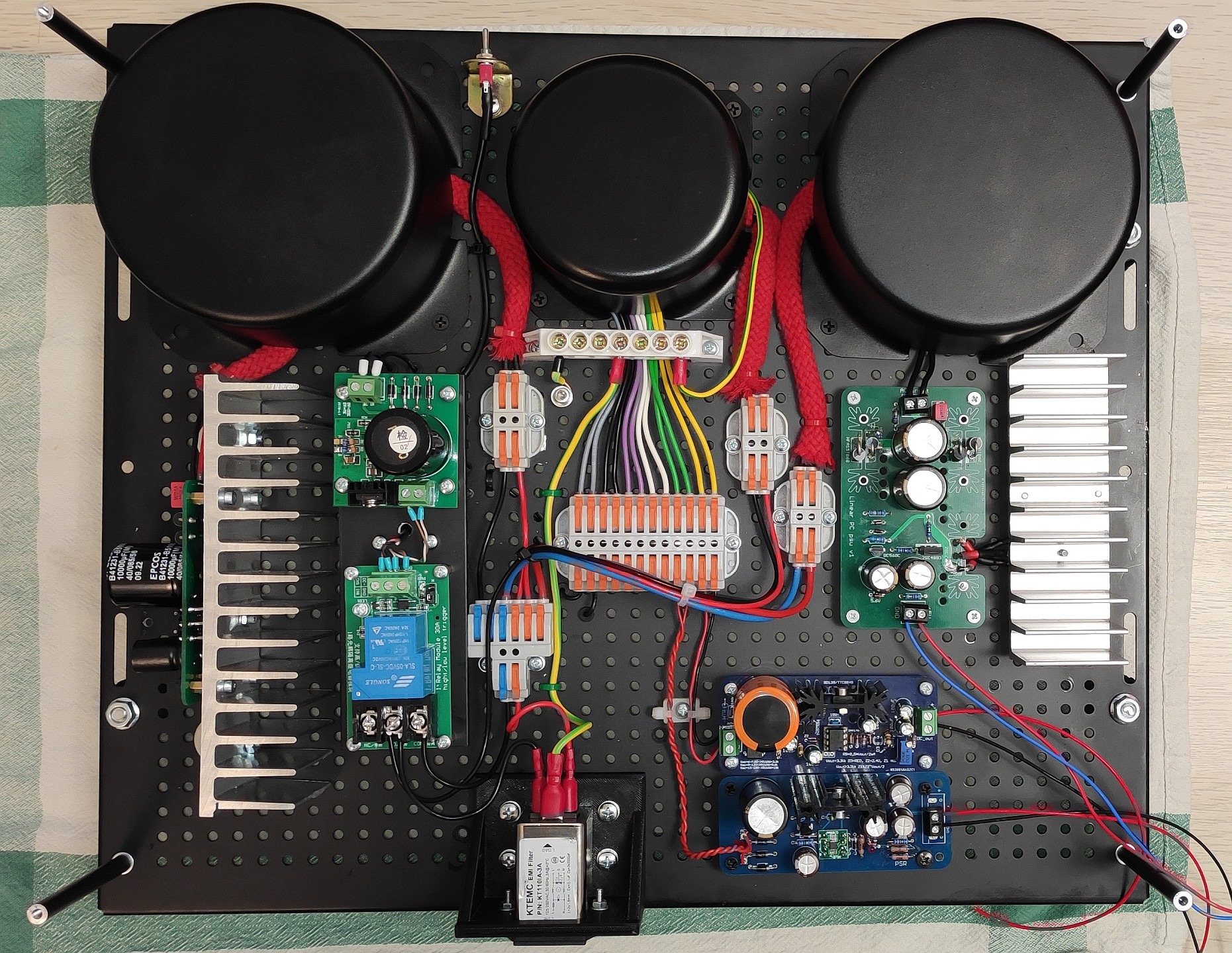

The bottom part contains the PSU boards, toroids with shielding cover on them and the relay switch for the power of RPi + DDDAC.
The left PSU with heatsink is 12V capacitance multiplier type linear supply for DDDAC. The right one is the same but with 5V output for RPi4.
Also there is a 3.3V superregulator for FifoPi Q7 clean side and a 5V one for the ReceiverPi Pro II.
The FIFO Q7 PSU remains under power 7/24 to keep the XO warm. In the future the ReceiverPi Pro II will switch this relay too if SPDIF signal is detected.

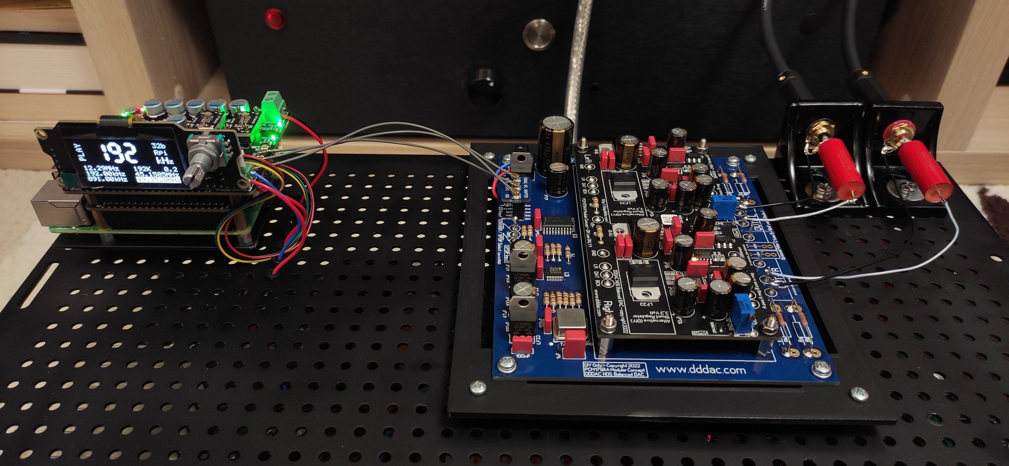

On the upper plate there are the DDDAC and the Ian stack.

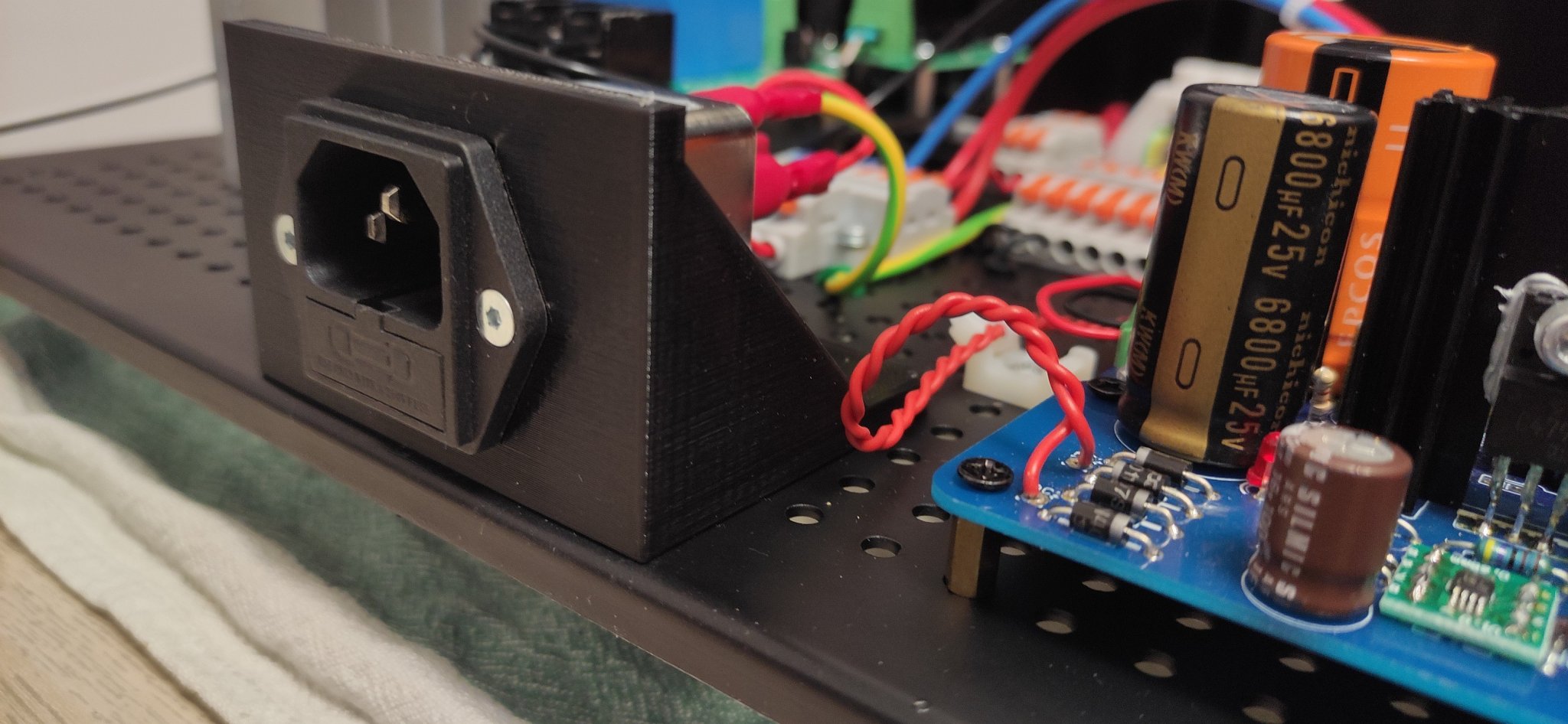

All the power wires pass through rubber rings to keep the wire insulation safe.
