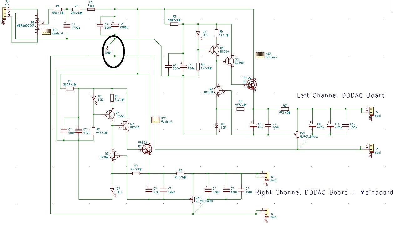

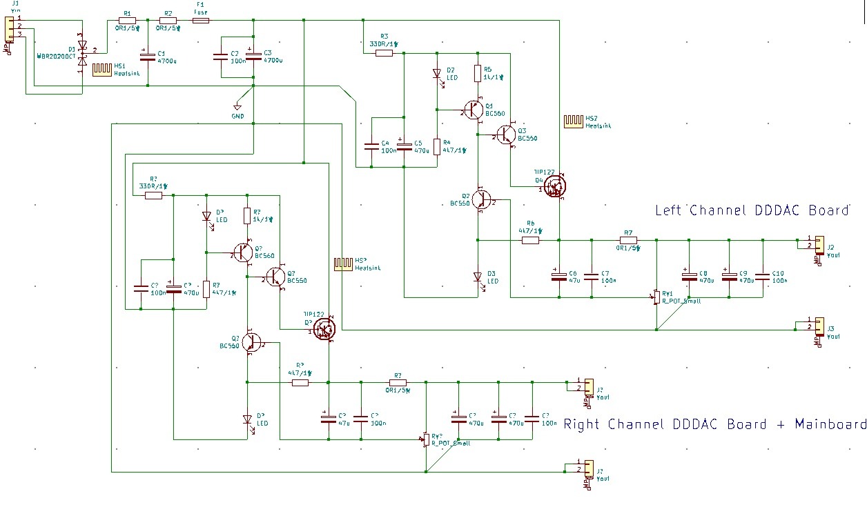

Hi Friends.
Is it possible to use such a power supply connection for DDDAC Mainboard and DDDAC board?
Sure, I see a double power supply and hence powering the DAC in double mono.
If you want to go double mono, have you considered using two DACs incl Mainboard and modify the Mainboard a little, re-wiring the LR signal, so you have a full Right DAC and a LEFT DAC, utilizing both channels and paralleling the outputs ?
The extra would only be an additional Mainboard
I plan:
Will it work properly?
- modify Dac board to separate +Vb for Right channel and +Vb for left channel
- only one Mainboard - modify for power only Right Channel {left side of PCB dddac}
- One PS for one Maniboard and Right Chanel( left part of PCB dddac )
- One PS for for Left Channel(right part of PCB dddac)

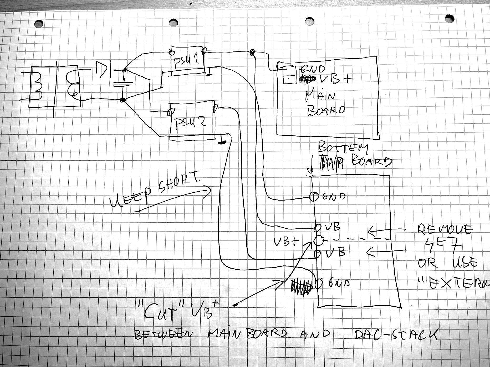

Will it be enough if the GND of both power sources is connected only in the place marked in the picture?Yes this will work as long as you keep,all commons (GND) connected
Gnd for Right Channel Dac and Mainboard will be common. GND for left channel will be separately,connected to right side of dac board.
This will create groundloops…. I will think it over and make a crude sketch how I think you should connect the psu’s and DAC main Board as well DAC decks. How many decks do you use ? Will post tomorrow
Ok, I see the need for split power supplies. For 8 boards and more it makes sense to add a Resistor on top of the boards between BCK wire entry and Ground to terminated the signal. It is not critical. I used 220 ohm till 1k - start high and lower if needed. if you do not do this, you might get some crackle in the sound. This will load the VHCT244 chip output and makes the BCK signal more stable an rugged. I tested this with 12 boards
This is what I would do…. Without transformer there will always be a ground loop, but I doubt it will be any issue this way…
Oh ****, I see a small drawing error. Pretty obvious, the plus from the top psu goes to VB+ and not to GND of course
Thank you Doede I see this small drawing error.Oh ****, I see a small drawing error. Pretty obvious, the plus from the top psu goes to VB+ and not to GND of course
GND on MainBoard does not connect to the gnd of the power supply?
If I understand you correctly, I will only connect the resistor to the upper dac board between BCK and ground.Ok, I see the need for split power supplies. For 8 boards and more it makes sense to add a Resistor on top of the boards between BCK wire entry and Ground to terminated the signal. It is not critical. I used 220 ohm till 1k - start high and lower if needed. if you do not do this, you might get some crackle in the sound. This will load the VHCT244 chip output and makes the BCK signal more stable an rugged. I tested this with 12 boards
Yes correct, only one time for the whole stack, left side and right side of the top DAC boardIf I understand you correctly, I will only connect the resistor to the upper dac board between BCK and ground.
Yes the ground connection is now underneath and in between the lowest DAC board and the Mainboard. These GND connections of course will stay, only cut VB or just not use it… both results in the same. I am sure you get itThank you Doede I see this small drawing error.
