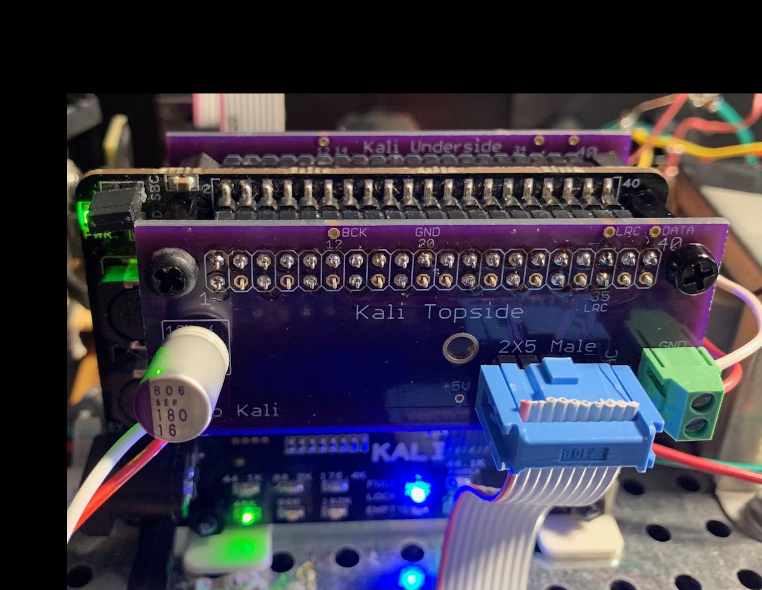

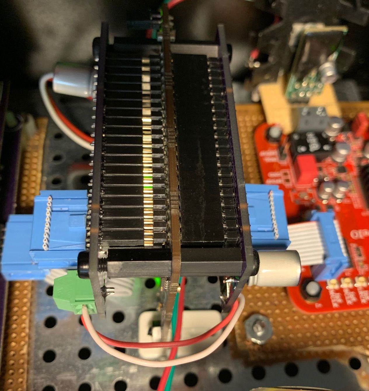

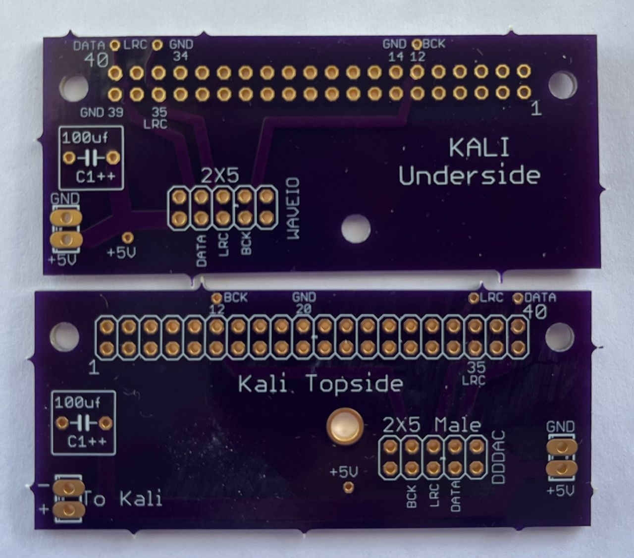

I have been using a KALI FIFO/Reclocker with my WaveIO and DDDAC PCM1794 for about 6 months using custom interface PCB's.
My DAC sounds more analog than ever. The Kali has been 100% stable with this installation.
I first referred to posts #6891 and 6911 for wire connections from Waveio->Kali->DDDAC and created a rat’s nest of wiring which worked.
Next I designed circuit boards for each side of the Kali to neaten up and simplify the connections.
It took about 300 hours of music play time for everything to fully break in.
