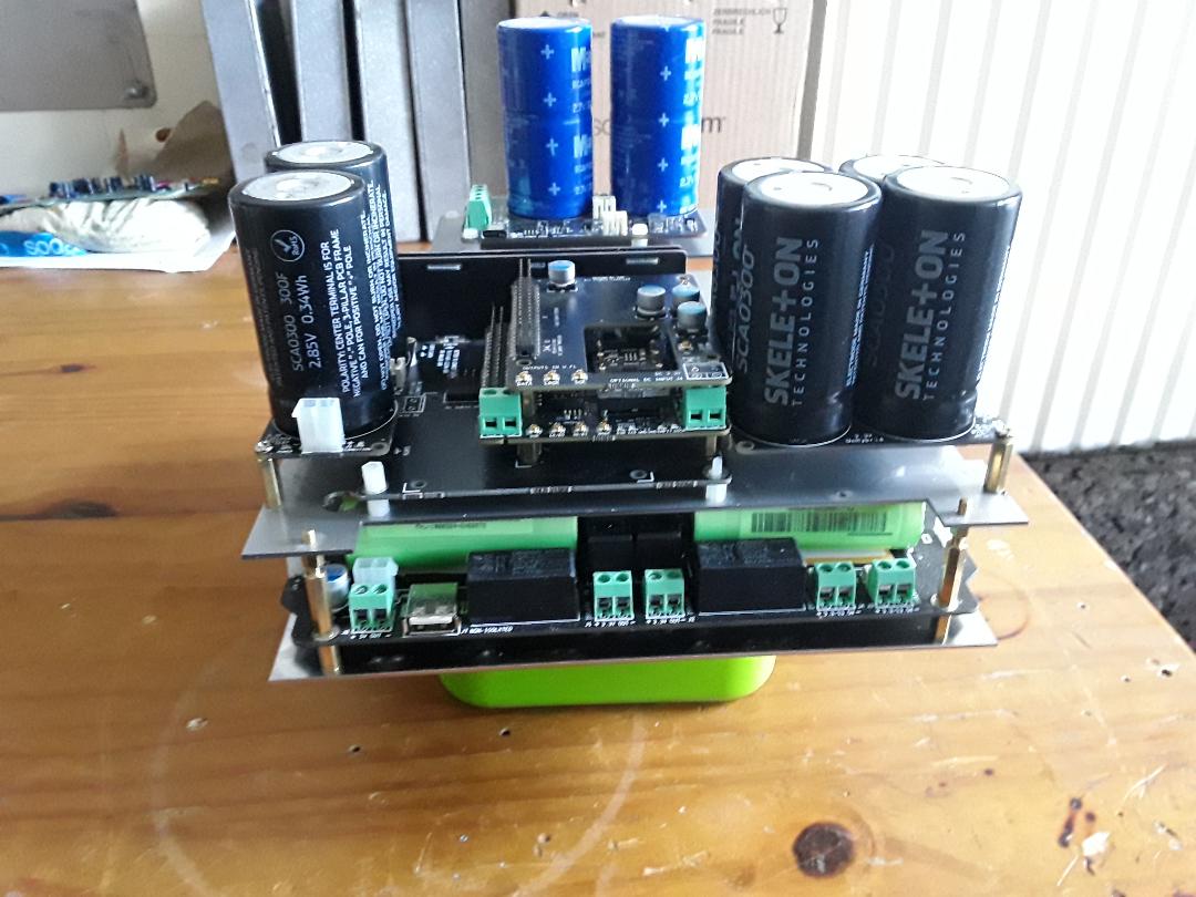

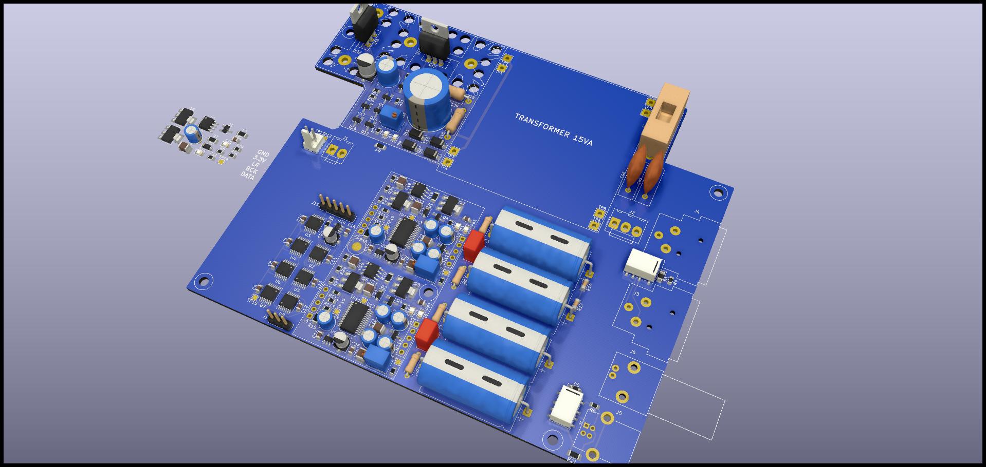

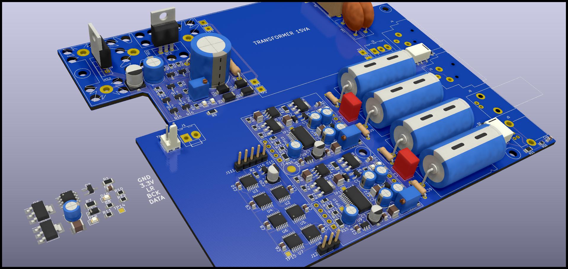

I attached custom made ddac board with new salas shunt ubib 1.3 power supply (=10V, no linear regulator before 8V shunt). It will be a two deck version. A capacitor output and USB input will be used only. Digital section is an "old red board" scheme with "blue board" data delay and supply voltage (5V).
It will fit in an 169x148x42mm aluminum case. It should be functional in one month. For now it is a work in progress.
I wanted to make a small and portable dac. I will post pictures of finished project. I hope you like the idea. I want to mention that this will be for private use only, no selling.
It is an improved shunt similar to tent. in reality, a simple shunt is a simple shunt, cant be much different. output impedance is a bit lower than tent, and noise is about the same

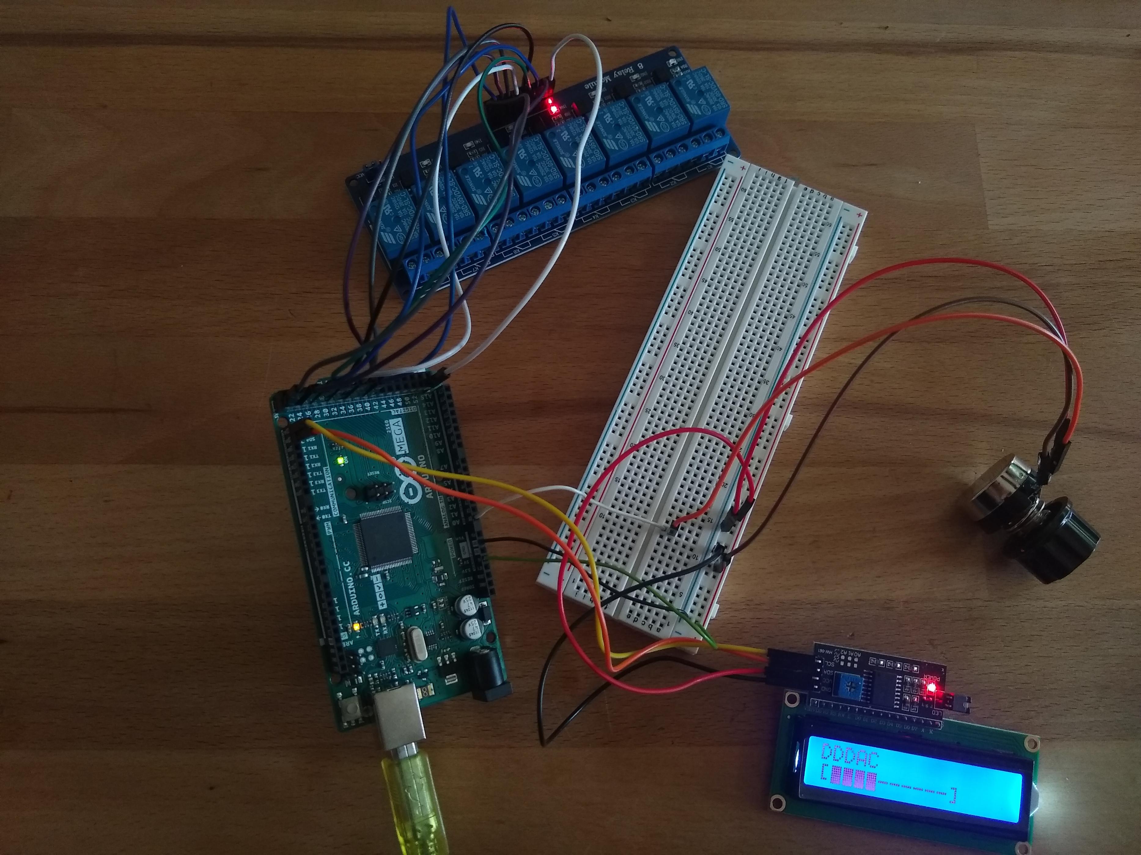

Arduino is really fun to control our audio projects !
I see in stead of an rotary pulse encoder you use a normal potentiometer and read the voltage to choose the right volume relay
interesting and also clever idea

It's my first time using arduino and I can confirm that is a lot of fun to play with it! I've choosen the potentiometer because I wanted to have it easy and secure in the beginning with no side effects like jumping volume levels and so on. There is another advantage: The potentiometer will keep its position, means volume will stay after powering off/on.
Later on, I will try to add a IR receiver with remote control. The arduino is very flexible, I like it.

Keep going Michael, Arduino can be adictive 😀
If you need any code support or code snippets for those plans just let me know 🙂
By the way, the Arduino has EEPROM on board, so you can store the volume value there as well.
Thank you Doede for your support and for the information regarding the EEPROM. Didn't know that, but actually it makes sense. Next topic I will play with 😉

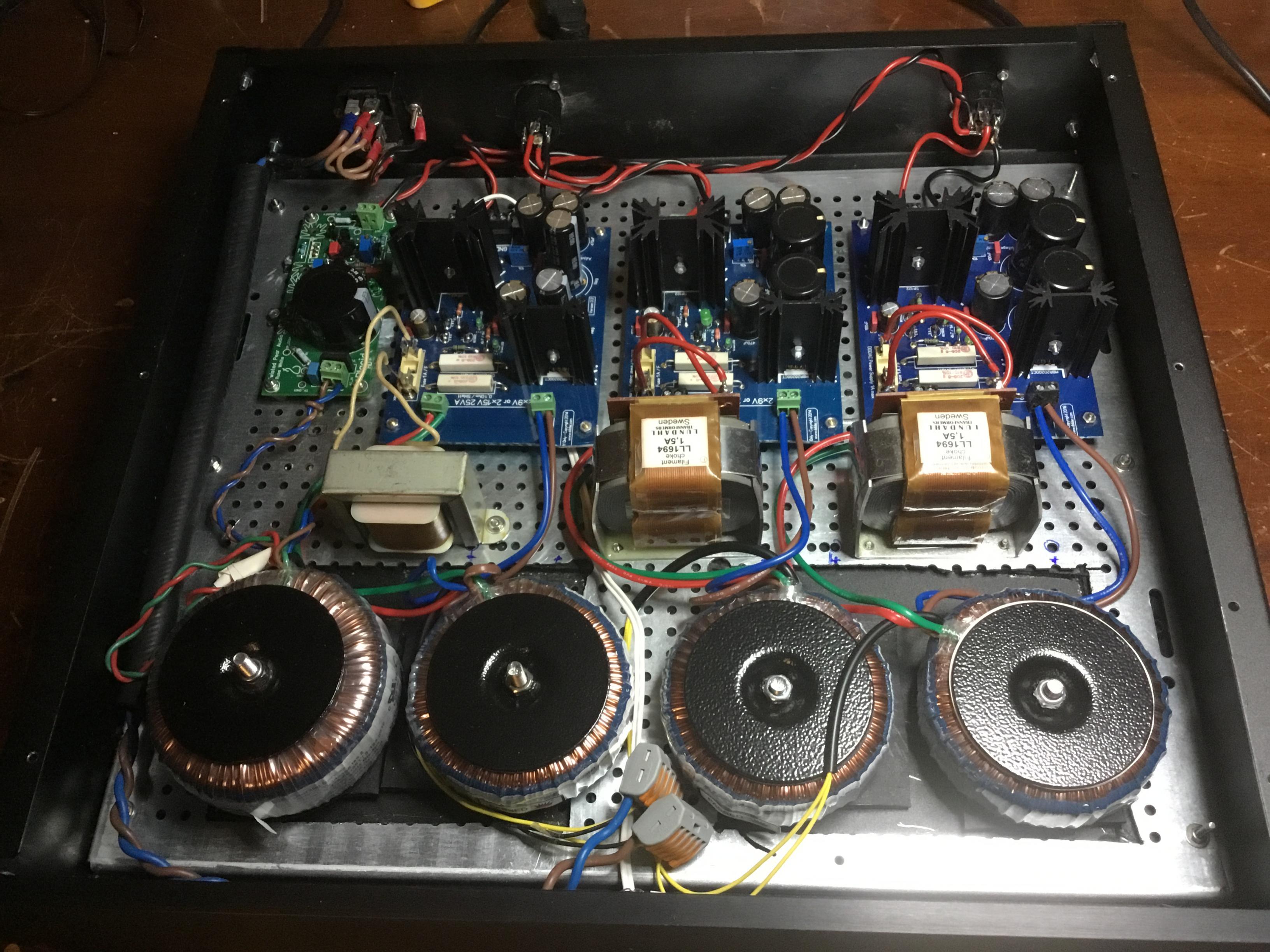

I have skipped the 7810 regulators, and feed the mainboard with 10v on input from two 5v ucconditioners from Ian, (connected in series to get 10v). Works like a charm and the sound is very good now. Less is more….
I know Doede is not happy when I have no 7810 reg’s, but I am convinced that the sound is better now without them. I have no problem so far with no regulators. It must bee almost a year ago since I did this tweak.
The 7810 are for pre regulation and also for general safety, meaning if the 12 Volt gets to a higher voltage Volt for whatever reason, the dac onboard tent regulators will not burn out straight away. Now the 7810 built in saftey features are helping...
so, if you know what you do (and I know you know) it is fine of course to let them out, especially when you come in with very good regulated power allready ....
and if it sounds better it was worth the effort for you 😎

My psu with chokes connected to the fuseholder on doede’s psu’s. The picture shows four 5v psu’s. Two 5v for the 2 uuconditioners in series,one for waveIo and one for FiFoPi unisolated side. The fifth 5v psu for FifoPi clean side is in another case behind the dac.
After I finished this psu, and together with Ian’s UCconditioners, the sound is so good that I can’t help smiling when I’m playing music. I must also mention Ian’s reclocker board on top of FifoPi which take the sound a furter step up the ladder. A cheap, but very nice upgrade.

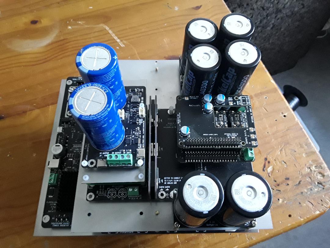

I think a few of us DDDac-heads are reading about Doede, Ian Canada, Andrea Mori and others exciting and somewhat exotic experiments with external super clock generators.
I haven't myself any current plans on going there for the time being... but it is nevertheless interesting to follow.
I do however own an Ian FifoPi + Accusilicon 318 (and a Kali for the secondary dac).
That leaves an upgradepath for the Ian ReclockPi and perhaps better crystals. Seems Doede wasn't too impressed with the 338 vs 318 and I haven't read others reporting significantly better results with other "regular" crystals.
I am however very curious about the ReclockPi, but haven't read much about it, before smooth dancers findings.
Have anyone else tried this little board and what are your impressions?
