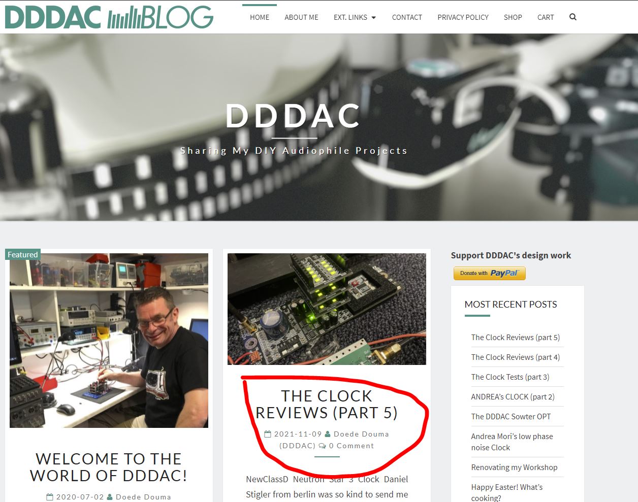

I just posted part 5 of the clock reviews.
This time with the Neutron Star 3 versus the TWTMC from Andrea Mori.
enjoy the read:
DDDAC Blog: the clock reviews part 5/
enjoy the read:
