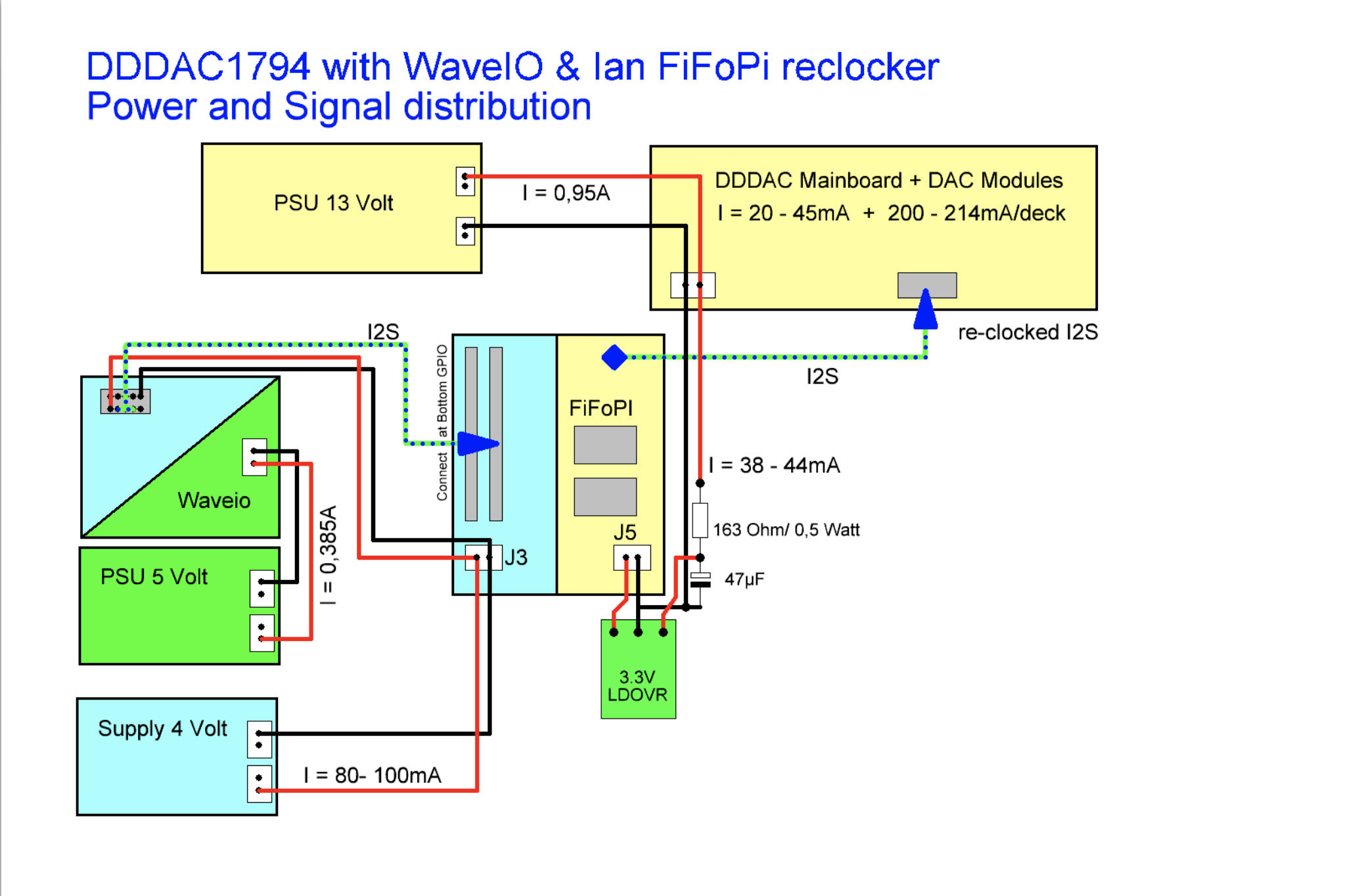

Had a question for all fifopi users here. As per the attached diagram, DD recommended a 163ohms resistor at the J5 position along with a 47uf cap. Could any of you clarify the following:
1. Is this 163ohm value sacred or could I use a nearby value such as 160 or 180 ohms?
2. Will using good quality parts - this resistor and the 47uf cap make improvements to the sound or another way to put it is that is this path critical enough to be putting say something like an AudioNote Niobium resistor or an Allen Bradley for that matter?
Hi Kartick,
1. NOT at all. it even depends on the clocks used (How much mA they draw) and that is actually the R*I voltage drop I am sparing the Regulator to dissipate as heat.
2. I would use regular components....

Thanks DD for a quick response. I am currently using the fifopi with the ACCUSILICON AS318-B-451584 & ACCUSILICON AS318-B-491520 clocks. Will the following R & C combinations work out fine in place of 47uf & 163ohms?
- 160ohms & 220uf
or
- 100ohms & 470uf
Planning to put in Nichicon KZ/FG/FW.
- 160ohms & 220uf
or
- 100ohms & 470uf
Just start with 160 - ish. Ohm and measure the voltage behind the R, at the input of the Regulator. If you see like 4-6 volts it is ok. Otherwise change the value
The capacitor is not critical, I used 47uf as I have them Lying around in quantity (part of the dddac kit)
With my 160ohms/47uf cap, I measured as you said and was getting around 4.7V; which translated to around 29-30mA of current draw from J5 of fifopi. I guess this is ok. I will try a 100ohm/220uf combo for slightly more aggressive filtering.

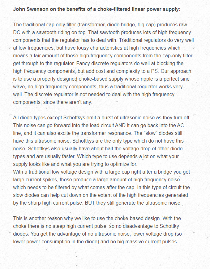

Thanks Ed. Let me explore this option as well. I am just trying to understand that on one hand, there is a school of thought that even the quality of RC doesn't matter on this path and then on the other hand we are trying to explore that we want to go the LC route to gain benefits. Anyway, I will replace the RC with better parts and see if there is any detectable improvements. Also, will arrange a choke and try it too.
Hello.
The quality of the parts of the RC will VERY probably not make a huge difference. I am no technician but i can imagine that you can make the cap to big.
First thing to take care of is getting the right voltage so the the regulator will work properly.
In the attachment you can read about the benefits of a choke when used in in a choke input power supply. LC is 12 DB so it will do a better filtering than a 6 DB RC
In your situation the input voltage going to your regulator is already pretty clean because it comes from Doede's regulator. But by adding a LC network and not a RC one you will get better isolation between the circuit being fed by Doede's regulator and the clock circuit with its own regulator.
It is not a big investment so that is one more good reason to give it a try.
Greetings, eduard

Oh okay, sure, I will check with my friends if they have a spare choke with the specs you mentioned, lying around with them. If yes, I will quickly put it to test.
Hello,
If you have a 2 Henry 50 ohm 100mA you can just add a resistor in series a get the right DC voltage on your regulator.
My regulator had a 330 ohm plus 47 cap and Hammond has a 7 Henry 40 mA 340 ohm choke. Of course you can choose one that will allow you to make a clock change in the future. Probably wont make sense to use a 1 Henry 500 mA . It will work but i guess more Henry and current rating a bit closer to the actual situation will work better.
Like you can read in the article a choke works both ways.
Right now i cannot find the simulation Doede made for adding the 7 Henry choke to his regulator circuit.
Greetings, eduard
