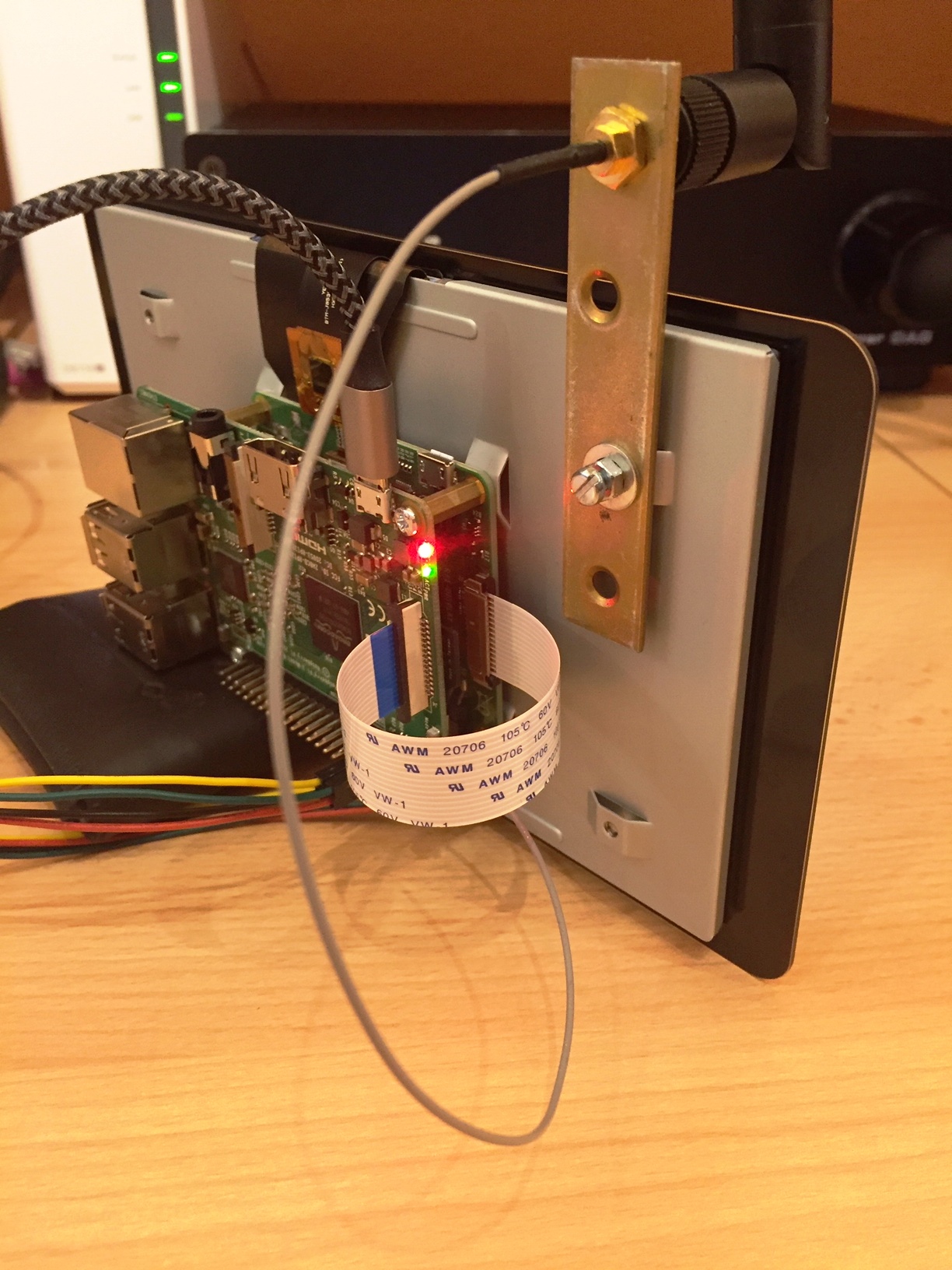

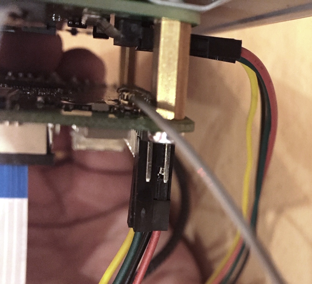

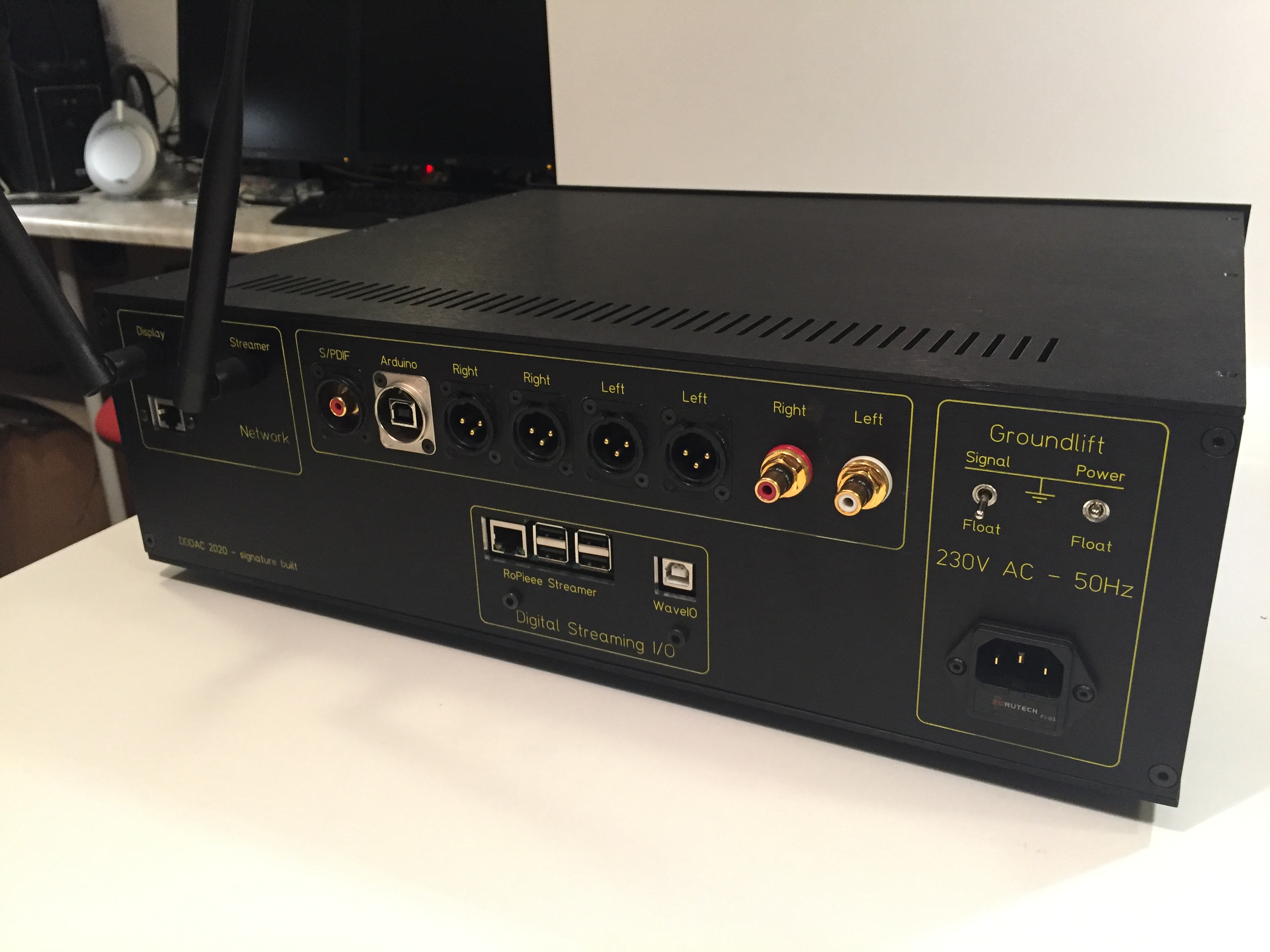

Something I promised, but forgot to post... During the revision of my DDDAC with the Raspberry PIs, I added an antenna to the PI board to get a much better reception then the standard mini antena mounted on the pcb. Purpose was to not connect an Ethernet cable to the sound system. As this would connect the earth to the rest of the house, which is quite dirty (I assumed) - The audio equipment has an own 230V group with a solid earth directly to the Home entree.
But... would it influence the sound? I did some testing, with and without cable and to be honest, I could not really hear any difference.
So te be 100% sure, I left the cable out and my DDDAC PI Ropieee streamer is streaming on wifi, without any dropouts up to 384kHz. I use a separate wifi hub with an own network SSID for this by the way just to be 100% sure I have full highway 😀
in the pictures you see a test setup what I mean
and the final backside of the DAC
I always thought that the ethernet connections are galvanically isolated. I never had any hum/noise/ground issues when I connected an ethernet wire. All my DDDACs run on ethernet connection, no problems at all. I rather had issues with USB wires creating ground loops. I highly prefer wired ethernet connections over WiFi, which tends to be fussy and unreliable.
as always, the devil is in the detail 😛 You are definitively not wrong.
It totally depends on the cables used (Shielded and metal connector - or fully plastic)
and then it depends on the switch used - some are shielded, some not
I happen to have an industrial 16 port switch where the cable metal parts are electrivcally connected to earth
easy to check with any multimeter and Ohm/Beep function
