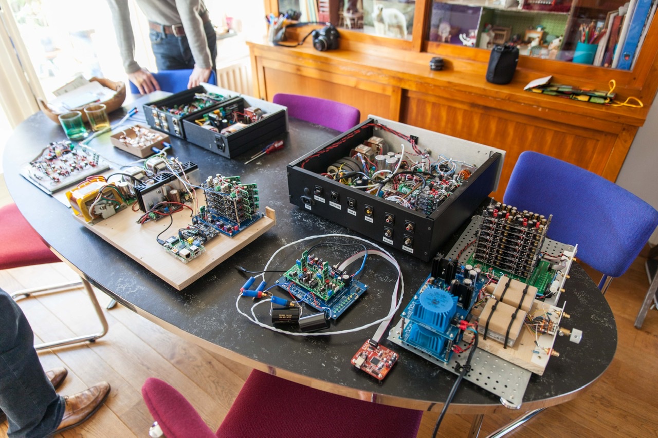

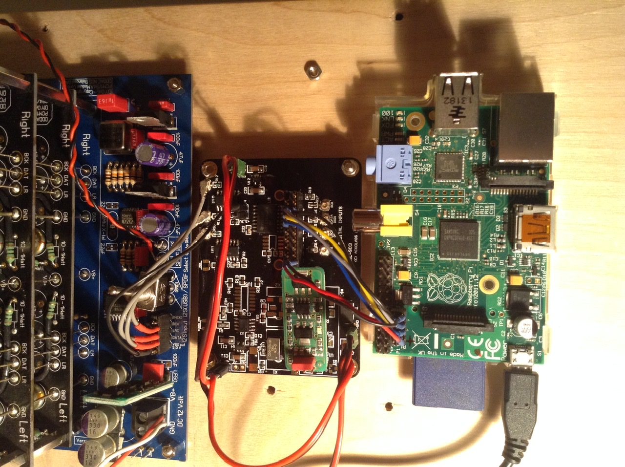

Maybe you have missed it in all the dddac power at the time (second picture) but you have already heard the dac with the tent shunt on the motherboard during our listening session (First picture)

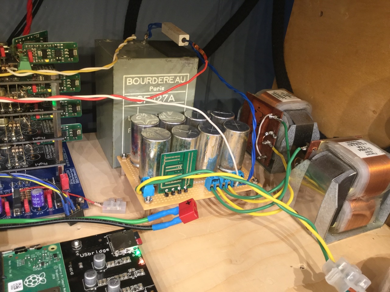

Might I also suggest another modification? I have used a mosfet bridge instead of diodes, this makes the highs a tad more clean and open.
They do not have the switching characteristic of a diode so no rf noise is generated.
You can see my power supply in the last picture.

I have a nice power supply based on the original power supply, but I am using a TIP142 transistor which can supply over 4A at 12V with no problem

how time flies..... yes remember now, that was 5 years ago and a very nice audio day
well, seems it took me 5 years to conclude this was (for me now) still the best, LOL

Is it already 5 years? And my dddac is still running unchanged; at least the motherboard with dacs, the streamer and power supply are changed for the better. There was much to gain on the streamer and clock part but the dac is pretty much maxed out.
After some experimenting with another dac and comparisons to some expensive commercial dacs this one still is the best sounding.
I use the mosfet bridge from the link of G600. I use the standard version but the low current will also do.

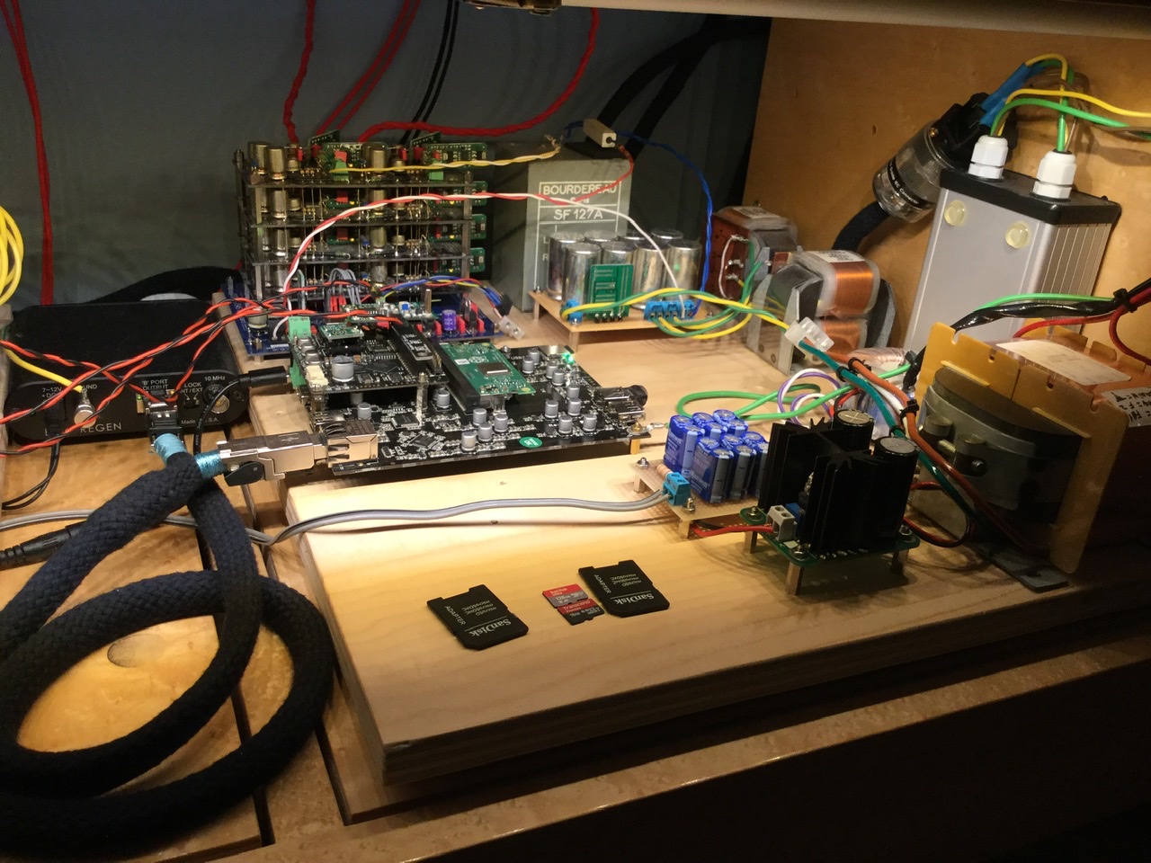

The prototype dsd dac is also in the picture, it would be nice if you could release this design for us diy-ers
