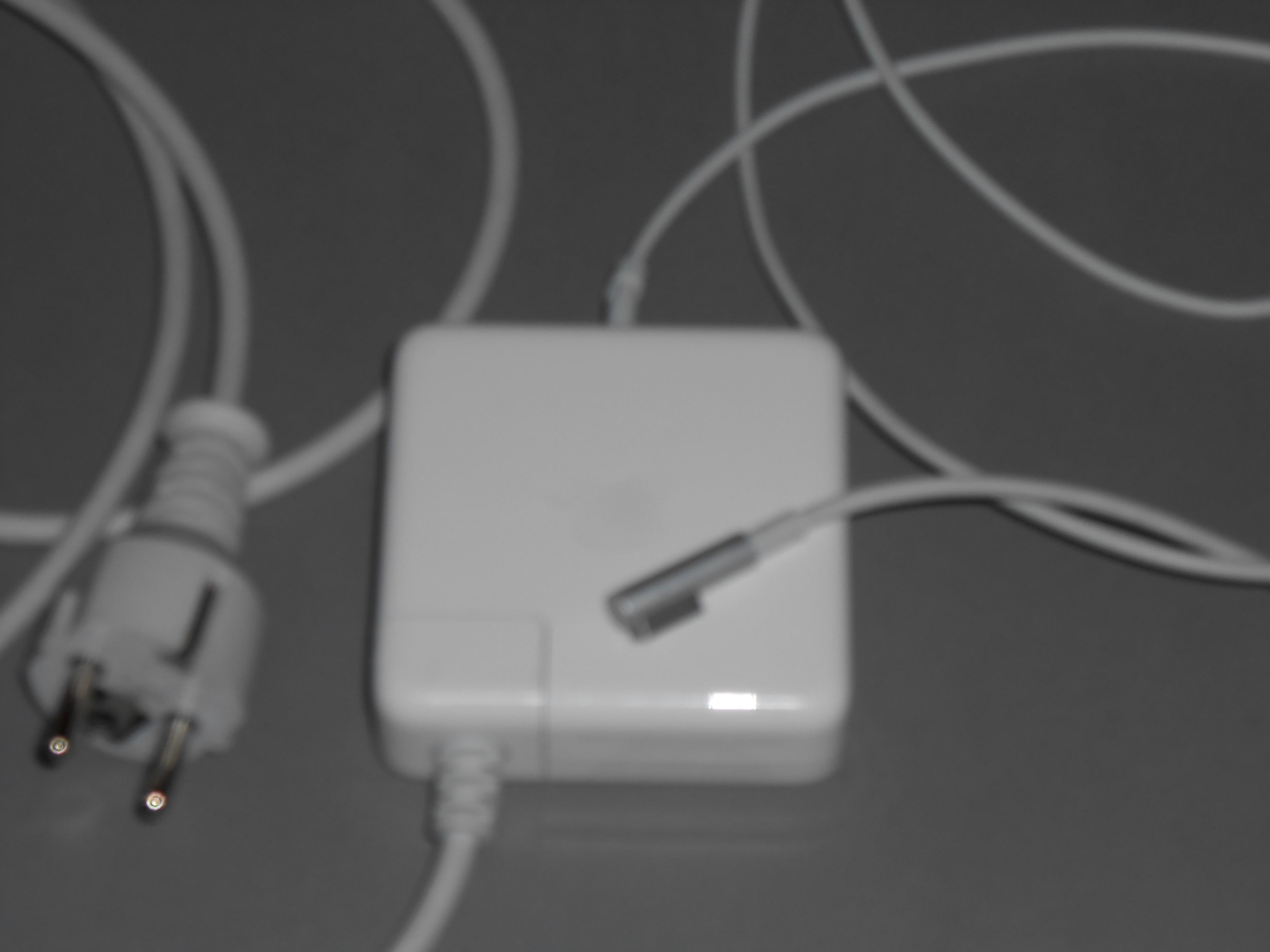

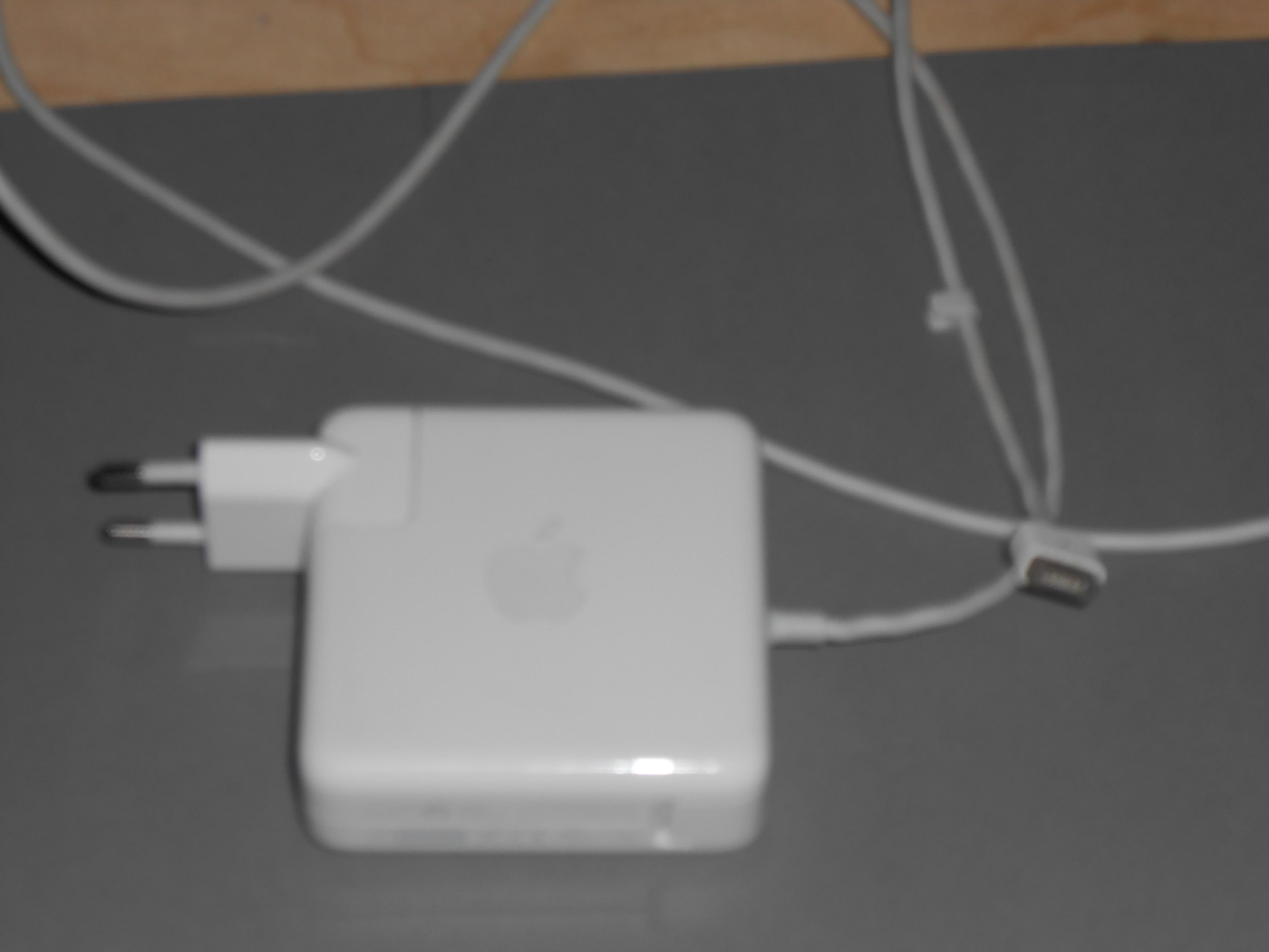

Another Apple Macintosh (MacBook Pro, Model No. A1286) issue
On a previous post #576 I reported about hissing (quantization noise).
Here I report about humming when a specific power supply is connected to the Mac Book Pro.
On and Off I heard humming when no music was playing and had the Mac Book Pro connected to the DDDac, today I realized why this was intermittent, when I had a power supply connected to the Mac there was humming, no power supply no humming.
I found this hard to comprehend, since this a lot of people use this hardware professionally. Luckily I did have another power supply (an older model) so I tried that one, and HoHO no humming with this older model power supply.
The first image (DSCN0088.JPG) is the power supply that caused the humming.
The second Image (DSCN0091.JPG) is the power supply without humming noises in the chain.

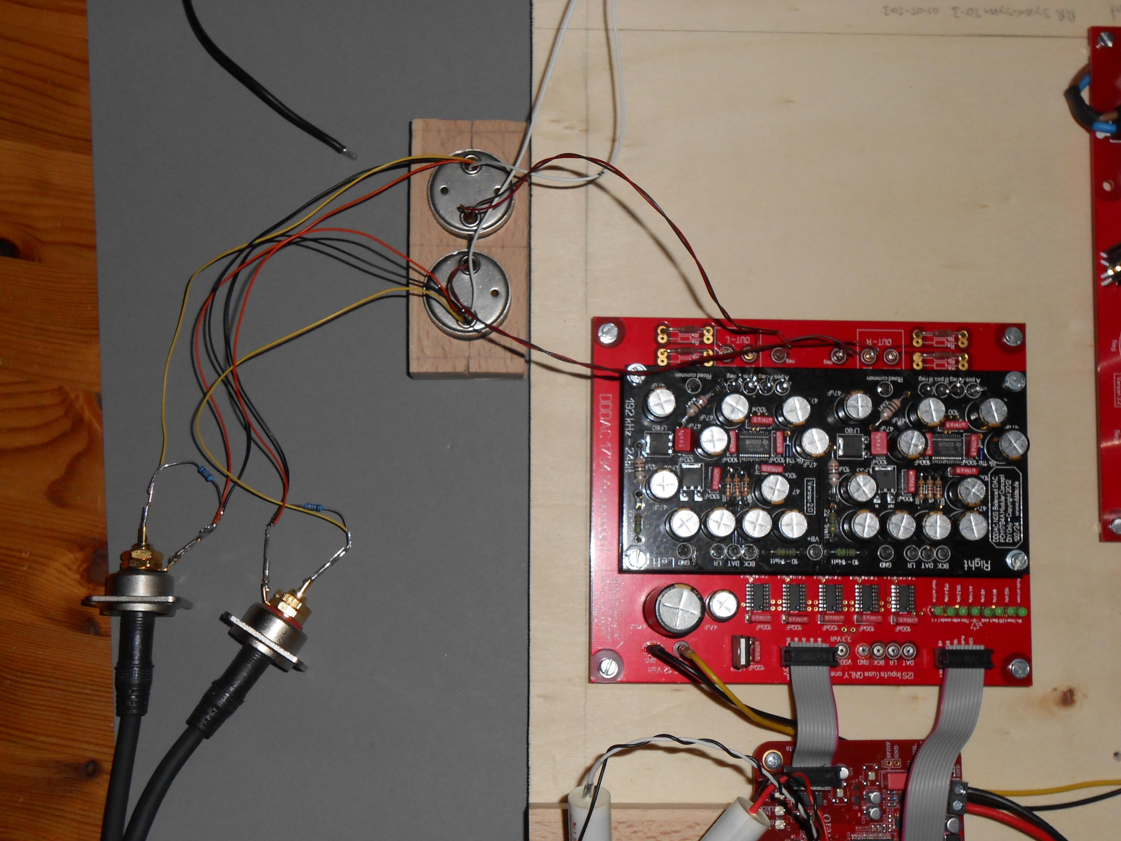

With cinemags
Today I did reconnect my cinemags.
Before I had connected them wrongly (plus in that session I had a power supply connected (see my previous post)) and the sound was dull.
Today, I went back to the paper supplied by cinemag (and helped by the clear images that walter supplied in post #773), and now it sounds wonderful.
I have no proper words (in English) to describe the improvement, but I would like to use the words "more sparkling".
The unconnected wire is the end of the white wires twisted together to be connected to the housing later. (even though my wires are not closely twisted, the sound is good).
I have not detected any loss of bass (I have directly connected a Pass F5 Clone, without a pre-amp).
