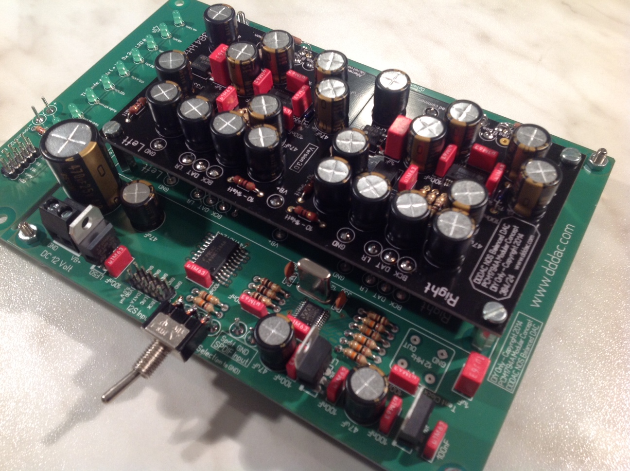

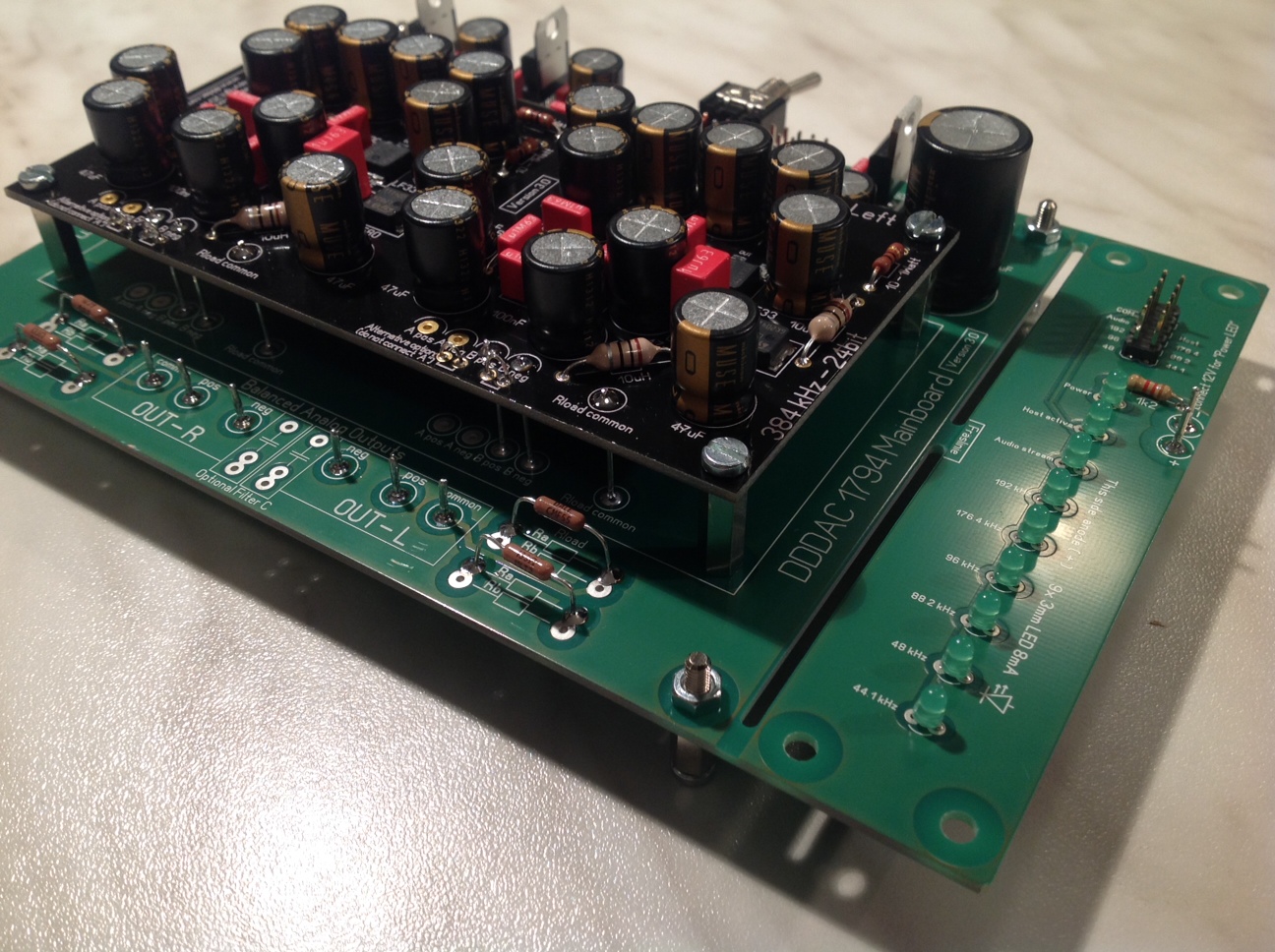

Here are the first Images 🙂

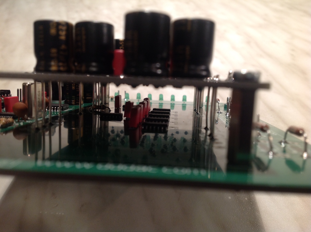

You can see I had to move parts under the deck as well. Also the delay of the data line is now done with a 74 style D-Flip-Flop. Hence no more 1k resistor in the data line. You also see the option for a TENT XO Clock and the idea to have a LED Board next to it, which can be broken off and moved to a front panel…
The Wolfson chip is clearly visable, as well the 74VHCT244 which acts as a line Driver for the decks as well to "Switch" between USB data and SPDIF Data and convert both logic voltages (5v and 3.3V) to 5 Volt Output (VHCT)
as said, next steps to add more decks

Do the components stay under the DAC-boards?
I just figured out how to get a four board DAC in a 80 mm height enclosure, but that's not gone work with components beneath the DAC boards...😱

I did not had space enough, so decided to put parts under the board. Yes it will have to stay ... normally four decks need like 90 mm.... so three decks then?

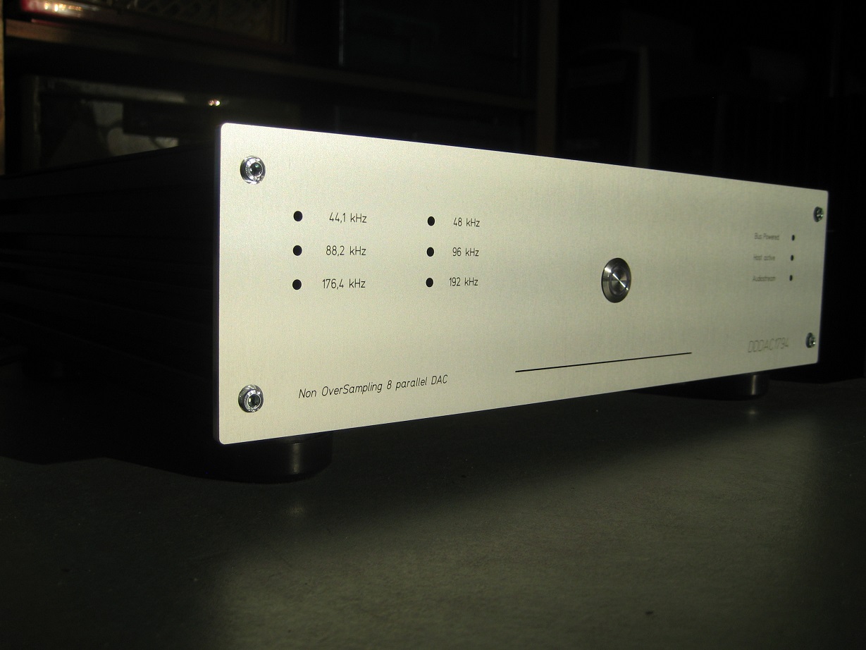

Pictures of my DDDAC1794

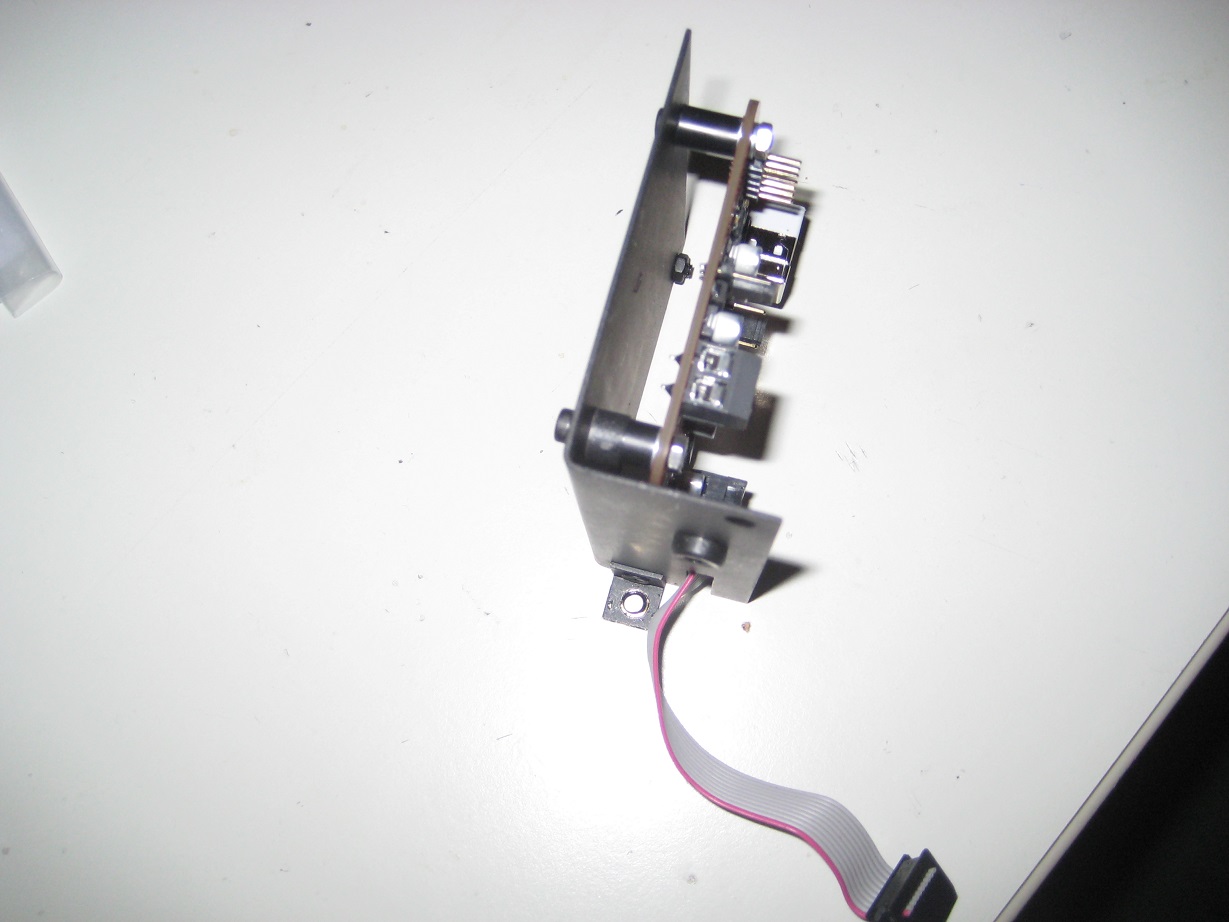

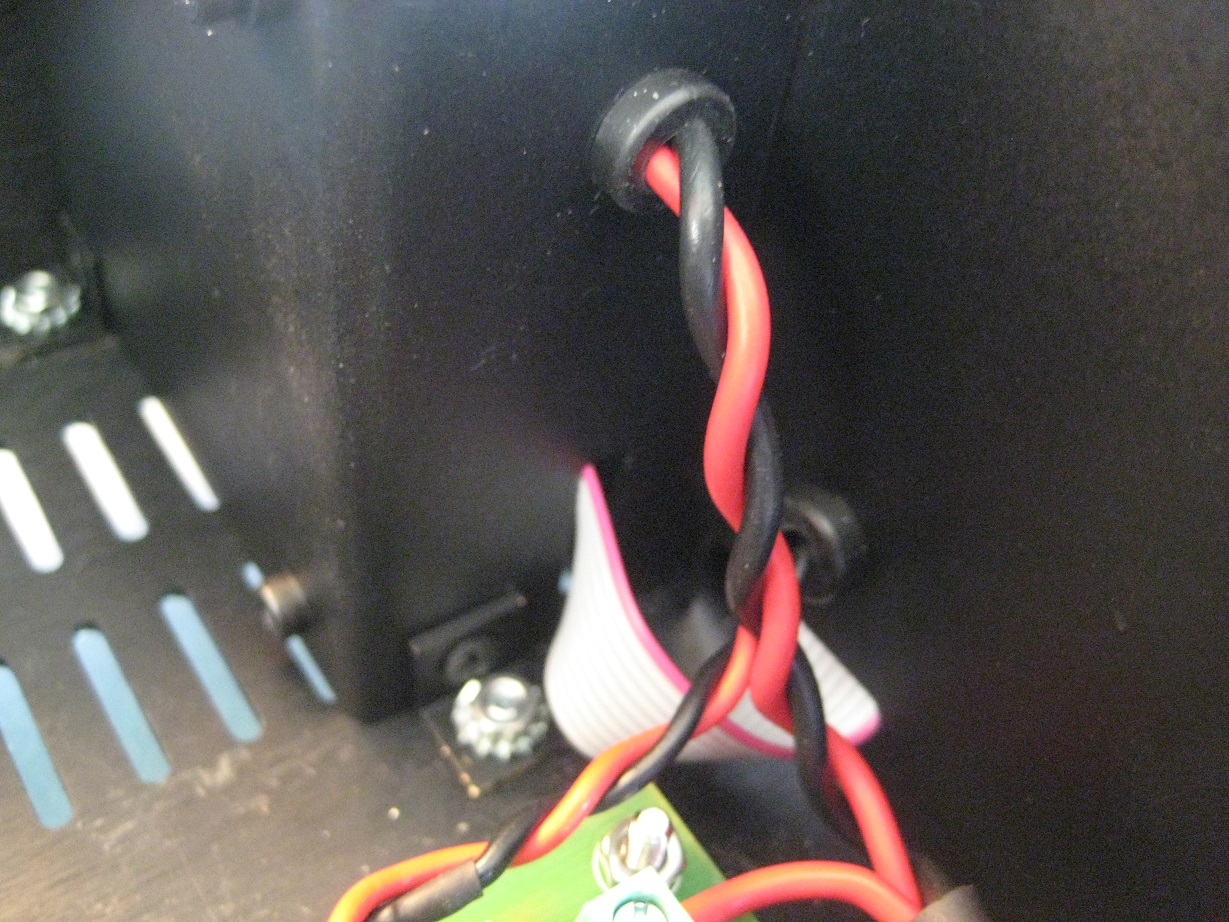

I promised Doede to post some pictures.
The DAC is playing, but still not ready 🙂
Things to do:
- It's now only "2 parallel", I have to safe some money for 3 additional boards 😀
- The frontpanel is getting replaced by a 10mm brushed alu..
- The white 230V wire has to be repaced by a shielded, better looking one.
- I have to connect all the frontpanel LEDs.

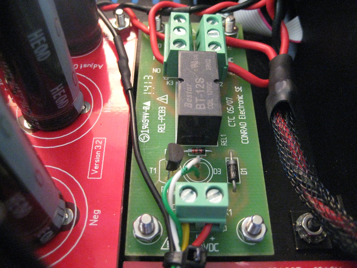

I used a Conrad relayboard to toggle between on/off with the momentary frontpanelswitch, with blue LED ring.

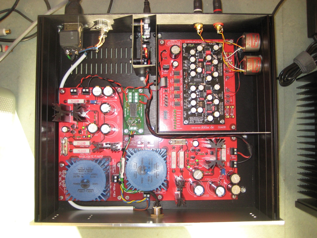

The WaveIO and the DAC-boards are in their own shielded compartments.

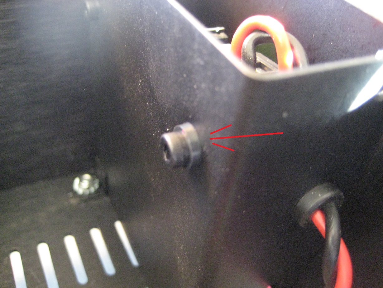

All the GND's from 12V and 5V are separated, The digital GND is also separated from the earth, meaning the USB connector and the GND hole at the WaveIO are isolated. is this the way to go?

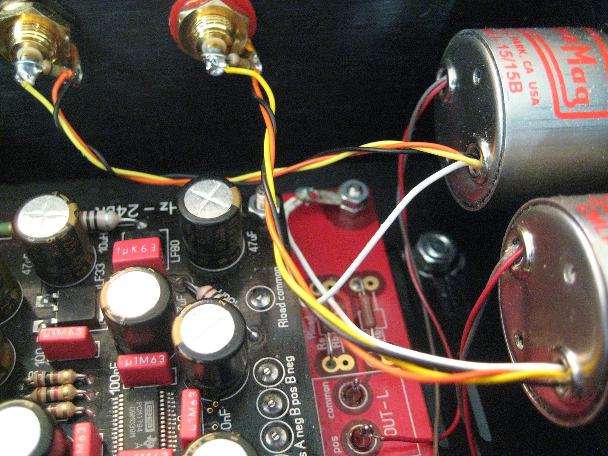

Shouldn't I connect the GND of the DACboard or the ground of the RCA's somewhere to earth (=housing)??
The RCA outputs are also isolated from anything. because I had a small hum and static, I connected the black wire (shield) of the Cinemags to signal ground. See pics. And it's now totally dead silent.
Except for the quantization noise of course, at 44.1KHz.
The white wire of the Cinemags ( housing) is connected to earth.
I hope you enjoy the pics 😀

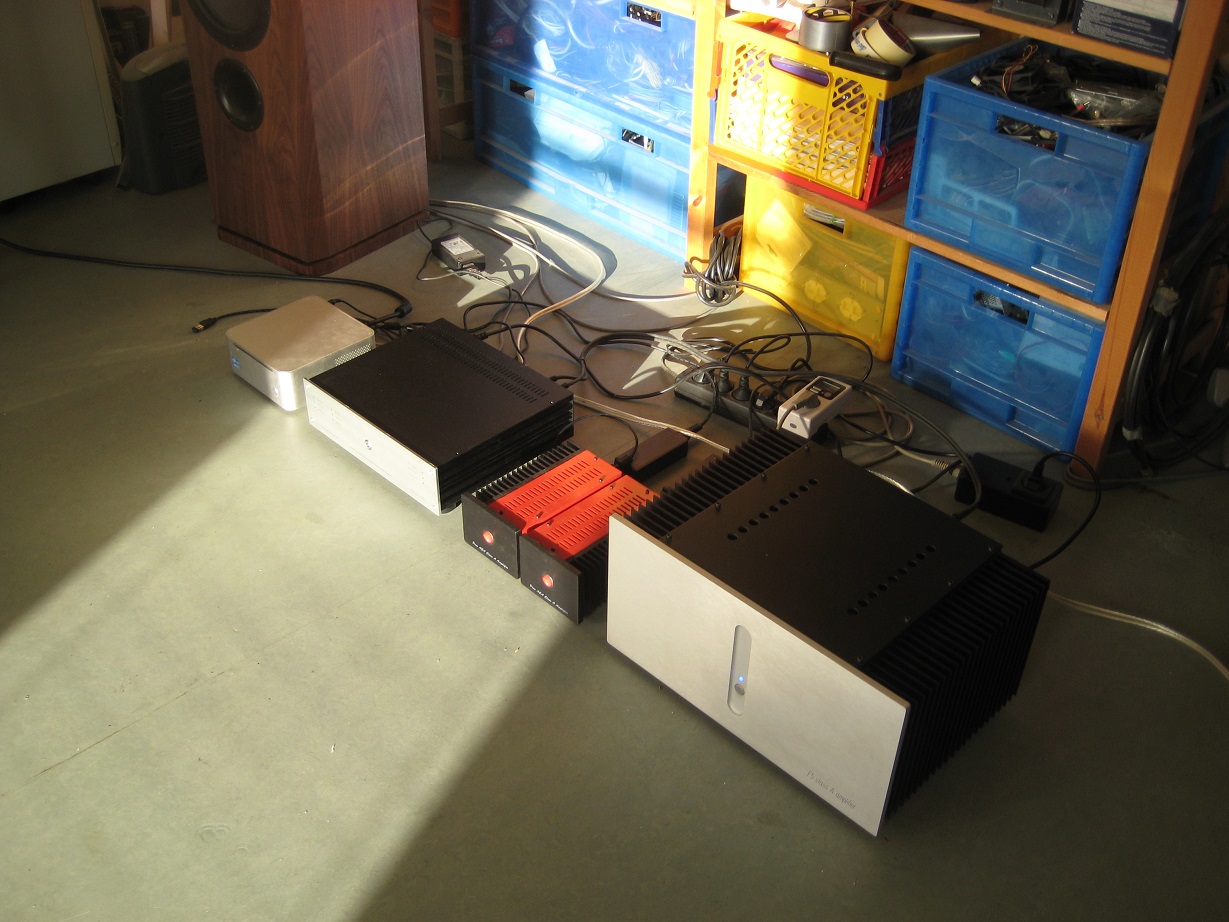

At the last two pics you see the speakers, Windows 7 PC, DAC, Pass ACA and F5Turbo v3. Which are all DIY 🙂
Walter, could you provide a link of this Conrad board?
