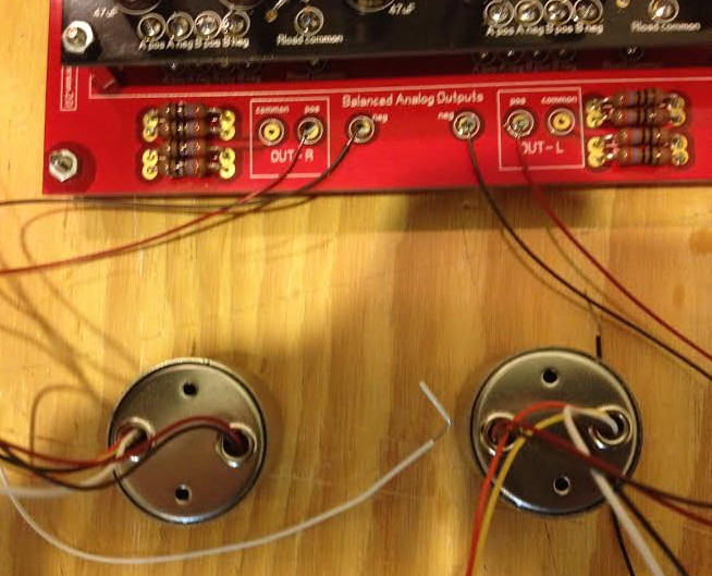

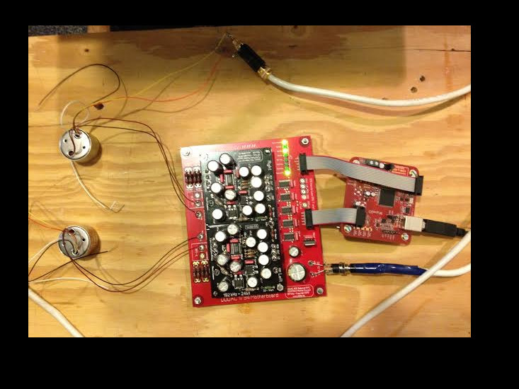

My DDDAC1794 is running after about 6 hours of assembly time. Initial upgrade included Tantalum IV resistors and Cinemag 15/15B output transformers. I downloaded the WaveIO Windows driver which magically found its way to the JRiver music playing software on my Windows 8 core i7 computer. No problems getting the computer to communicate with the WaveIO board through the DDDAC1794.
After 20 hours of music playing time the sound quality already surpasses my Sony SCD-XA5400ES with CD's. This is amazing because new wires, caps, resistors usually take about 300 hours to break in which means the best is yet to come.
I bought 8 270ohm tantalum 1% 1/2 watt resistors from Parts Connection so that I could find pairs at 135ohms that matched within .1% at the balanced outputs for each channel. The DC offset for the 2 channels is 1.3mv and 0.4mv which doesn't seem to present any problems for the Cinemags. The Cinemags have a 10K load. I paid less than $120USD for the pair of Cinemags which is much less than what high-end capacitors cost.
My next upgrade will be a DIY upgraded USB cable with an external 5VDC premium power supply for the WaveIO.
Like many others I feel compelled to share pictures of my DDDAC1794 on a wooden board.

My Cinemags have a very tight and authoritative bass. According to the Cinemag data sheet the output is down only 0.03db at 20hz. Maybe my Tantalum IV resistors matched within .1% have something to do with the bass being great in my system. Maybe excessive DC offset into the Cinemags might muddy up the base.
