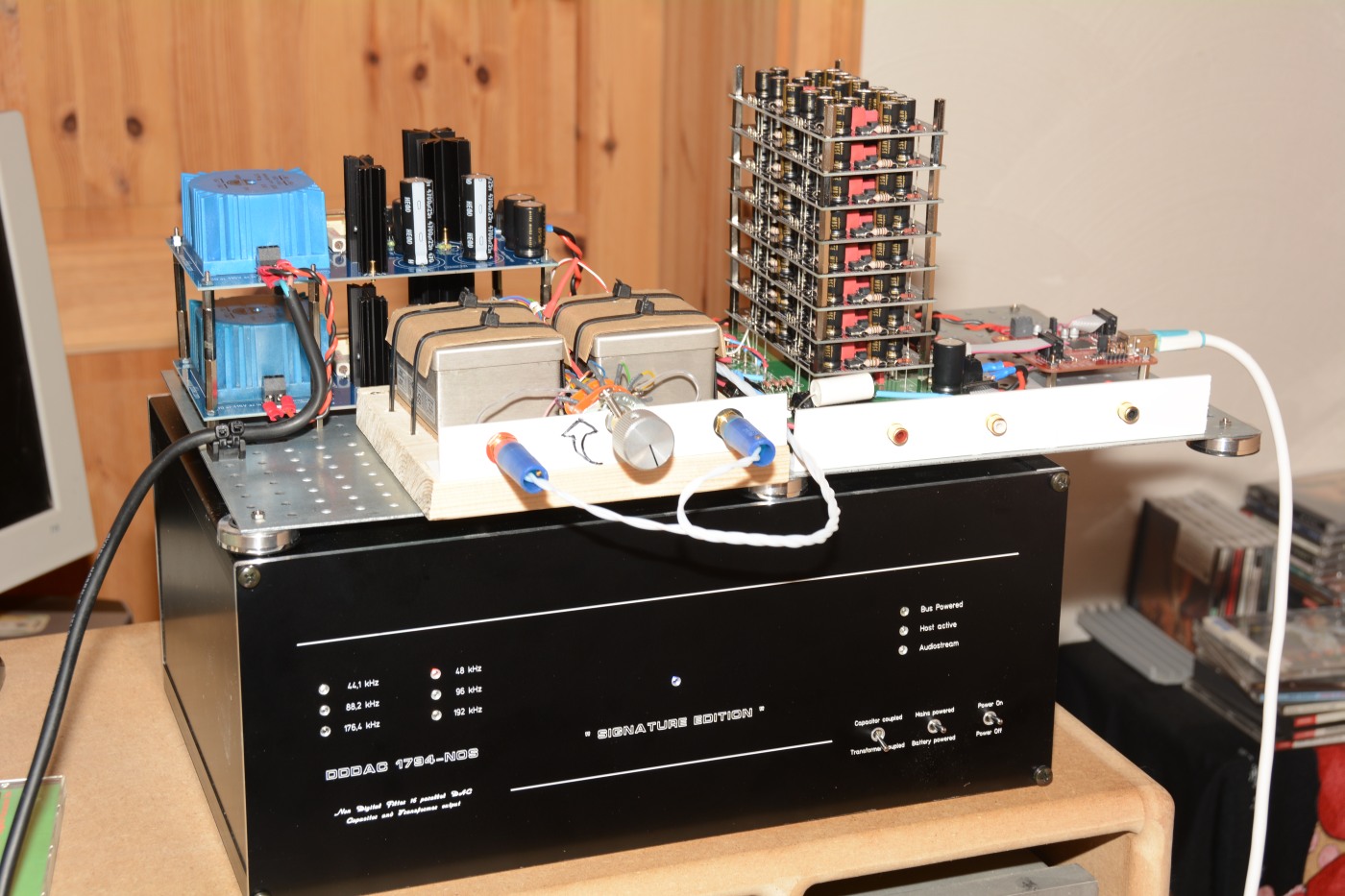

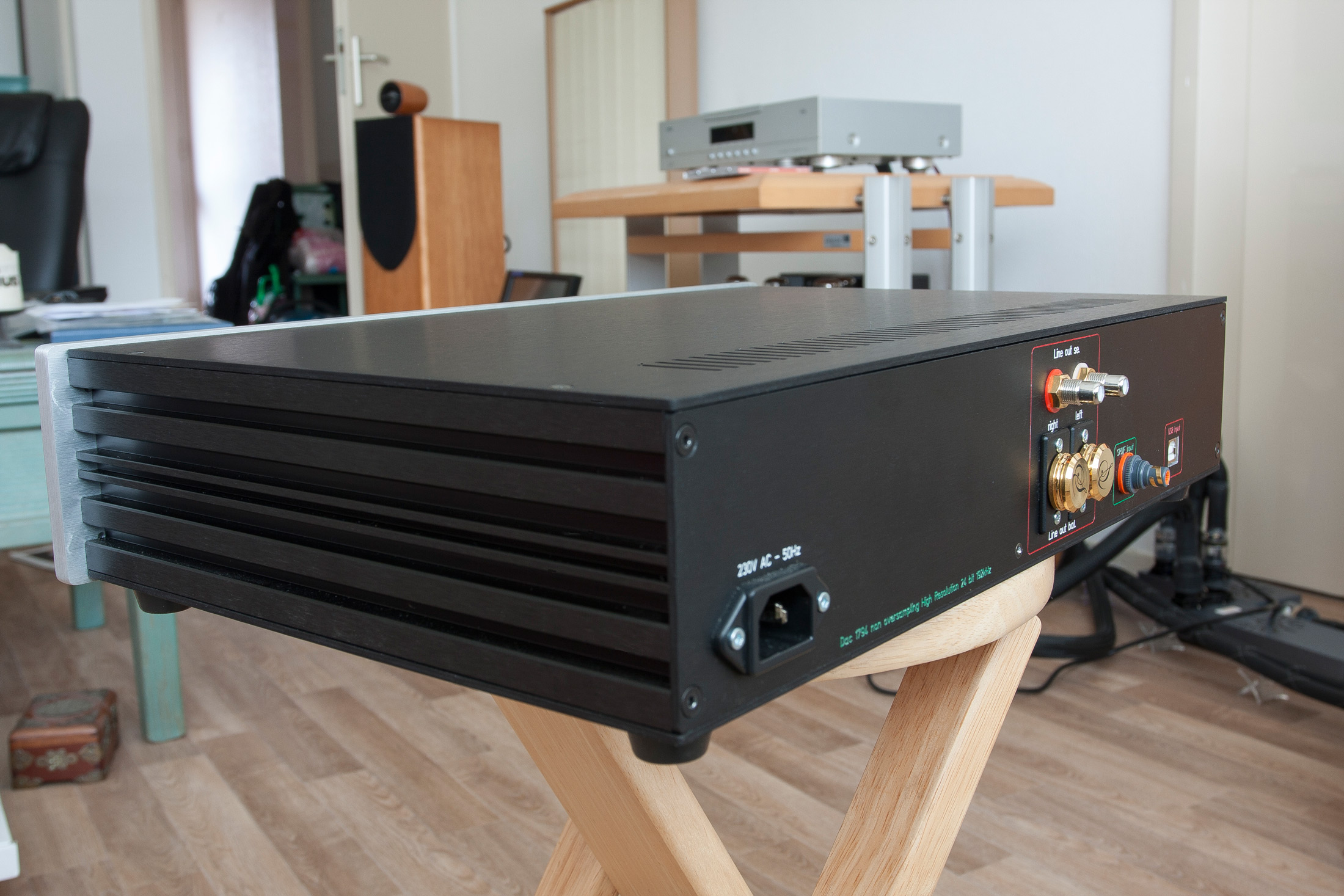

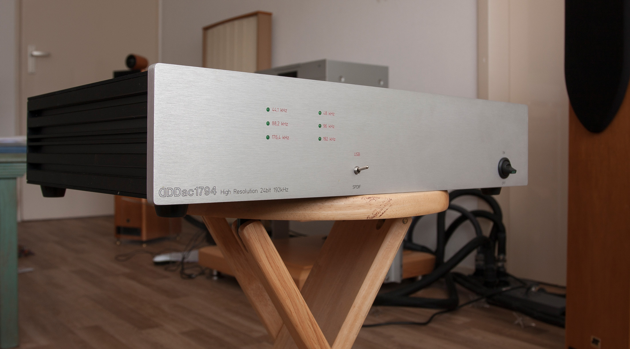

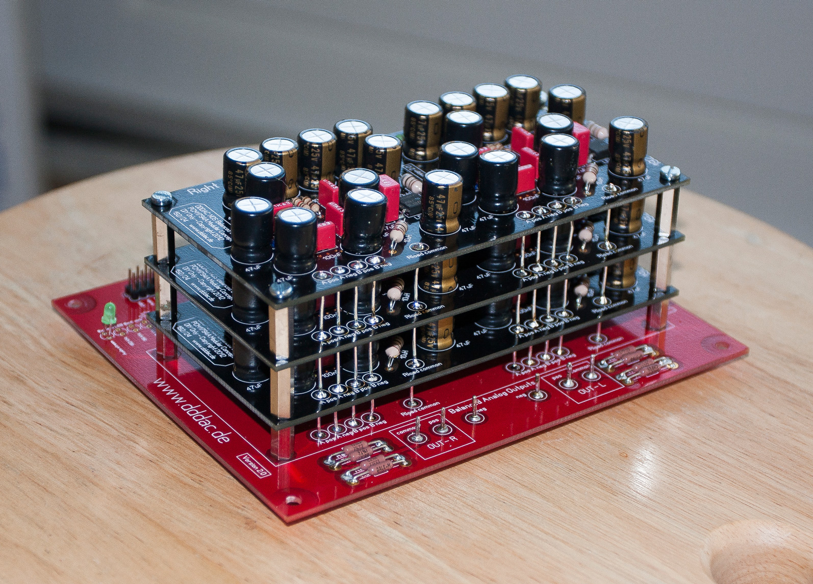

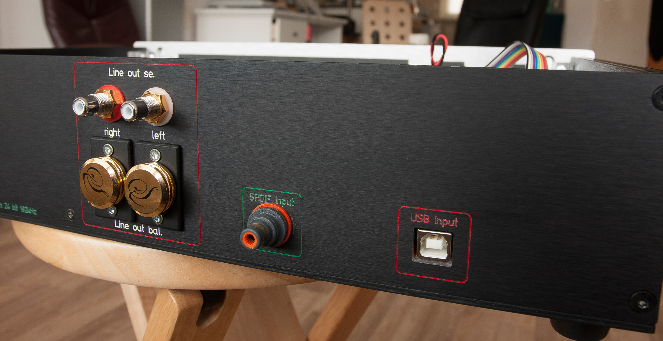

The pictures shows my project 'the DDDac 1794'
I have started with one converter deck and expanded with decks till I reached the top plate of the housing. 🙂
The drilling and engraving is done by company Schaeffer in Germany and is very precise made by computer controlled cnc, Schaeffer also delivers the software for Mac and Windows to design the lay-out.
Nice software and easy to use.
Costs for the front-panel 51 euro and back-panel 45 euro, this price is without material and transport-costs.
I have the casing from an Italian company Hi-Fi 2000 which costed 120 euro (Modu 1NSLA02280B).
I use cinch chassis connectors from Cardas because I also use Cardas cinch cable.(perfectly fit between cinch plug and cinch chassis part)
Neutrik XLR and 75 ohm cinch connector from WBT.
This WBT connector is for the SPDIF input.

Hello beardman,
First I was using Mundorf caps, the very known gold ,silver and oil type.
Later on I tried the Cinemag trafo.
There is a certain difference in sound.
The Mundorf has a little more push in the high frequencies the Cinemag sounds a little more rounded.The main reason I use the Cinemag is because of the isolation(galvanic).
Noise (digital?) is better isolated.

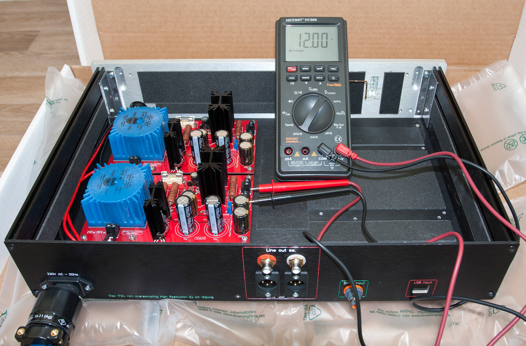

rfthon, very nice! Great case. Nice gold connectors at the back
What is it, you taped inside your housing, the black stuff? EMI related?
I see you didn't like the ugly wirewounds in the PSU too 🙂 I let them in cause some inductance isn't a bad thing at that place in the PSU, but....😀

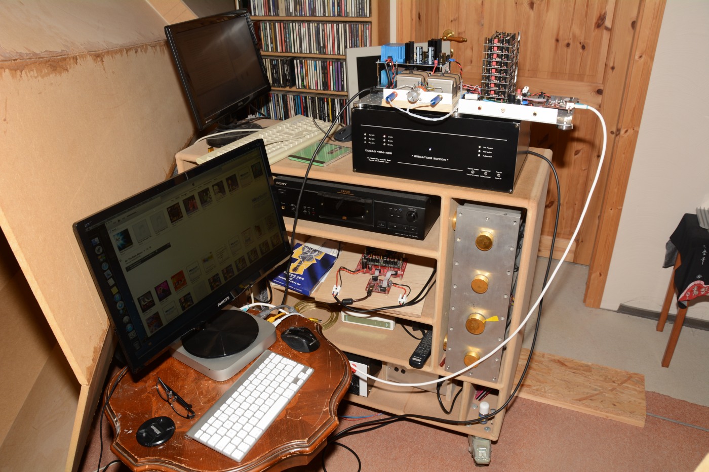

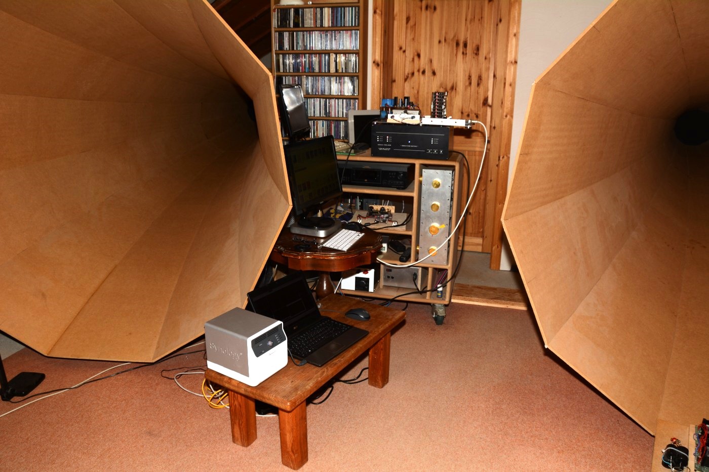

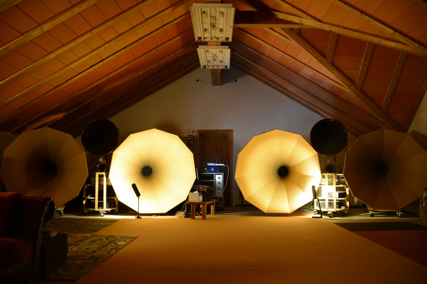

OK, Pics first (or it did not happen 😉 )
Set up was the 8 Decks Version of the DDDAC1794S with Silver Plus USB Cable, WaveIO with 2.15 and 1.65 Version Drivers. CD Player Klaus his high end Sony 777. Notebook WIN8.1 with JRiver19 and Foobar and Mac Mini with Audirvana. 8TB NAS box with Music. Also the Sotwer TVC Versions. To compare my original 4 DECK DAC with "normal" Sowter output
and Klaus his fantastic GOTO System 😎 😱

TEST-day DDDAC1794S
Goal was to just test through the new DAC and try some things with players, cables etc. But most of all, testing the new DAC on USB and SPDIF
This is in summary what came out:
8 Decks version works 100%. Sound is very fluid and analogue, especially on low volume. Lots of detail and very solid and contoured bass.
SPDIF versus USB. USB rules… Spdif is just behind in clarity and spatial sound stage. USB has bit more texture in voices. Spdif you could say is more rounded, les hearing through. (Still clearly better than stand-alone CD player with its own analog output)
Sowter versus Capacitor output. More space, more fluid without losing high presence (not so rounded like Cinemag 15B) As Tuyen write: you hear deeper in the music. Background is extremely quiet.
USB Cables, Less pronounce. Both Silver plus and Klaus his Kimber Cable play very neutral and open. Basic cable loses a bit detail. BUT not as big a difference between transformers and capacitors…
Music players: Foobar has been catching up. Difference is almost nothing left over (or is it WIN 8.1?) MAC is just bit more open. Could not really tell difference with JRiver (but it plays FLAC …)
8 deck versus 4 decks. Clear improvement in low level bass. More rich details and micro level detail. Is it worth the 4 extra Decks? If no budget constraints? Big yes. Can you live without? Of course (But Reinhard for sure not, haha)
By the way, on Feb 15 we have a new session for the DACs with Jean Hiraga, who owns now a 120 chip version of my older 1543 dac. He also wants the new 1794S 8 deck DAC, so we do some shoot out day again. Questions for 16 Decks are already coming in. Would be nice to try ;-)
What else…. Lots of music! We sometime totally forget to watch for sound differences and were just drifting away on the music. That is our aim anyway, isn’t it?
