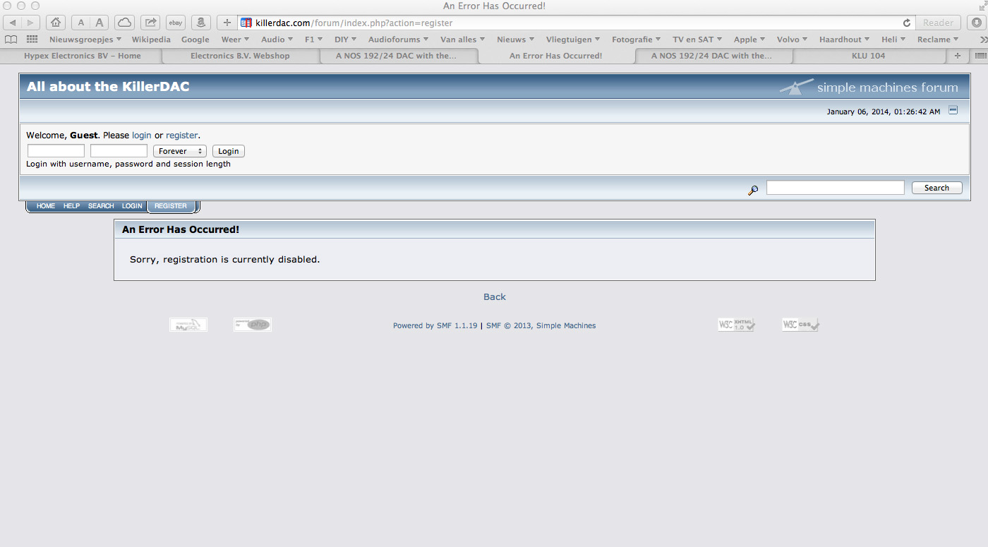

Okee, Doede, ik heb het geprobeerd :(
Okay Doede, I tried! :D

o.k. Doede just informed me that there are troubles to have access to the killerdac-site... so I felt free to put my report right here for you:

access to the http://killerdac.com
there is good news:
because of the problems having access to their site the managers of the "killerdac-site" just told me that they had to close the site just because of spammers... they have opened it... and they had to close again because of exactly that problem...
...but, they are going to upgrade the software in order to solve the problem...
...and in the meantime they are so kind and offer to register interested DIYers instantly, and I shall just pm them...
so, if you like to, feel free to pm me and I will gladly pass it on... there are some great threads to "discover" over there which are very well worth it...
