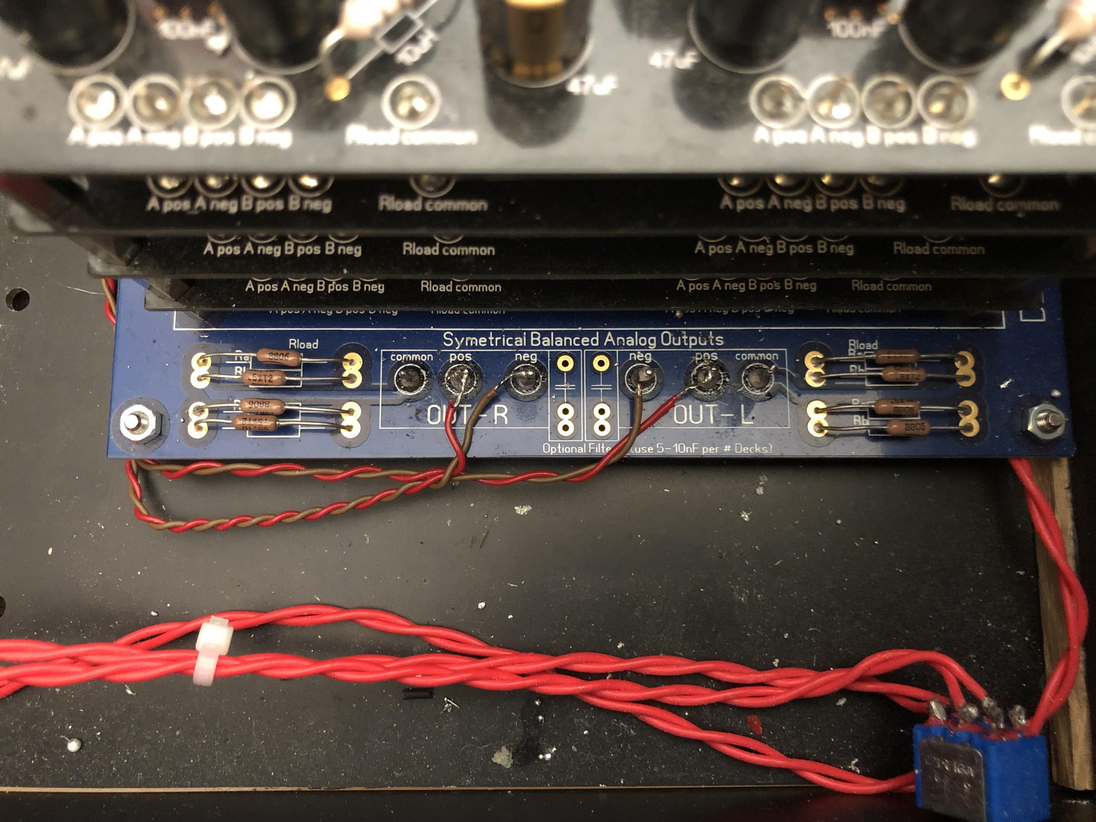

Maybe post a pic of the dac so it is possible to see wirings etcTransformers were wired correct: neg and pos from dac output to primaries
( wish the fault was so simple....)
The output of the transformers does NOT need to be connected back to the DDDAC common. That would be my first guess at what i going on. Typically the isolation of the transformer provides much less chance of getting hum. Check your wiring.
+1.
Maybe your signal output connectors (RCA, XLR?) are in contact to the chassis, which is at GND? That would connect the transformer secondaries to GND.
Outputs have been CAP connected last month, due to the noise isue.
This morning I replaced the rca connectors and wired in the transformers. Voila
Best guess : ground issue .

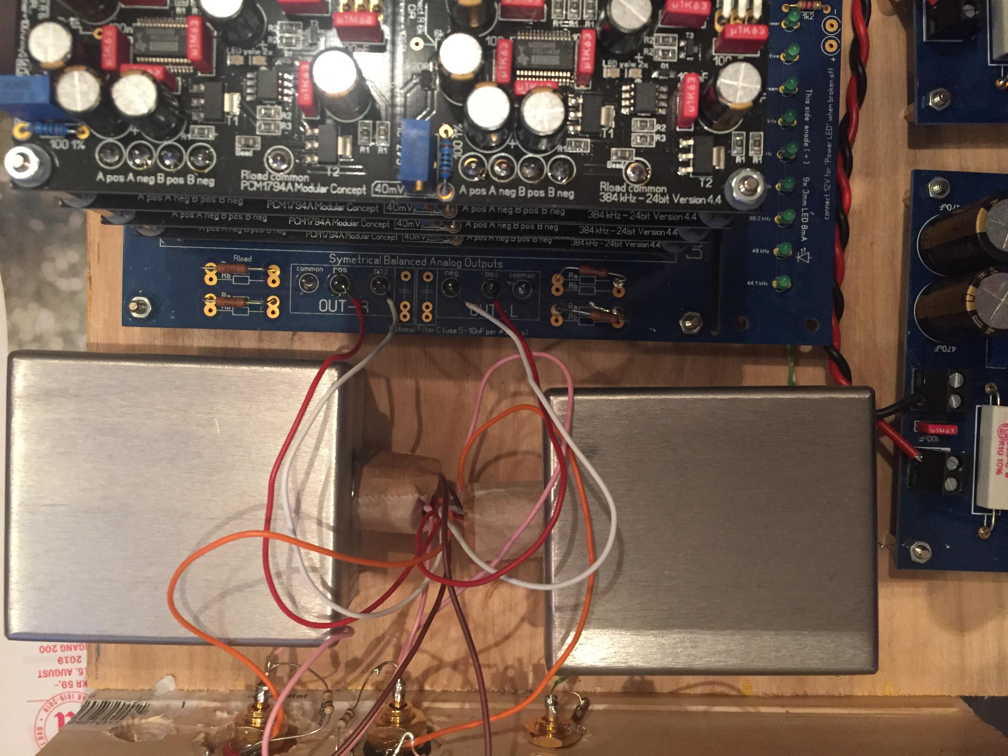

How have folks using Sowter 9335 TVCs wired them to their DDDac?
I presume that pos and neg from the DAC output go to the 9335 primary. What about 9335 secondary wiring? I need to drive a balanced power amp (AtmaSphere M60 OTLs) via XLR connectors. I presume XLR pin 3 negative goes to the fixed end of the 9335s and that XLR pin 2 positive gos to the output from the secondary tap selected by the volume switch, but I'm not sure how to connect pin 1.
Also my DAC is currently using Cinemag 15/15Bs through one of Enrico's buffer boards. Do the Sowter 9335s still benefit from the buffer board?
YES! The buffer provides a stronger signal to the xformers while allowing the DAC to function cleanly without seeing an inductive load.
You can always easily try it both ways.

The Sowters arrived today. They are now mounted, and playing fine. No issues.
IMO transformers need some time before they perform at it´s best, but so far I think the money was well spent.
The dac plays very well with caps, and if you don't try transformer output, nothing is to be missed. But, now it is no way back. Looking forward to enjoy the development over the next days and weeks.
