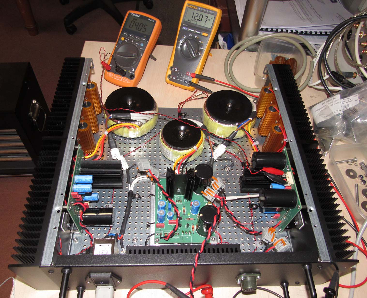

I'm building a DDDAC "clone". I use 12V linear pre-regulators to feed the Tent labs but with a 10 ohm resistor in series to drop it at 11V, a compromise between 12V that might be too much and 10V that might be OK but made me thinking of it all the time. The voltage across the 10 ohm resistor is 950mV so 95mA per tent labs' regulator and since there are two, 190mA per board. The digital section is no more than 50mA per chip depended on the sampling rate, so less than 100mA per board. I would say a total of 280mA max per board.
Hmm, thinking about PSU options... I know it sounds like blasphemy, but what about a simple off-the-shelf switching PSU? Those units are cheap, would be very easy to implement, and they are will easily provide enough current for as many DAC boards one can dream of. They usually provide surprisingly clean DC, and the sequence of regulators on the DDDAC boards might deal with the rest.
What do you guys think?
Borderline blasphemy fur sure, but as it's DIY, you should try!
By the way, regulating after a regulator is not a good idea.
Personally, I would properly heatsink Doede's PSU with a big transformer.
Or even better, draw a low-impedence filtered PSU (transformer followed by CRC or CLC) and let local regulators do their magic.

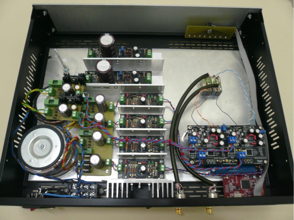

Alright. More DAC boards = more current = more heat dissipaton from the TIP.
What is a realistic limit for the number of DAC boards (given the TIP is fine)?
I am running 16 Pre Tent Dac boards with the power supply shown earlier. I used the TIP142 transistor bolted to the heatsink.
I used an Ohmite 63.5 mm heatsink for the rectifier.
For my next project, I want to run 16 Tent boards. I had another PCB made with large traces as I want to be able to run 4A continuous and keep the temperatures as low as possible, 50ºC max.

What is the current consumption of the Tent DAC boards? How many DAC boards can I run off the standard DDDAC PSU? Is the PDF doc on the DDDAC website correct?
The new Tent Boards take ~ 230-250 mA. So with the 1A standard psu version you can do 4 boards
if you beef this up with bigger transformer, and some more cooling, you can easily do 2 A and 8 boards for example
