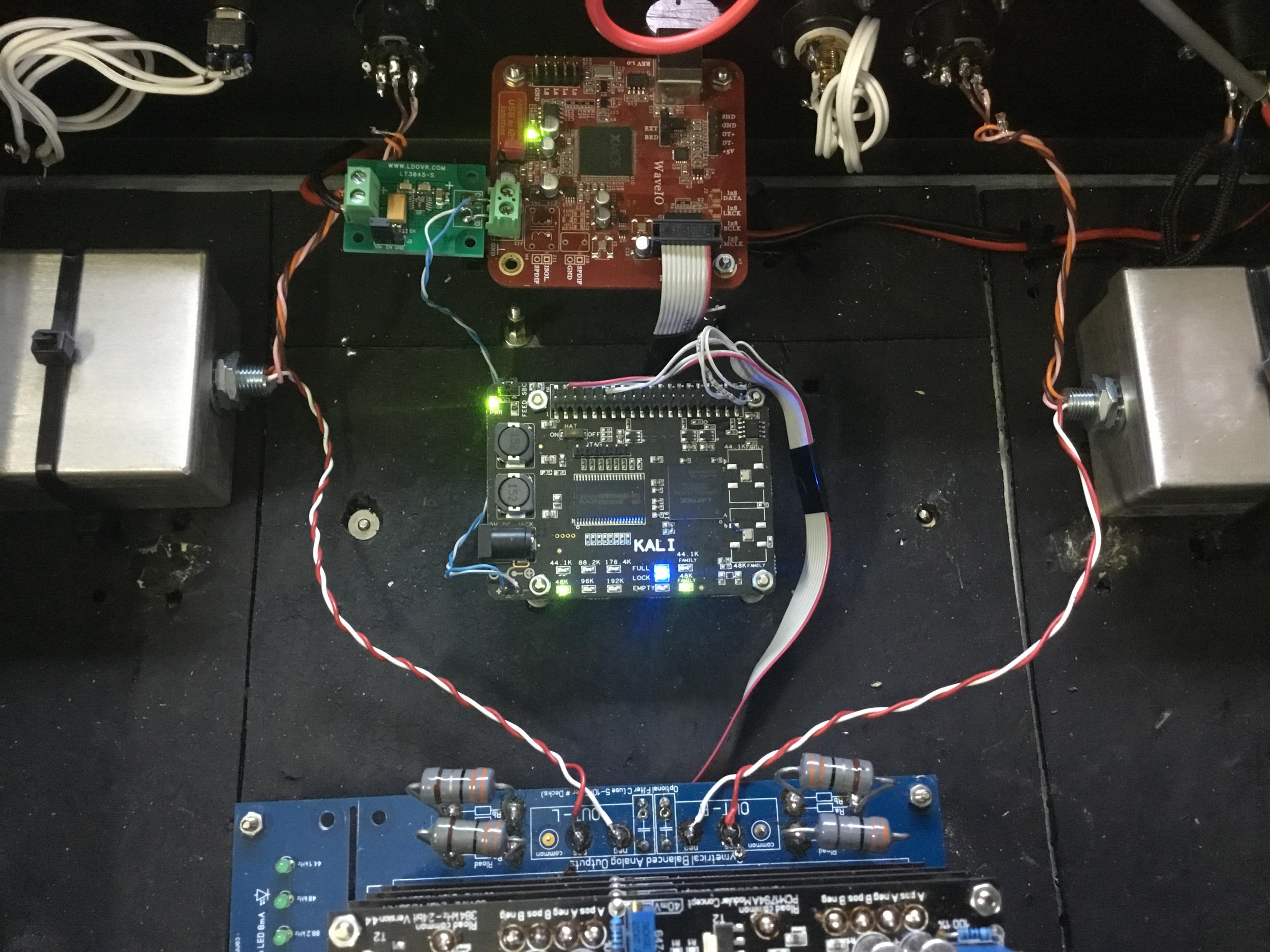

I am also using a standard off the shelf Kali board sandwiched between waveio and dddac. I’d also like to know how to mod the kali board with this better clock? Or is Kali now sold by deafult with the updated clock?
I have no idea about the Kali board you have to count on @Brumjam to tell you how he did it (I was just refering to his post)

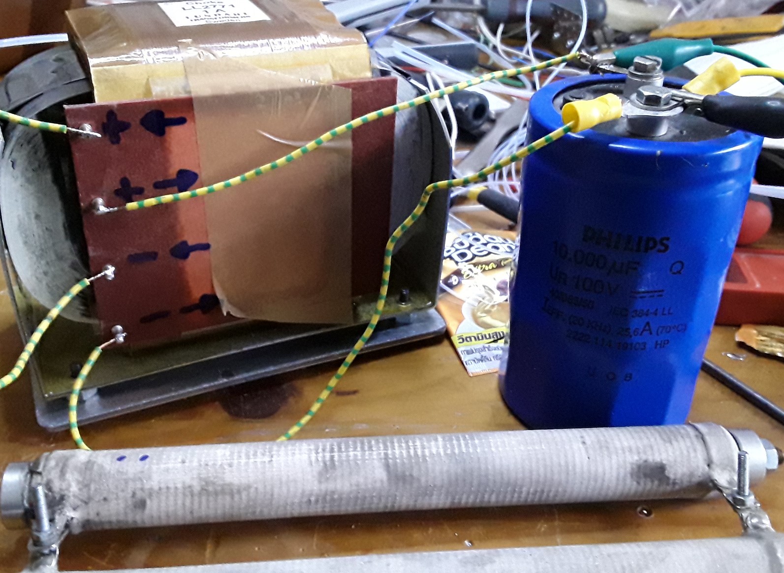

I have chokes and transformers for experimenting with PSU. I was thinking of raw LCL or replace the R-C-R-fuse-C network on the original PSU with LCL.
Can you tell a little bit about your findings regarding DDDAC 12V PSU?
Hello Norway,
There are not many chokes you can use for choke input for the DDDAC with 4 boards because it will have to handle 1A . Lundahl has the LL2733 that can take 1,7A and has 0,4 Henry. They can make it with smaller airgap so it can take less current but Henry will go up. Or you can use the one i use the LL2771 which can take 1A and has 3 Henry.
The LL2733 with 1A rating will have around 0,6 Henry. The LL2771 is about 40 % up in price compared to the LL27733 but the difference between 600 mH or 3000mH is big!!
It is common practice to use a so called bleeder resistor to create a minimum current through the choke . The higher the H the less current you need to bleed which is a good.
The LL2771 as choke input will create a big voltage drop so you need a transformer with quiet some voltage. I used a Lundahl heater transformer which had just a lot of 6,3 volts that i could put in series.
You could make a test set up with a 40 volt transformer and use a variac to find out the right voltage you need. Maybe i mentioned the voltage here in this thread or you can use psud. Depending on the diodes you will use ( i use the SBYV28 range) and if you will make it an LCLC ( which i use) you will probably need a 30 volt transformer. Split bobbin from Triad can deliver 1,6A sufficient for a choke input for sure!!!

I started with a 500VA R core LCLC giving around 12 volt output fed directly into the main print where the 7810 regulators are. Both chokes were LL2733. The first one 544mH with 1,25A current rating the second one 700mH with 0,9 A rating. The LL2733 can take that because there is not much ripple left after the the first LC.
Then i got a Lundahl transformer with 8 6,3 volts windings because i didnt know about the Triad yet. I think Lundahl 160VA
BUT i got the LL2771 3Henry to replace the first LL2733. Now i have got an LCLCLC. I had to add an LL1694 to create some extra voltage drop. Rather be safe than sorry. I didnt connect it yet because i have other things to finish but Doede did simulate the supply and says the attenuation of 100 hertz is higher than 200 db.
Greetings, eduard
P.s If have used choke input all over my gear and i am sure that getting an LL2771 with a small transformer ( i think 30 volts will be enough but you can simulate or try with a variac. I think with the 500VA i put 2*21volts in parallel and that was barely enough for the LL2733. In the photo you can see the the LL2771 inside my DDDAC and the LL2733 in front. Doede was surprised so see these tiny diodes but that is possible because the choke causes a nice steady current draw!!!

The SDA clocks were purchased separately. I removed the original NDK clocks and replaced them with the SDA versions. Make sure you buy the same 22 and 24mhz versions, otherwise your music will sound like Mickey Mouse on helium.

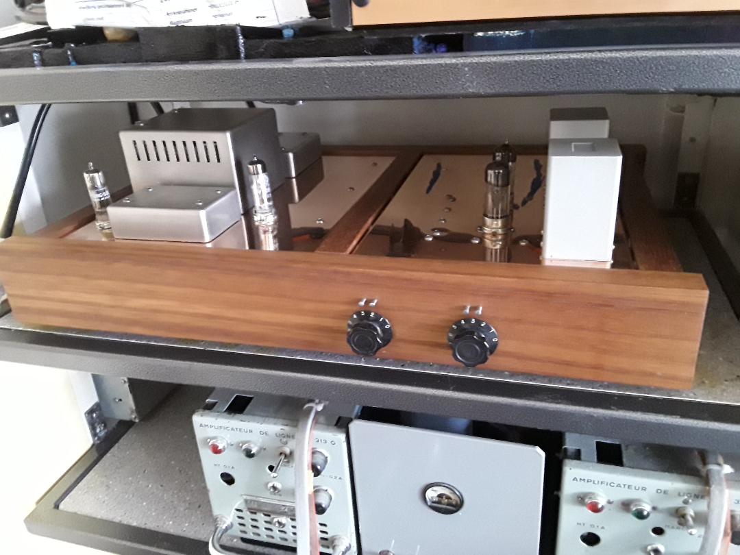

Photo is my latest tube line pre amp which needs to be finished before judging my bigger choke input DDDAC power supply.
Someone here was looking for some '' tube decoration '' on his DDDAC. you could use a VR tube. Doesnt need a heater just some high voltage and gives a nice glow.
