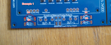

Hello,
I have too much background noise on music recrorded on low volume and I think the output level from my DDDAC is to high. (The treble sometimes become saturated)
Compared to my previous Dac, I have to diminish the volume almost by half on the amplifier.
I have a 4 board dddac with the cinemag on output. I placed 4 34 OHM resistors on the 4 spots dedicated as described on the image provided. (Thanks to the advice of eduard)
Should I increase the resistors on the DDAC RA rload places or between the dddac and the cinemags to reduce this problem?

your i/v resistor choices look correct to me. it would be good to check the dc offset on your outputs at the mainboard. If you measure the dc voltage between pos and common and also between neg and common you should see approx 2.7v
Also, is this a totally new DDDAC? because finding the treble a little harsh can be due to it needing to be run in which can take quite some hours! This was not so much a problem with the previous dddac design, but with the new one, there's definitely a 'breaking in' period needed. I guess this is due to the CCS on pin 20.
I made a test of the output voltage of the DDAC, I get 2.785 volts. As it is not far from the 2.7 volts value I suppose this is not why I get this so strong and sometinmes saturated in the treble.
I would like to try listening without the cinemags. Is it safe to connect my RCA connectors to pos and neg without using a 2.2 capacitor for testing purpose ?

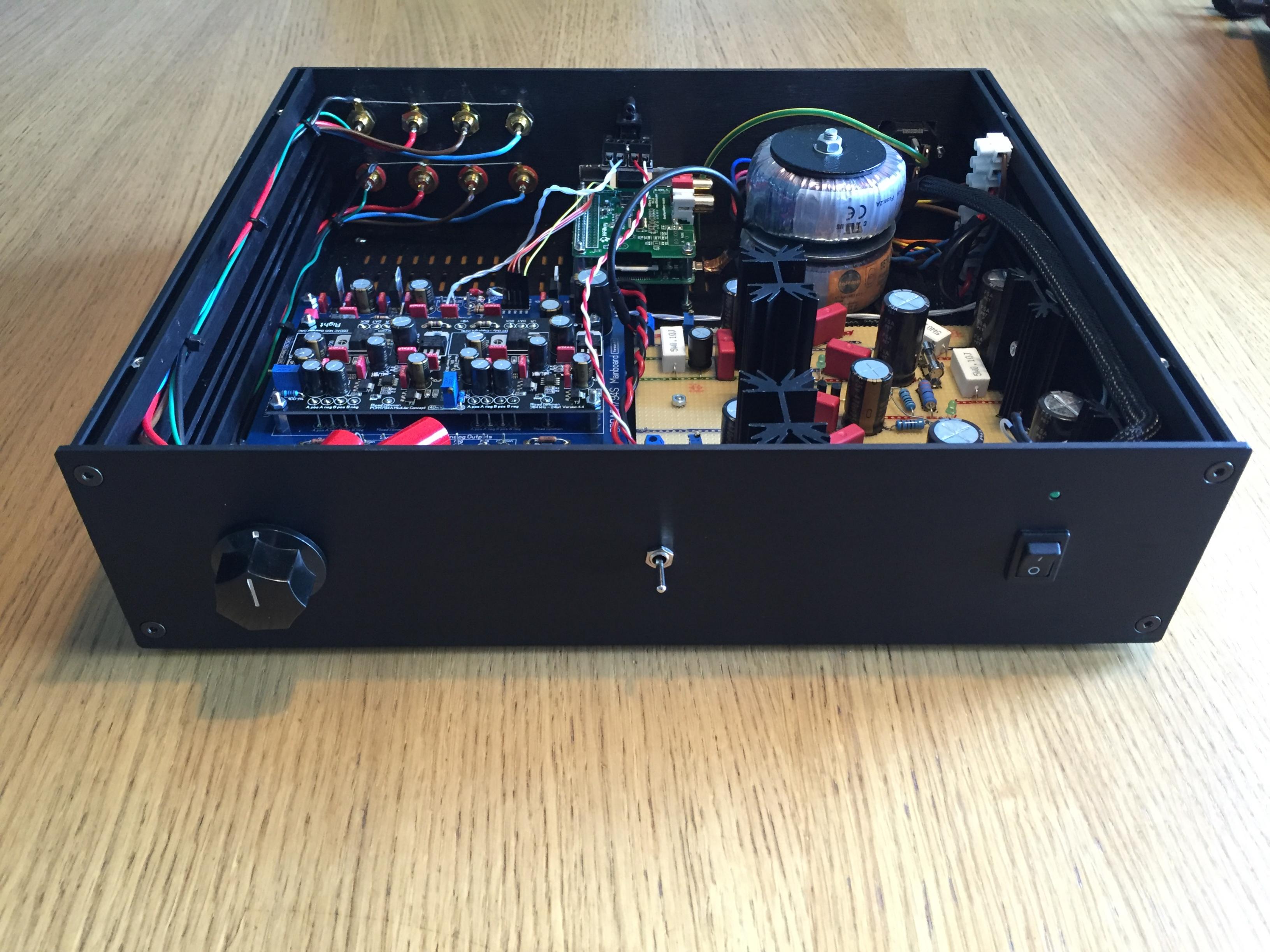

My DDDAC continues to evolve. It's now part of a two-box DAC/streamer project. The power supplies are in a separate box. I've recently changed my old DAC board for the new one and changed from Charcroft to Rhopoint I/V resistors. I was late to the party with Ian Jin's FIFO project, but it has transformed the sound of my system. This is a superb set of boards which really lets you hear what the DDDAC is capable of.
James

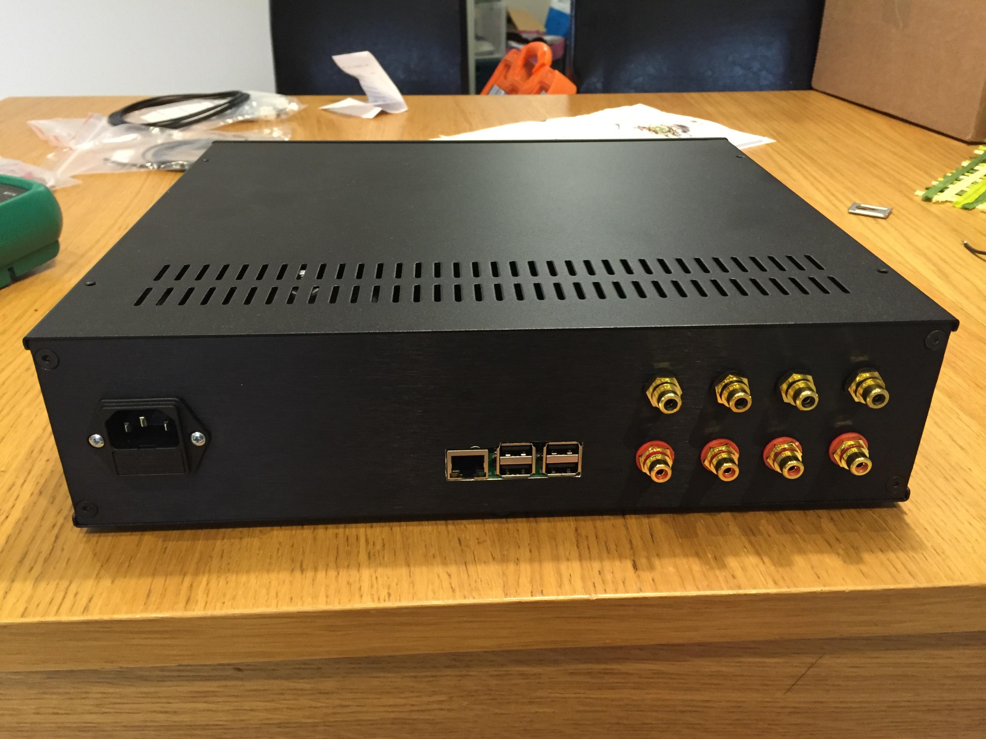

Just to Jeep the thread alive... Here's few pics of my humble single board DDDAC/Raspberry/Hifiberry/Moode Audio media player. I made the 5 V and 12 V power supplies according Doede's schematics to a perf board. Source is Raspberry pi 2 with Hifiberry DAC+pro which is working as a i2s reclocker and is connected to DDDAC via i2s. Not fancy on the outside, but the sound is great. Oh, and I just recently added a toslink to coax transformer board and new I can use toslink sources as well.
Edit: Hmm, I can add only one pic as an attachment. Maybe it's because of my iPad?
