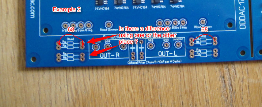

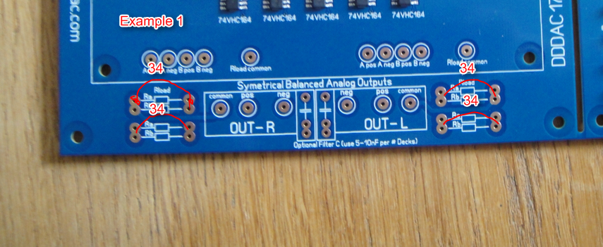

Right now I am trying to figure out how I should solder the resistors on the mainboard knowing I have a 4 dac board configuration (the old version baords not the new Tent ones).
From the DDAC site I see I should use 68 OHMs for RA load and 68 OHMs for RB load. Can someone enlight me on how I should do on the mainboard itself. Should I solder 4 34 ohms resistors like in example 1 or only two 68 Ohms like in example 2??

Replace each 33 ohm resistor with two 16 ohm resistors in series and take the output from between the two 16 ohm resistors. This will reduce output by a factor 2. You can use different values in the voltage divider to get different attenuation, but make sure the sum is close to 33 ohm. Otherwise the bias if the DAC chips will be off.My fault,,remember wrong..it is 33ohm all resistor

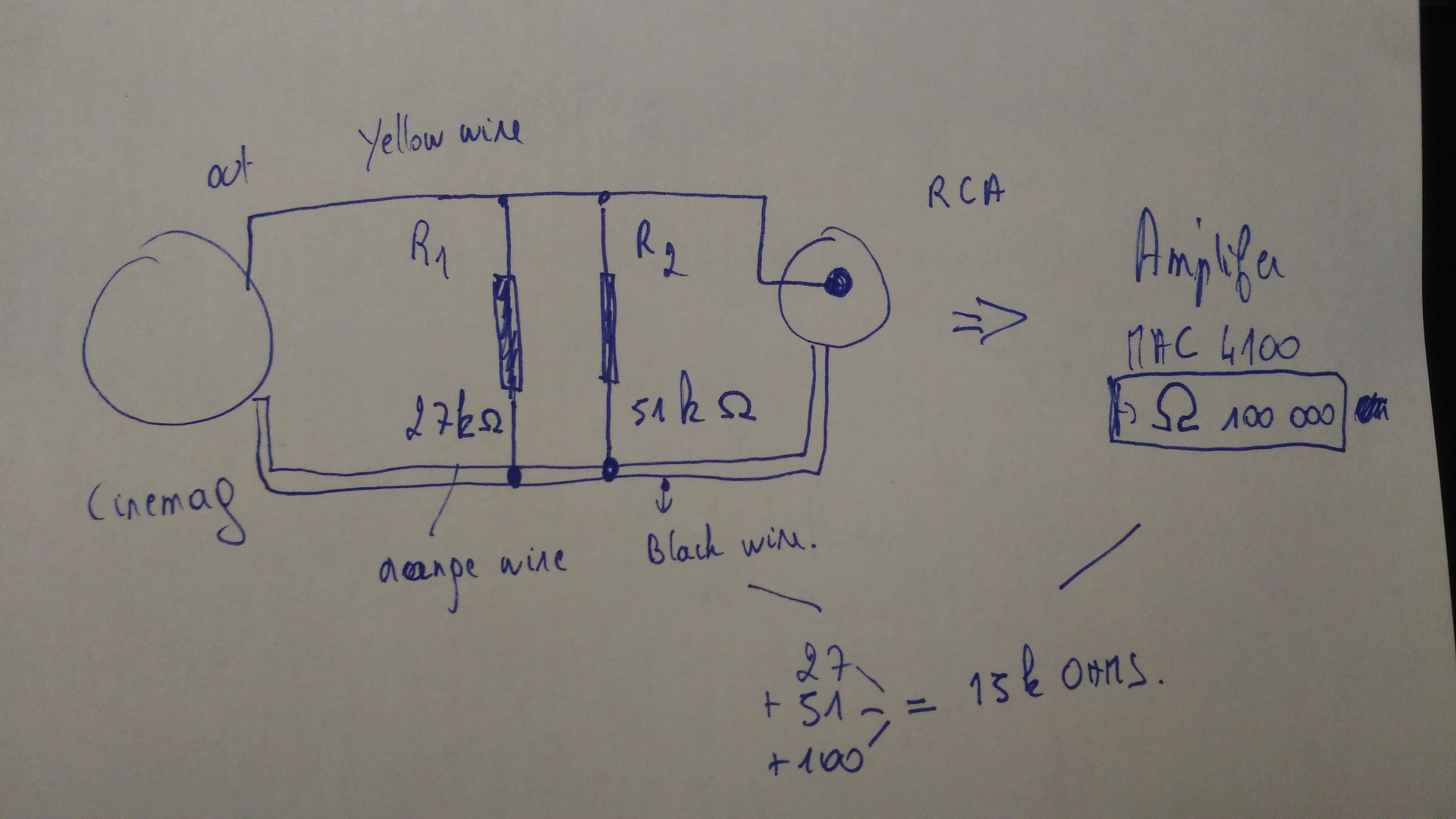

Finalising the understanding of the ddac soldring (I hope) I found the information about the cinemag wire setup.
As I learned the output impedance should be 15k Ohm (shared between the amplifier and the cinemag) I have to add the correct load.
My amplifier : A Mac 4100 has a input load of 100000 Ohms. If I add a 18K resistor between the yellow wire and the Orange black one of the cinemag I will land at a total resistor of 15.25K. Would it be a problem or should I do the maximum to get precisely 15K in total (like the drawing with a 27k and a 51k resistors in parralel)?
