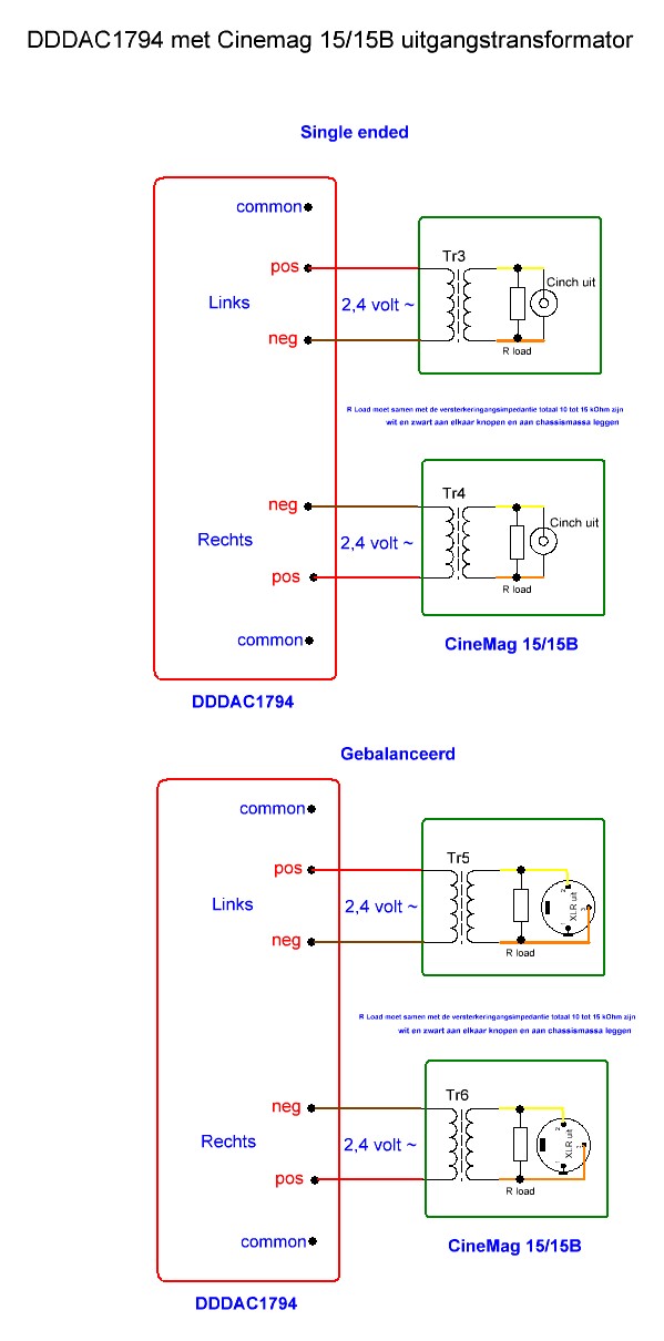

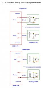

Can any one give me the connection schematic diagram for putting in the Cinemag transformers with the DDDAC? I have the older motherboard (RED) one. In case there are any specific things to keep in mind while making a change from capacitors to trafos.

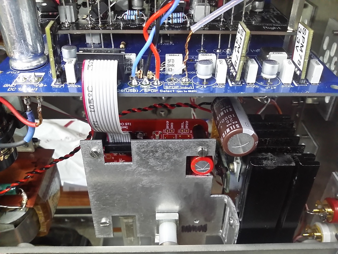

I have been thinking about a modification to the motherboard. Now the big cap on the motherboard supplies voltage to the regulators on the small boards and the 3 regulators on the mainboard.
I already did change the 3 on the motherboard into the ones from Belleson. Now i want to add an LC network after the big cap, cutting the traces to these regulators to they can be '' supplied '' by their own cap.
Because of limited space in the area near the big cap i can not put a choke with dimensions of the Lundahl. The belleson regulators each have their own bleeder resistor because there is a minimum current to make them work perfectly so total current going into the motherboard power supply will be close to 60 mA.
Doede told me it could be a nice improvement and Brian from Belleson told me to use the lowest dcr choke ( do have 500mH,30ohm,300mA and 1000mH,40 ohm, 240mA hammonds in the attic) from the ones i have in stock. 500mH would already filter a lot. Have some Black gate 100µF N type i could use after the choke. The hammonds are small and can be mounted on the motherboard using one of the mounting holes on the board that are not in use because my boards are mounted onto the chassis using the holes in the smaller boards.
Greetings, eduard

Thanks Arieson. I was also able to get this diagram off of creative's website. I was just checking in case there are any additional pointers that I need to bear in mind before starting working on this change.Yes we can...
Yes we can...
How and where do you (not) connect things to chassis / GND?
And can someone please translate the dutch comments?
