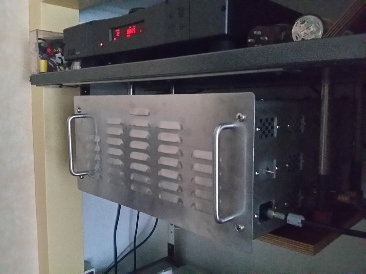

I am going to declare that my DDDAC journey is now over 🙂
30 Dac boards total with the following alterations:
All electrolytic capacitors Nichicon Polymer FPCAP 50v as I leave the Dac powered up permanently.
The 6k pin 20 resistor is a Charcroft S102J 0.1% for stability and low noise level.
I had a pair of 1-1 Sowter transformer made as I do not need the high output voltage and probably gained a little but of bass slam into the bargain 🙂
The IV conversion once again Charcroft resistors are the CE-VSR6 for the extra dissipation.
I was hoping for 32 Dac boards total but I fell foul of the I2S maximum length rule ... so 15 standard boards each side seems to be the maximum.
I did try the Tent powered boards at the top of each stack but the I2S problem reared up again so off they came and replaced them with the standard ones and all is OK.
It would be an interesting experiment to see how many Tent boards could be driven by the main board but I really must stop somewhere.
Only thing now is the fact I have one Blue main board, two powered by tent Dac boards built and tested and current source set at 40mV, and a pair of the standard Dac boards going spare ...
Also have my original 16 standard board DDDAC with an uprated power supply although it is SPDIF only as I used the WaveIO board in the 30 stacker ...
Was it worth the longs journey ?
Hell yes , I have never heard reproduced music so lifelike and I am only using SPDIF.
By stacking the boards, the stereo image just gets better the more stacks you put together.
The stereo effect now is just as good as pair of expensive headphones, it seems to lock all the sounds together into a coherent whole and provide a solidity to percussion that has the be heard to believe what is possible.
The USB is working fine so now I will have to experiment with Hi Res but I am very impressed what 44.1 sample rate can do with a top flight Dac.

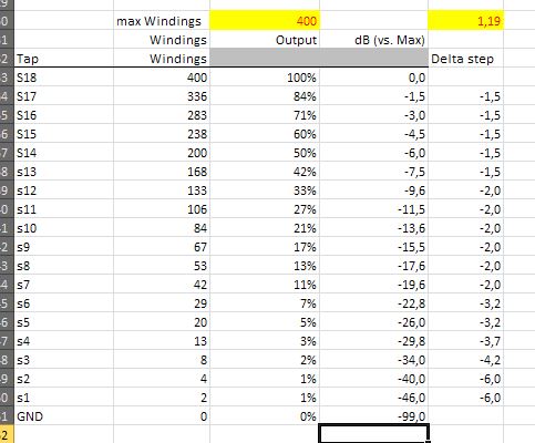

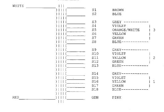

I am still using the (special dddac) Sowter Transformers with taps at the output. So being a TVC

Check the pdf, I think it tells it all.
Every tap stands for a number of windings (my spec) which than delivers a different ratio for the input/output voltage. It is designed so, it is a ladder with certain dB steps which make sense as a volume control.
Normal pots or rotary switch volume Controls have the significant disadvantage that in the middle volumes the output impedance is relatively high which is not good driving cables (RC filter)
With a transformer this is of course NOT the case. In fact at every step of lower volume the performance of the Transforming ratio increases thanks to less windings. Output impedance gets also lower with every step. VERY good for driving cables.
But maybe it gets to technical again, sorry…
