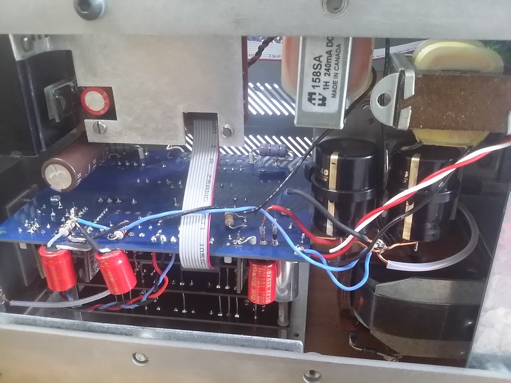

Hello,
Did install some black gates and chokes to make 2 extra LC filters. One for the Belleson 5 volt regulator and one for the pair of Belleson 3,3 volt regulators.
Did not have enough space to mount a third choke so did go for two BG N types connected as what BG called a super E cap. For the 5 volt regulator i used just one. Not enough space to mount a second cap there.
Greetings, Eduard
Hello,
Greetings, Eduard

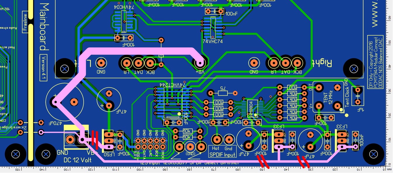

hello
Hello,
Some people say the shunts work better with an LC , CL or LCLC power supply. BUT the new dac boards have a 7810 as a pre regulator for the shunt.
If i remember well Doede told me with 2 purposes safer input voltage for the shunts and better sound. I never did remove them so i just believe Doede. AND it is a hell of a job to remove them in my situation!!.
I never did compare the standard regulators on the motherboard with the Bellesons i just start using the Belleson from the start.
NOW all the power going '' up '' into the small boards is coming from a 1000µF 25 volt Silmic on the mainboard. This caps is fed by 2 mundorf 10000 µF caps which are just a few inches away from the mainboard. My latest mod was to use these mundorf caps as a starting point to connect two small chokes followed by 100µF Black gate caps. The negative terminals of these caps are connected to the mundorf neg terminal. Adding these 2 LC filters ( one for 5 volt Belleson and the other one for the 2 3,3 Bellesons) is sure an improvement. more spacious sound and most important the sound does not get strident during dynamic passages. ooh one more voices get a vocal chord.
Maybe because i still use cd the regulators on the mainboard need extra care?
Will get an aurender when i have more time.
I already use pps caps and some oscon.
Also have a 1µF pps cap for the one near the Tent clock but did not install it yet. Someone else should try.
Greetings, Eduard
Greetings, Eduard
P.s Of course LCLC is also kind of pre regulation. I decided to go choke input because all my other devices use shunt and choke input too.

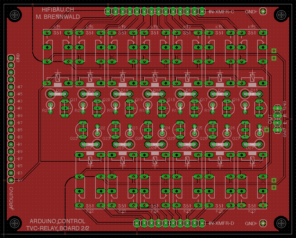

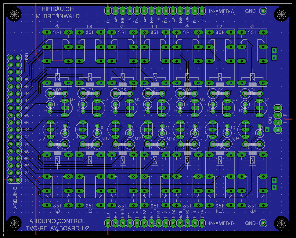

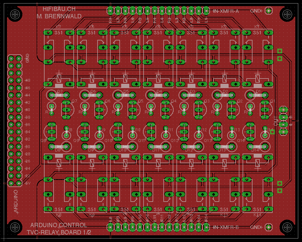

I am in the process of building a TVC control with 27 relay switches that are controlled by an Arduino microcrontroller. ... the whole thing is intended to live on two PCB "decks" that are stacked on each other, and are plugged onto the Arduino.
I am currently waiting to receive the first PCB boards for the firsd "deck" that will deal with relay switches 1-14. Once I get this working, I will finish the second board.
Okey, the prototype of the first deck is working nicely! The board design is not yet perfect, so I made a few changes to the connector and parts locations.
I received a few messages indicating interest in those boards, so I attached a pictures of the revised design (both top and bottom deck). Let me know if you have any comments or suggestions for improvement (red is top layer, mostly audio signal routing; blue is bottom layer, mostly relay control).
