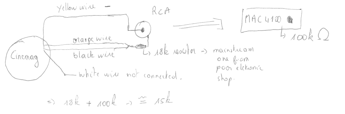

Hello guys,
After a few weeks I am still a bit disapointed with the sounding of the DDAC 4 (old) boards with the Cinemag transformers (too flat for me, treble to harsh).
I want to try with some "capacitor" as described on the DDAC site for which it is written : "The standard Mundorf capacitors I deliver with the Kit are very reasonable compromises.".
As I didn't get those capacitors with the kit I buyed from the audoi creative shop can any of you point me to some good examples of capacitors I could try that don't sound too harsh ?

Lobotom1,
I have a single board original 3.0 DDDAC with the Cinemags and the sound is not harsh. The Cinemags need a resistance load of 8K-15K to sound right. If the load resistance is 47K or higher the Cinemags will sound harsh in the treble. If your preamp has a high input resistance then you need to add resistors from your Cinemag RCA outputs to ground so that the combined parallel resistances of the preamp input and the resistor you add fall in range.
The other Cinemag tweak is to add a 150pf cap such as a WIMA FKP2 from the RCA outputs to ground. The SQ change is more subtle, but it sounds better to me and others.
If you get rid of the harsh sound but the sound is still flat, you need to add a buffer between DDDAC output and the Cinemags or start stacking up DAC boards. I can help with the buffer.

Carlsor I am using already 4 boards so I suppose a buffer is not needed. About the resistor I think I did it properly based on this forum : 18K resistor between the black + orange wire to the ground RCA to compensate my Macintosh 4100 load impedance of 100K.
I will try the 150pf cap solution,would it mean adding this capacitor to the orange, black wire after the resistor or before it ?

Michl2604,
You are right I made a mistake in the diagram, the rload 18k is connected betwwen the yellow wire and the two (black & orange wire) on the other side, the two poles of the resistor is then connected to the RCA - & +.
Is the quality of the resistor important for such setup ?
I use a 10K LDR load resistor on my Cinemags which feed a 330K preamp input resistor. I have a switch for turning off the LDR resistor for use with 10K input devices. At a friend's house I heard the Cinemags play into a 100K integrated tube amp with no additional load resistance and it sounded like fingernails scratching a chalk board.
Because 10K is the "sweet spot" of Cinemag loading, I recommend that you use 12K load resistors. I am a believer that that quality of load resistors matters. Dale RNXX resistors are good enough to prove that load resistors solve your harsh treble problem. I like Caddock MK-132 or TF020 resistors for line load resistors. The LDR sounds great, but needs a current control circuit to work, but I rarely take the simplest route in HiFi projects.
