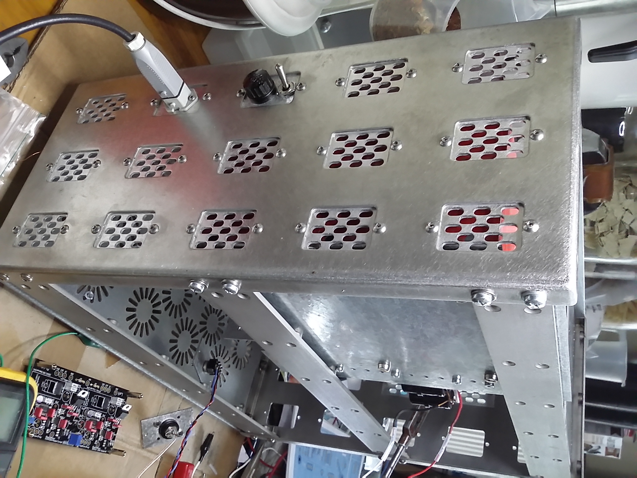

Did complete on side of my dddac chassis. As you can see 230 volts ac input with hirschmann connector, toggle switch and fuse holder. A 2 A slow blow fuse working perfect with my 500 va R core probably will not work with a toroidal one.
Does anyone know if there are neutrik available that will using this kind of connector to be connected directly to the wave io circuit board. It looks more sturdy and reliable than using the rather flimsy USB port soldered onto that little circuit board.
AND it will look nice because I use neutrik for the bnc input as well.
Greetings, eduard

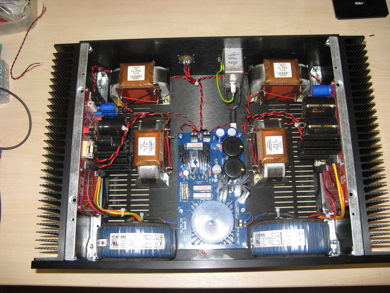

What is your approach to run the 32 decks? are you using some buffers/drivers for the I2S (like Doede used for his TDA1543 project)? Probably connecting the I2S wire all the way to the 32 decks will case problems (?!).
What do you plan to use for the main PSU?
Best wishes
I have tried and failed to get the 32 dac boards to work. It was too much for the I2S delivery method.
I tried with a 74HVC125 ( Thank you Doede) then a SN54ALS1034 buffer to no avail, so I disconnected the top 2 boards which now works fine.
So 2 banks of 15 dac boards work very well 🙂.
The power supply is a separate beast using the DDDAC power supply boards, 1 per bank of 15 but with Choke smoothing, Mundorf 10000uf smoothing caps and a TIP142 transistor bolted to the side mounted heatsinks.
Wave IO has the DDDAC power supply but with the 10000uf mundorf`s and Vishay 136RVI 470uf caps.

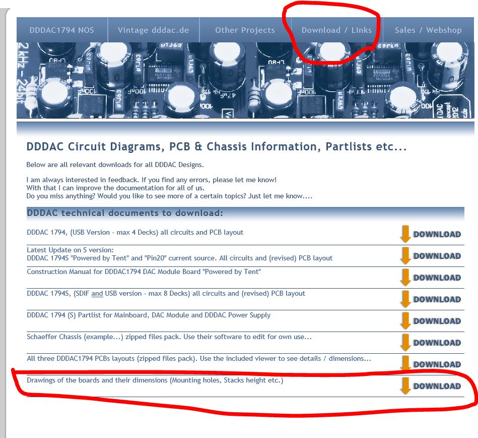

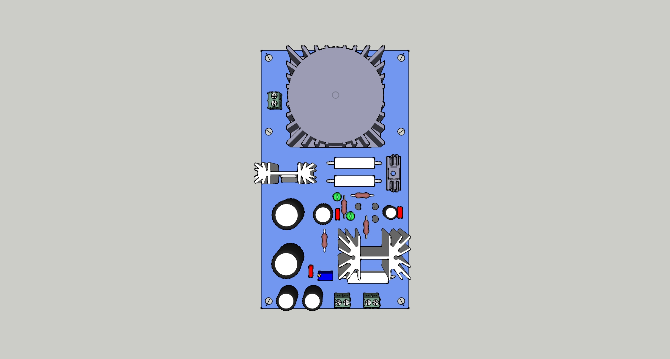

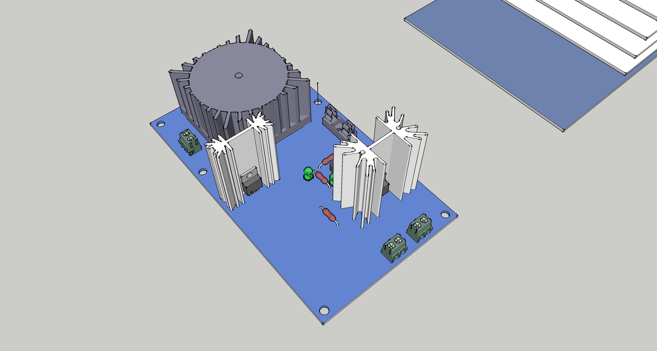

So, I started making sketchup models of the boards. I am finishing the first board (PSU), and I am wondering if I have the correct measurements for the mounting holes.
From what I can see the holes are 5mm from the edge to center of the hole. And the "middle" holes are 55mm from the edge on the trafo side. Am I correct?
The models will be uploaded to the sketchup 3dwarehouse as soon as they are finished. The name will contain "WIP" untill I am happy with it, then the "WIP" will be removed from the name.
Nvm, I found the "hidden" PCB dimentions file.
