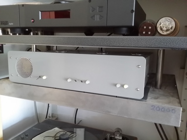

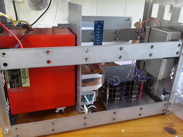

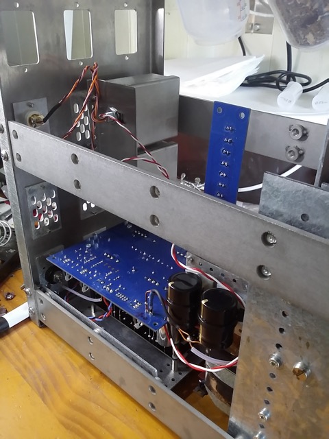

Today i did finish the dddac output wiring. Tomorrow will buy some wood to replace the support of my present dac because the dddac has some extra height. Now weight without front plate is around 32 kilogrammes and it is on the some height as my head so i must take care choosing the parts surrounding the wave io but that will be just a samaller r core and two chokes and some aluminum to support these so probably will end up around 40 kilo.
Maybe i have to do a warming up before lifting it that high.

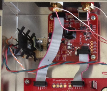

I use the 2amp Belleson 5V Vreg located right at the input terminal block of the WaveIO. See picture below. I made up a perfboard. I measured a load of about 450ma. I supply it with 7.5V from a 6.3VAC filament transformer with Schottky diodes and filter caps so the Belleson has to throw away 2.5 Volts of heat. A 12V supply would mean 9.5 volts of heat to dissipate which would require a HUGE heat sink. I thought I heard a SQ improvement from the Belleson here.
I also use Bellesons on my red main board and SPMs for the 3.3V digital sections of the DDDAC board which also sounded better to me. I asked Belleson if this Vreg required a minimum load to give the best regulation and they said YES - minimum of 10ma for the SPM. The PCM1794 uses much less than 10ma digital power so I added a 300ohm load resistor to increase the load which I thought also sounded a hair better. Maybe the standard LM33 Vreg would sound better if it had a 300 ohm load resistor.
I highly recommend Belleson for digital circuits.

I wanted to use the same idea for supplying the 5 volt to the wave IO. I think current drawn also depends on the sample rate so that is why i also wanna use the 2A model.
I think using long cables between the regulator and the circuit could harm the benefits of the regulator.
I did ask Belleson if a choke input power supply would be benificial for this 5 volt supply. On their website they write no preregulation is better but then a bigger cap could also be seen as some kind of regulation .
I will wait for their answer.
Of course the LF50 and LF 33 also have a LCLC supply at the input shared with the 12 volt needed to supply the 10 volt regulator which feeds the shunts.
Does the heatsink for the 5 volt has to be that big after all you are not waisting a lot of voltage across it?
