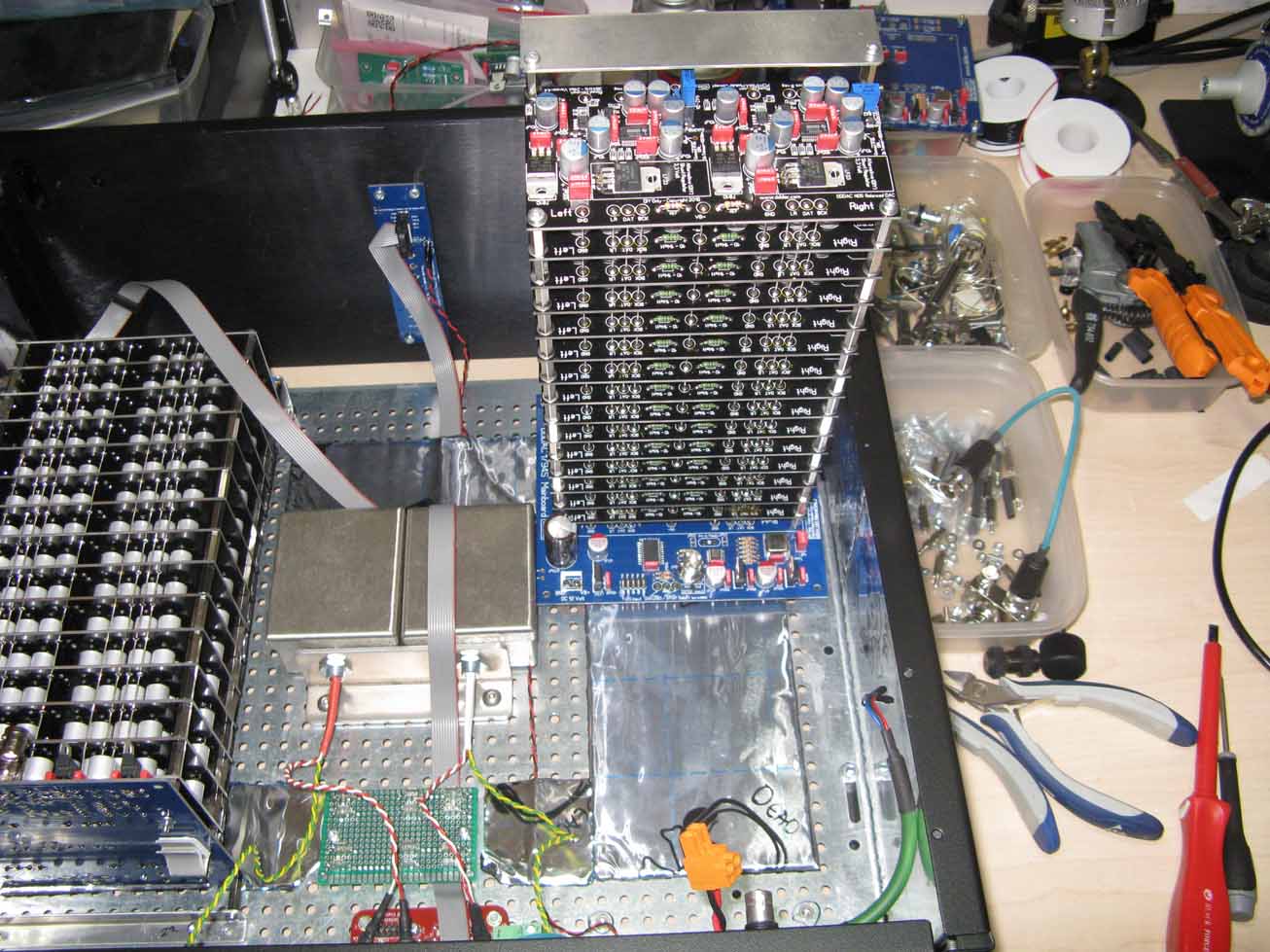

I tidied some of my wires up this week and tried to make things a bit more proper and permanent, so it started like this
And this
Then
Closely followed by (mainboard reg output detached)
And (ignore the silly massive gold resistors, I guessed the spec wrong and had to dig in the spares temporarily)
With a few new data wires
And a bit of standoff jiggering
And I've made it all fit and I can (in theory) now close the lid(s) for the first time in about a year should the need arise...
Sounds pretty good too 😉 quite a step up from the level of detail I've heard from a dddac before. So that's without any of the dddac mainboard data signal processing, just a reclocked signal direct from the Cronus to as close to the DAC chips as is practical. The mainboard is only there to hold the i/v resistors for the moment.

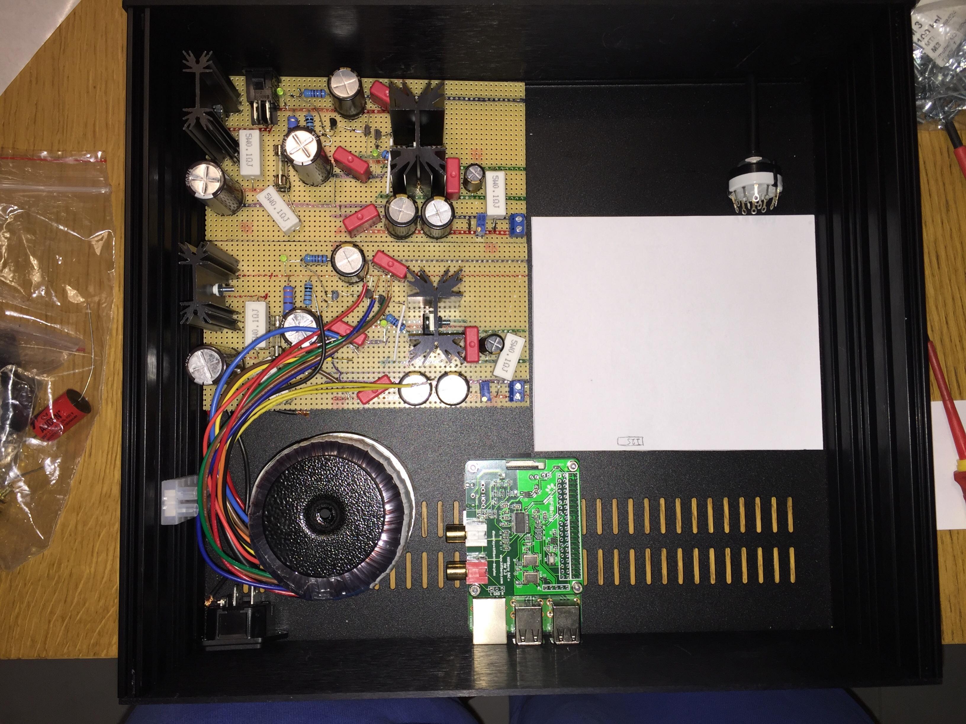

Here's my planned layout for DDDAC implementation with one DAC board (Tent shunt version). The source will be a Raspberry Pi 2 with Hifiberry DAC+ pro connected via I2S to DDDAC. The peace of paper represents the DAC-board as it is still on it's way to Finland.
I've built the DDDAC power supplies by myself on a piece of perf-board and the two toroidal transformers are stacked on each other. The front plate is on top side and the rear panel is in the bottom of these pics. There will be selector switch in the front to choose from 4 outputs (Active monitors, headphone amp, two spares). Also a power switch will be placed on front panel.

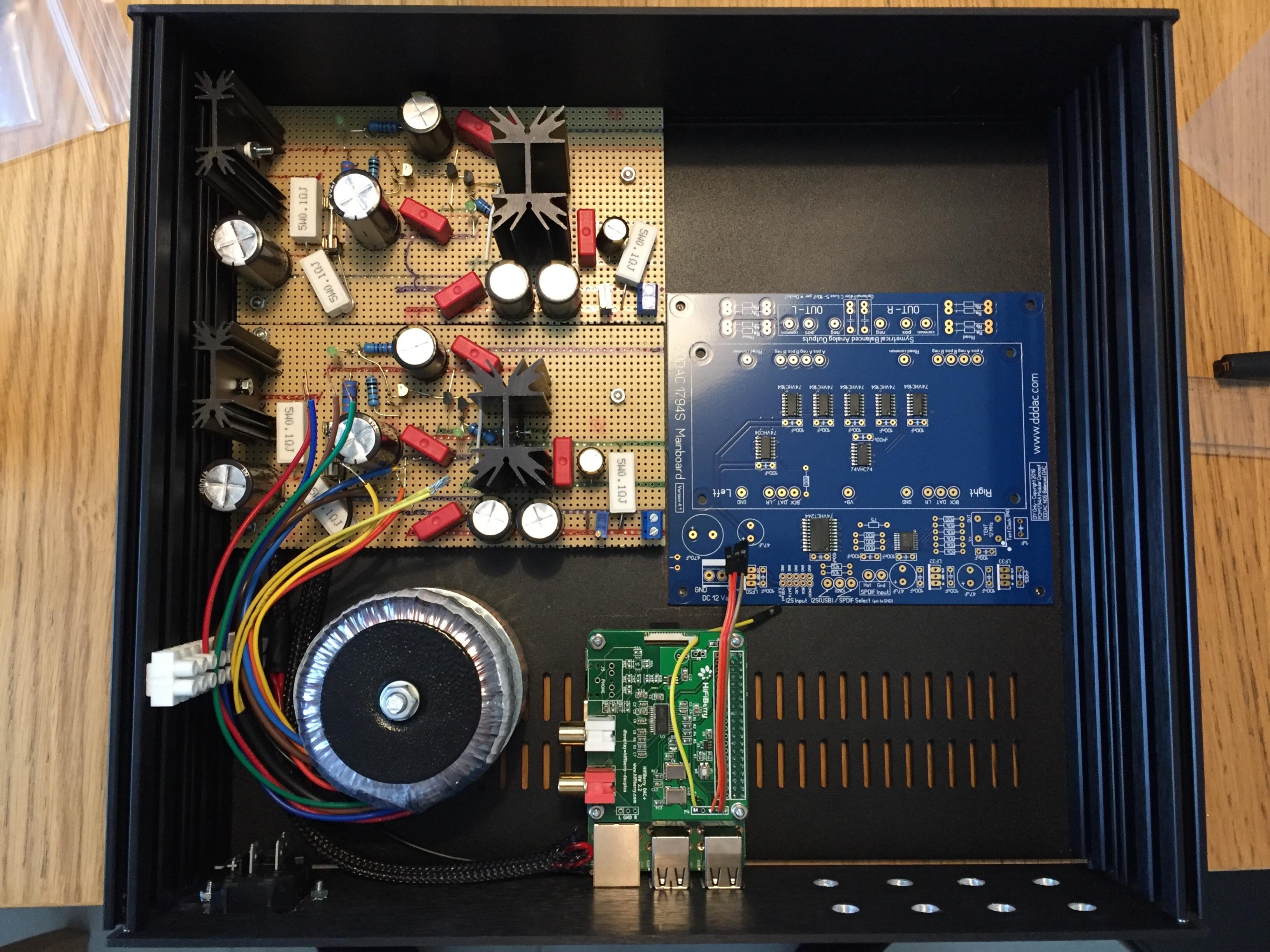

Wohoo! The dac boards arrived today. It seems that my layout might actually work. I drilled the holes for Raspberry and bolted it to the base plate. Still need to make holes for Raspberry's USB/LAN connectors to back plate and for power switch/output selector to front plate.
