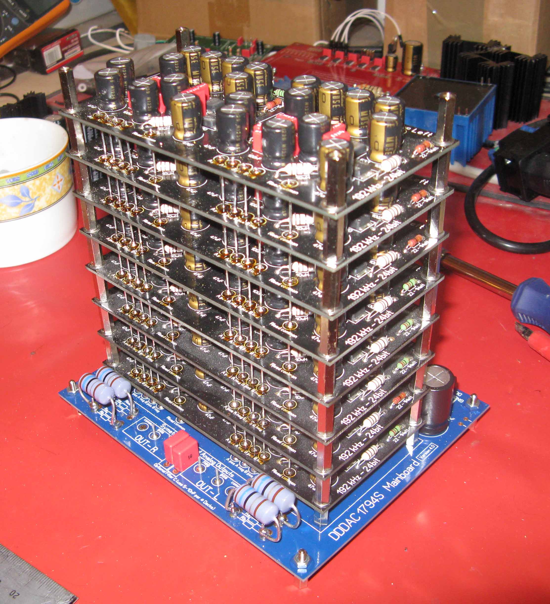

With the new resistors fitted, what do you measure in ohms between pos-common and neg-common?
Sry James.
It's possible I remember wrong about the voltage with the four tantalums, more likely it should be 0.8 v. Since the sound level is to low. ( can't check, they are unsoldered now)
The four tantalums are replaced with the eight dale resistors and everything is fine. Great sound and measuring 2.7v, common-pos, common-neg.
It seems that in my dac with 8 boards, for some reason 4 resistors will not work.
I wonder why ?
Ps; I used four boards with four 33ohm resistors, without any problem
Later on this afternoon I will power up, adjust the current source and have a listen

I would get the meter out and have a measuring session to find out what is going wrong.
When I ran 8 dac boards, I used 4 off Shinkoh 2w 16R and all worked fine. Have you got the red or blue main board, I failed to get 8 dac boards going with the red board ....
@Smooth Dancer:
I think I have a possible explanation for you:
With eight boards you have twice the current Running throuh
The resistors. So if you Running 1/4W resistors you might
Touch the power Limit. You could use 8 resistors instead which
Doubles the Max power.
Regards
Michael

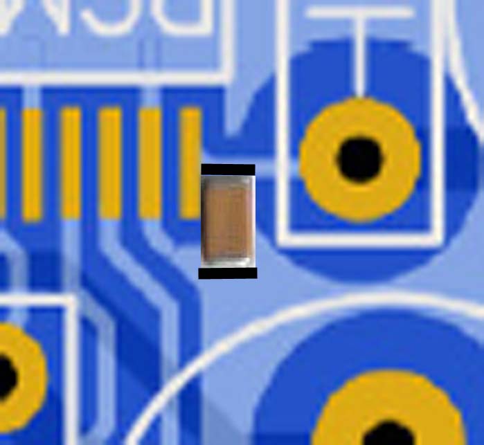

Ok, so I know I've crossed the line from modification to bastardasiation, but this week i got some of these
100nf c0g smd capacitor in 1206 size to replace the Wima film caps
Scratched some points through the solder mask onto the copper underneath to solder them in (this is a test on a spare board)
Got the tiny soldering iron tip, the solder paste and the jewelry loupe and had a play like this
What a fiddly job!
This is probably a little above the limit of my soldering skills but I got there in the end and did loads of continuity testing to be sure I had no shorts
Well I'm pretty pleased with the results. With this and the Cronus giving the reclocked right justified signal the sound is really open and natural. Textures are really obvious and floaty ambient sections are really airy. Lovely 🙂
Thanks again to jptz for the inspiration 🙂
