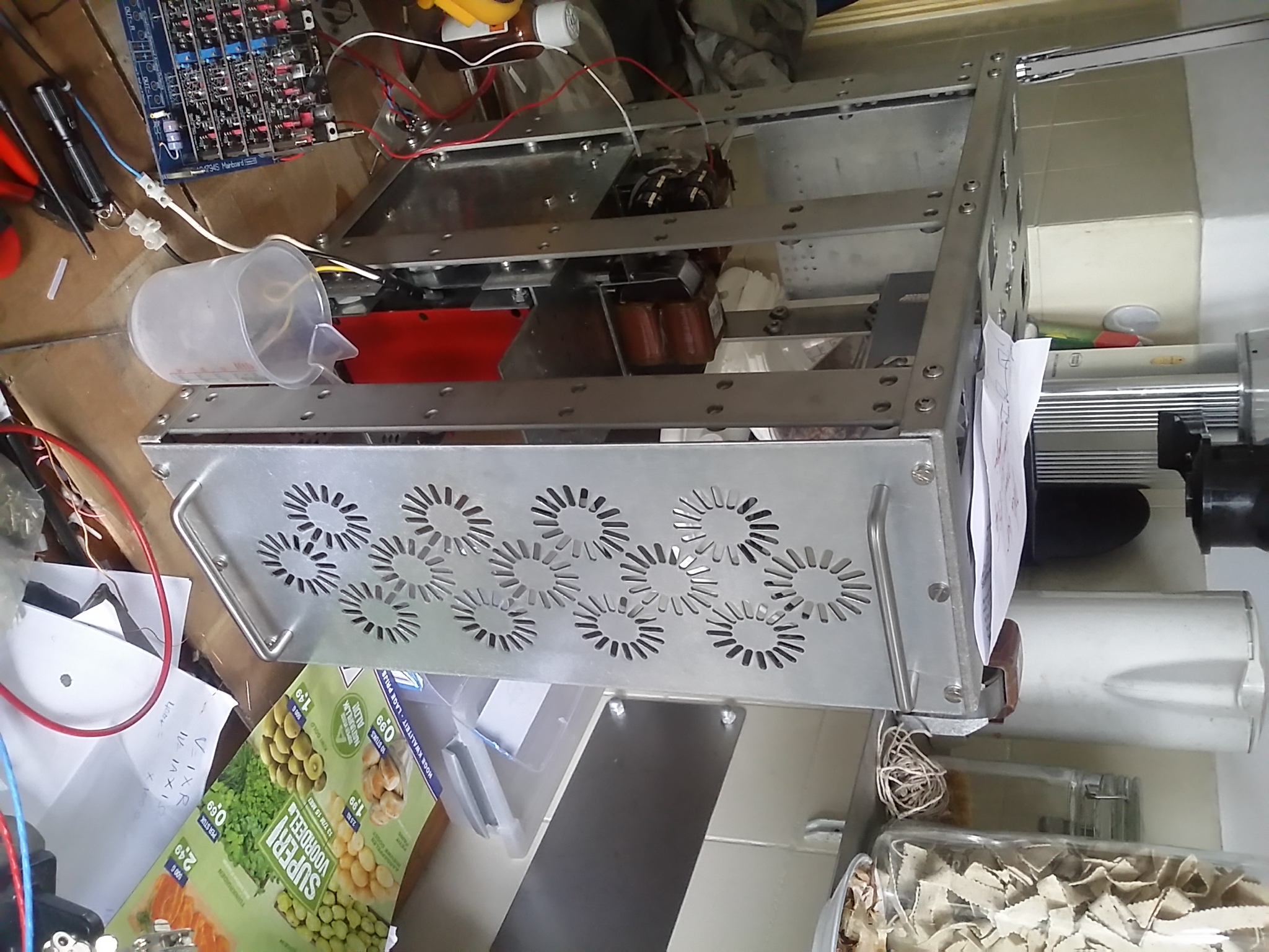

Happily my German engineered cnc machine seldom let's me down so I was able to make the back side of my dddac. No wonder Doede works in Germany.
As you can see no connectors on the back side. They are all on the two sides where they can easily be manipulated.
As soon as there is news about the problem with my circuit it will be put on the Web. Greetings, eduard
