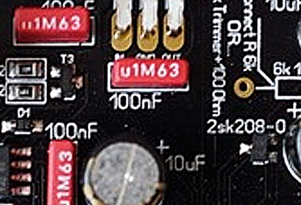

It looks like that particular deck has a different type SMD (FET ?) on board. On all 7 boards the SMD 2SK208 has a grey color and this particular board has on both sides a black SMD fet with a different notation.
It could be that the company who assembled the SMD parts did a mistake on this particular board. Does it look the same like the FET on the TENT shunt area? Close to the LEDs... That is the only other FET on the board. I f that is the case the are two options, send the board to audio creative. They have the batch 2sk208 FETs and can the right component for you. IF you feel you can do it yourself, you can ask to send you a few FETS. Just check the supply voltage to the DAC chip please. This should be 8 volt. Because may be the two FETs were switched....

Doede has a photo of new DAC on his web-site; there's one on Audio Creative site as well.
I compared your photo with the one from Doede's web site, and I can tell with good dose of certainty that the transistors were swapped by the crew who soldered smd devices. Your photo shows a slimmer transistor in place were the wider fet should be present. Just compare your photo with the crop I attached, and it will be clear what happened....
You don't have to disassemble anything; just remove the wrong transistor and solder the correct one in its place.
Nick

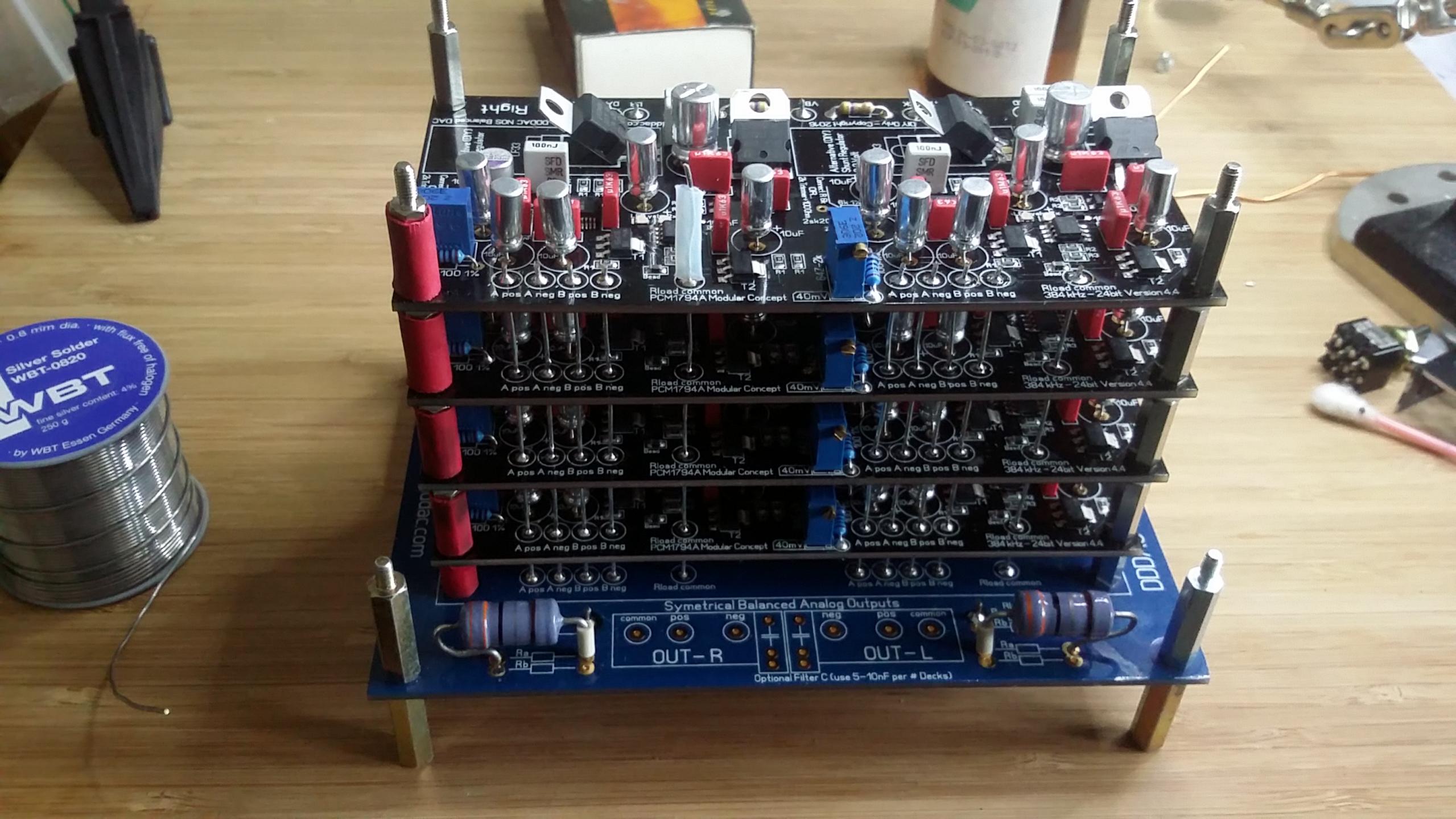

Hello,
I just did finish connecting the main board with the 4 dac boards. I did use another washer than the washer provided in the kit to give it a little more clearance but did use the original stand offs.
Used the wire included with the kit. The small Teflon tube on the upper board indicates what is left!!!
Must have been expensive wire.
Greetings, eduard

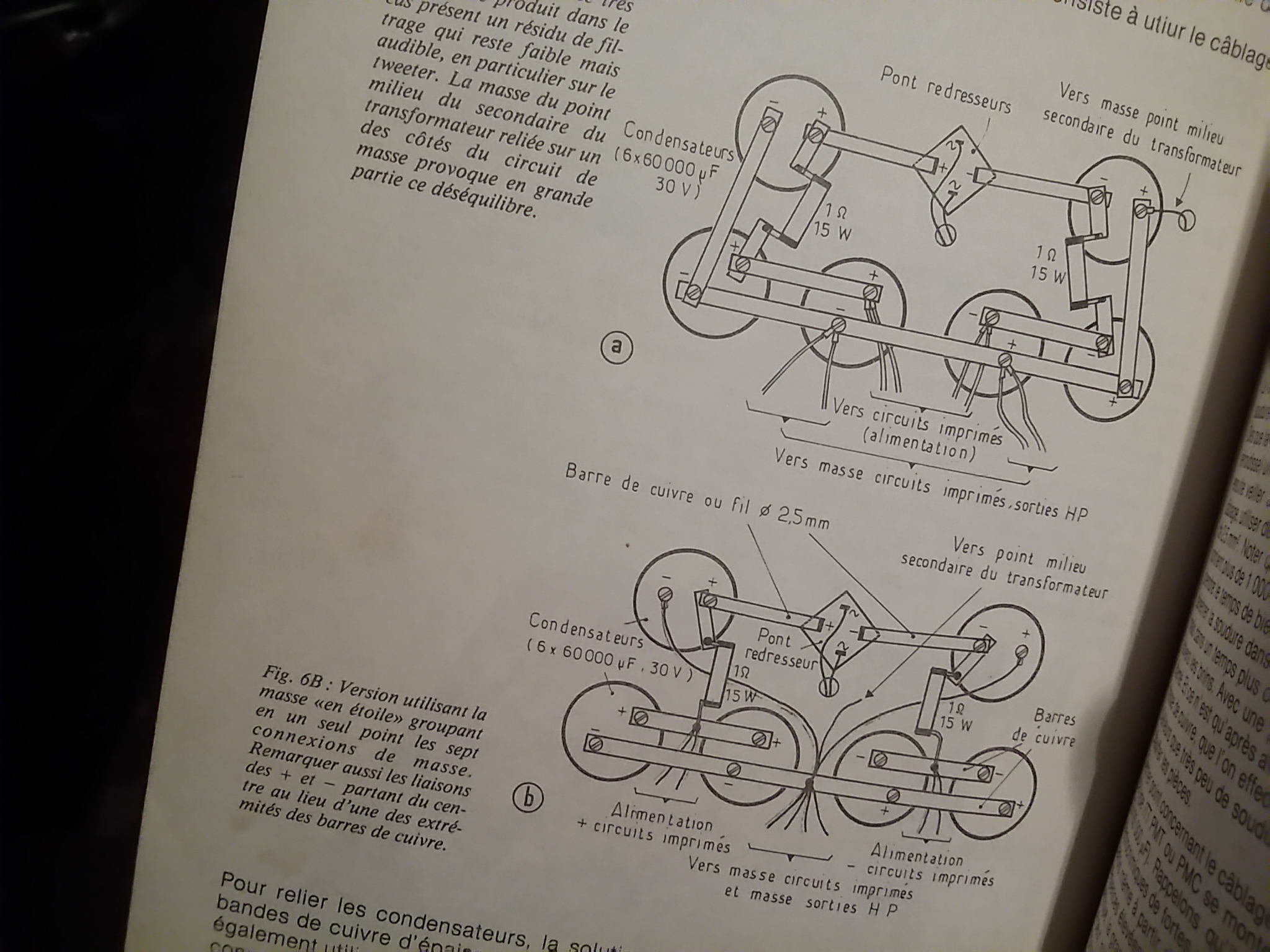

Hello Grael,
Sure the other pair is on the other side. Because the boards will be mounted vertically putting them on both sides will allow me to mount them closer to the board AND the one in lower position will not heat up the other one.
Be cause they are 2 watt i think it will not be a big problem lol.
Did you see my copy from the French l'Audiophile magazine about how to connect the power supply caps?
Because the current in this dac is rather high it could make a difference. anyway i will probably listen to Monsieur Hiraga.
In the attachment you can see how Supersurfer did wire his power supply caps. I will use my chokes in differential mode so the GND has to be take at the '' output '' of the last choke.
Doede did tell me that his circuit is low impedance so is not sensitive to chokes which are close by AND the Lundahl chokes have a very small field around them.
I want the output of the caps close to the 12 volt input of the motherboard.
Greetings, Eduard
