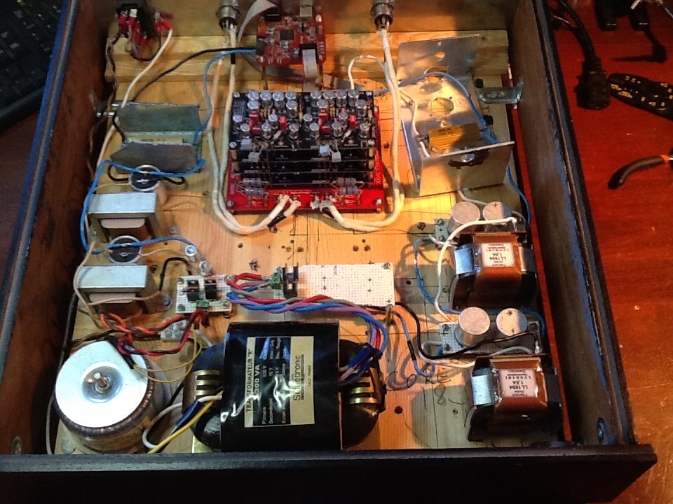

Ahh...finally my long time wanted R-core trafo (300va/15v), arrived. Very exited to hear if the SQ will be noticeable improved when compared to the 250va/15v toriodal with epoxy in the senter hole. The toriodal have been serving me well, and it is very silent. No hum at all.
Stay tuned.
One bad pic from my ipad. Any comments on the layout is welcome.

lay out
Hello,
The chokes are in the area where the field from the R core is the strongest. However the circuit is the close to the less radiating area. Turning the chokes with the 4 mounting holes facing the transformer will make them have less influence from the power transformer.
Once you know this R core is a keeper you could try to reduce the cable length going to the rectifier and reduce the cable length from the rectifier to the input choke or the first cap.
I will go for choke input and probably connect the rectifier on the terminal board of the choke.
I think locating the bleeder in another place could also be beneficial especially if it bleeds a big current. I guess it does because you are not using shunts.
Greetings, eduard
Thx stijn
I will fix the leads between rectifiers and first choke.
eduard mention that the bleeder were not in the best position. I thought that it must be a good thing to have it at last after the second choke and caps, so it can draw current through both chokes for good regulation and stability. Or am I missing something.
Since I`m a beginner in this diy game I want to learn as much as I can from you guys.

bleeder
Hello,
i think especially when the bleeder takes care of a lot of current the wires should be as short as possible. Not sure if you need to put it across the first cap or the cap of the last choke.
in my situation i wanna use the bleeder to just have enough current to be sure it will be a choke input.
because i will use the ll2733 for a choke input i need a transformer with a higher voltage. Tonight i will check if my 21 volt transformer will not give a to high tension for the 25 volt elna caps. Because of the 400mH choke the bleeder current doesnt need to be that high but maybe i will have to drain more current. I did find some info on the minimum current needed in relation to the current used for the circuit. This info is on my other pc i will post it later.
greetings, Eduard
