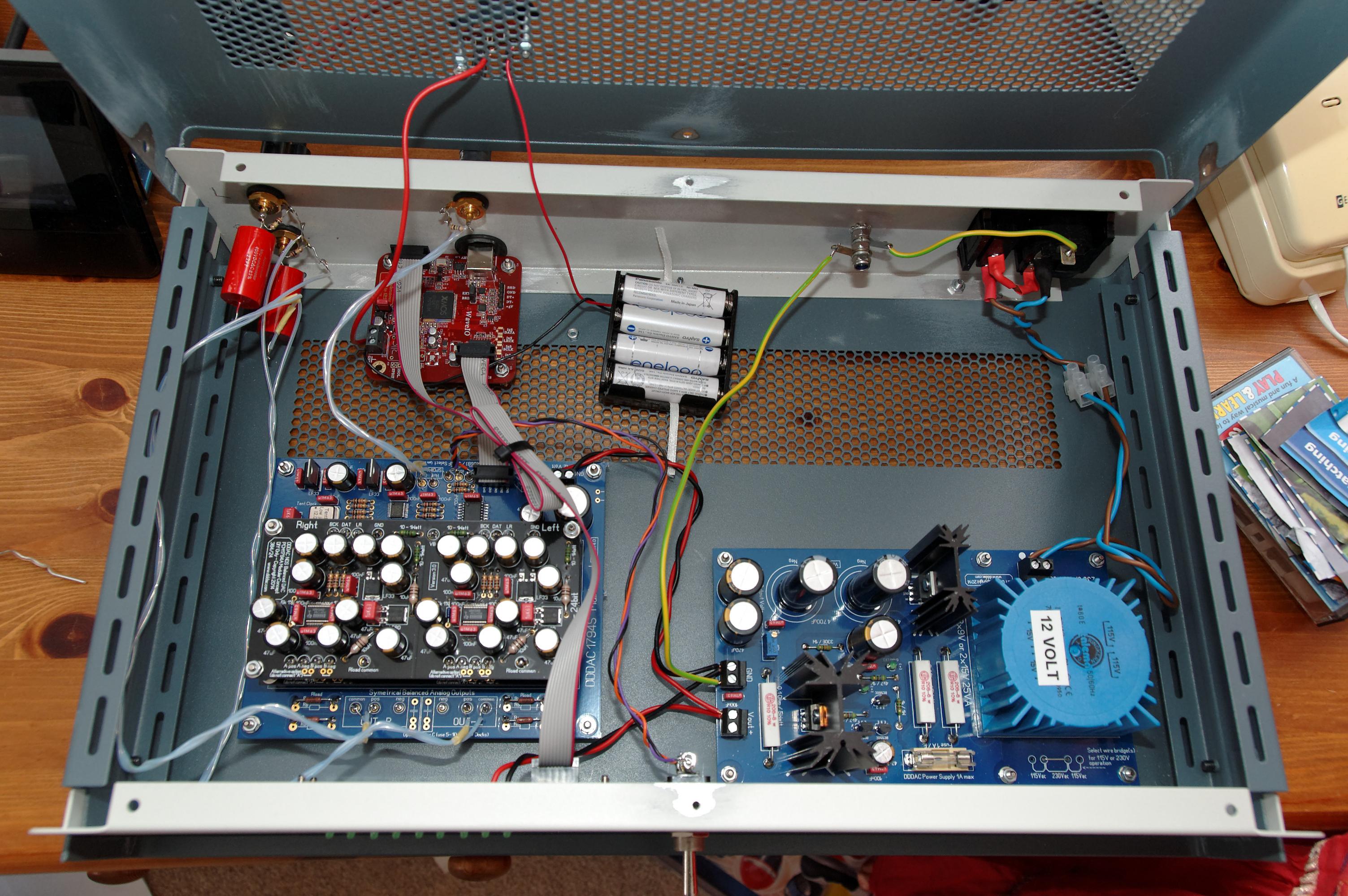

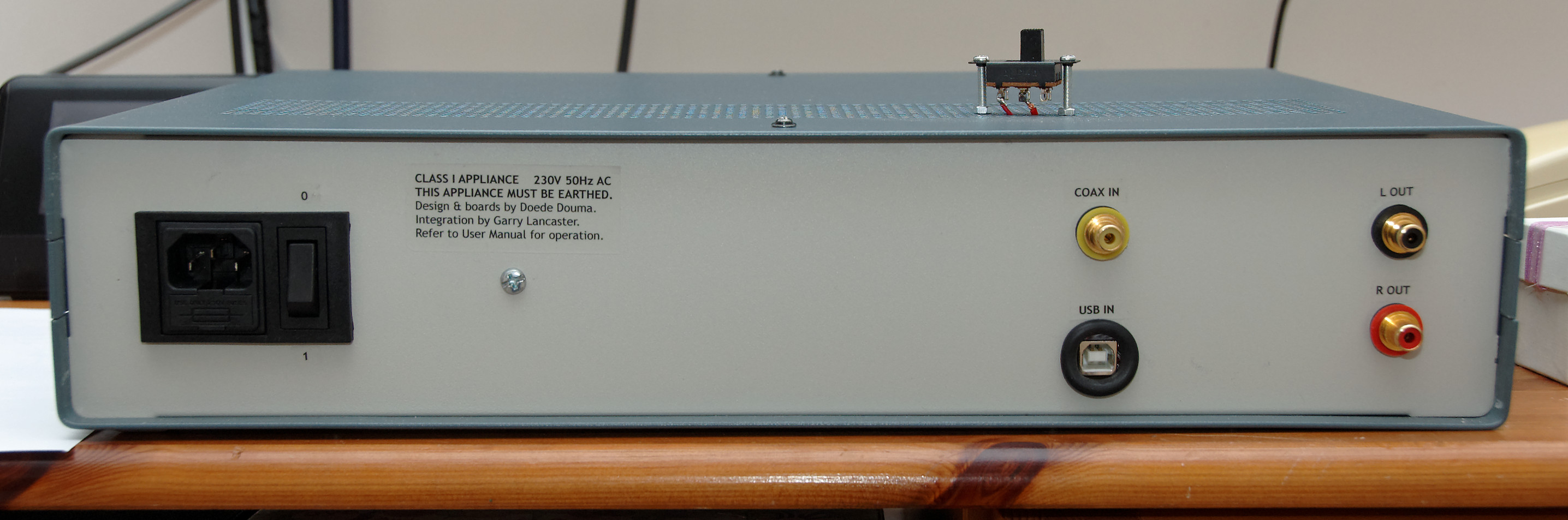

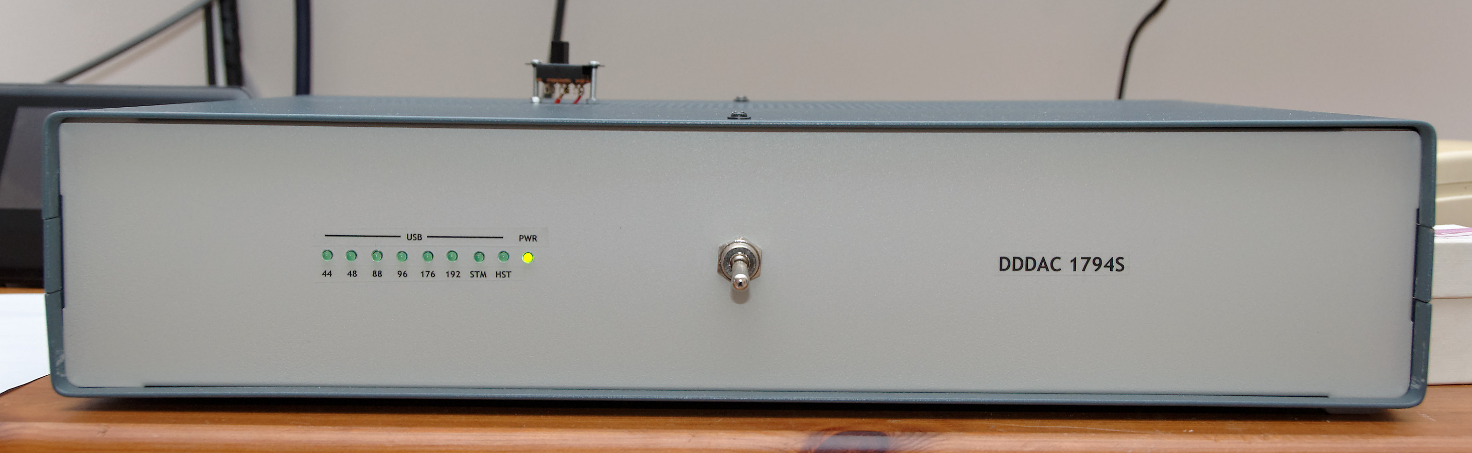

Hi All
I'm new to this thread and to this forum. Unlike the experienced DIYers on this thread, I've never built anything like this before, so I chose to buy the assembled boards. So, rather than a 'build', I call what I have done – choosing the case, sockets and so on, and connecting everything together with the small amount of soldering - an 'integration'.
I find the sound is full, and with realistic levels of bass, unlike most of the oversampling DACs I've heard. It is more like the non-oversampling TDA1541 in my CD player and TDA1543 in my Moodlab Dice DAC in that respect. However, it manages to extract higher level of details from recordings, and of course, has the ability to play high-resolution music.
I'm attaching some photos below.
I would like to thank Doede and the Audio Creative people for the design and providing the assembled board option, so that novices like myself can have a DDDAC. Of course, it is not the same as the full self-build option, but I still feel some of that same pride when I turn it on and it works!
You can see that I'm currently running the WaveIO from AA NiMH batteries. This was just to give me a flavour of the DDDAC's capabilities, not a long-term solution. Now I've decided I like the sound, I need to move to phase 2!
My DDDAC is pretty standard at the moment (apart from the 5V battery supply). I have the standard 12V power supply, standard S/PDIF mainboard with 2 decks, and the WaveIO. Output is through the standard Mundorf capacitors supplied in the kit.
I am definitely going to buy the 5V power supply, but I am wondering about output options. My pre-amp, a Naim NAC 62, is single-ended only, so I ruled out any balanced only output solutions. I was considering either:
1. The Cinemag 15b transformers.
2. The Mundorf Silver Gold Oil caps.
The prices are similar. The Cinemags would allow me to use both positive and negative DAC outputs. Capacitor output, however good the capacitors, is only using half of the DAC output (for my single-ended outputs, I mean). So, that pushes me towards the Cinemags. However, earlier on this epic thread opinions were divided as to whether a standard 2 deck DDDAC was adequate to drive the Cinemags or whether it would sound thin. Now there is more experience with this DAC, is there more of a consensus about this?

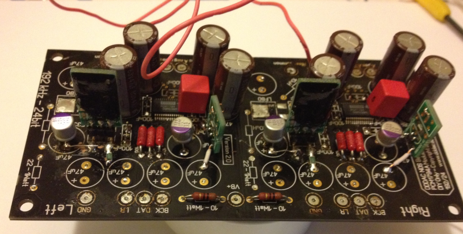

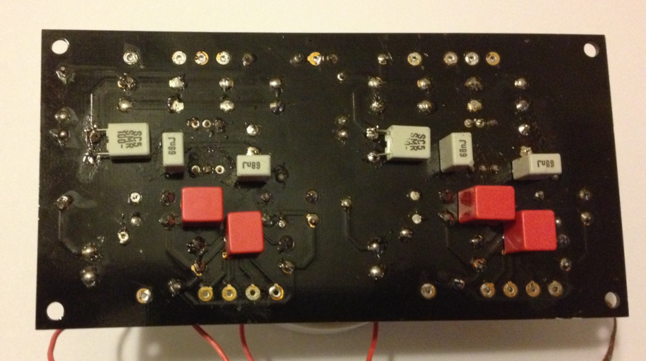

Digital PPS Film bypass caps
I rebuilt my original DDDAC boards to include all the changes I have been making with my other 2 DAC's to see if the improvements in SQ were repeated. The main change was to replace all the digital 0.1uf PET film caps with 0.068uf PPS film caps. I had already replaced the 0.1uf PET caps on the analog side with 0.022uf WIMA FKP2 PP film and foil caps. Because all these caps are larger than the PET's, all but one had to be installed through the bottom of the DDDAC board. I also removed all unused components from the DDDAC board. See pictures below. Film caps were also replaced with PPS caps on the red main board and 1/2 clock delay board. The only real difference between the two boards is that I have Belleson digital Vregs on the original board and ADM7150 DIY Vregs on the first board tested with PPS film caps. Both boards used the same chassis and power supplies including the 3 Salases for the 8V and +/-12V buffer.
IMO the SQ change was the same as I heard with my first DAC with PPS film caps. See http://www.diyaudio.com/forums/digit...ml#post4239418.
One change in SQ with PPS caps is that the difference between 96KHZ and 192KHZ recordings is more distinguishable with the 192KHZ recordings having more musical nuance and ambiance.
I hope somewhere in DDDAC land someone else will try PPS bypass caps on the digital circuitry to see if they experience what I heard. The mouser part number is 80-SMR5683J100J03L4 and costs about $1usd each in quantities of 10 or more for through-the-hole PPS capacitors. I needed 15 of them.
