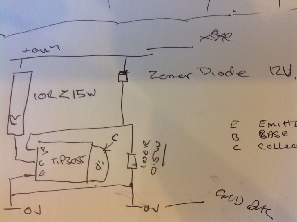

Hi James along with upgrading each cap To 10,000 uf, this is a sketch of the circuit after the last capacitor in place of the bleed resistor.

Are you aware this is basically turning this to a regulated supply again which is not what the choke supply is all about? The diagram is not so clear though.....
Yes, it will be shunt regulated. Apparently the quietest supply you can get. I'm not the educated one here, I'm just the one baking the cake.
Do you have shunts mounted on your dac boards?
I think this was the point. Raw psu to shunts. Making another shunt reg on the line between psu and already mounted shunts will only increase the impedance, slowing down whole process and effect we are after.

I have been using the nicely designed salas shunt regulators BEFORE I moved to the unregulated shoke supply.
You might be better off putting your effort on other details of the dac design.........................

Yeap that's my view.....
Thanks for your input chaps, got back to the guru who recommended the mod to the unregulated PSU and he didn't realise the DAC had regs installed, he was looking at the original DDDAC design.
So that clears up the confusion. 🙂

Well yes, but the DDDAc original supply is well regulated, very quiet, measures well, and the Dac always has the standard regs fitted. A friend has added a simple choke regulated supply to the satndard regs and reports a decent improvement in SQ so, unlike your bowels, looser is better when it comes to psus!
