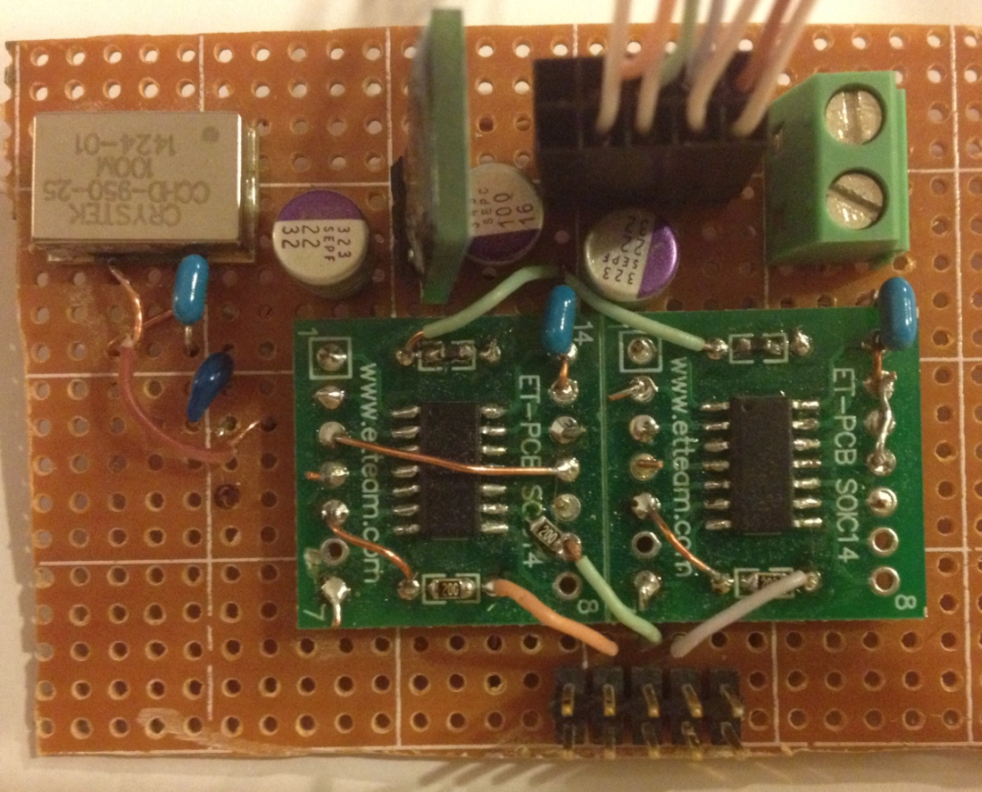

WaveIO Reclocker
I have a couple of S03 bare boards on order from Acko. In the meantime I constructed a simplified reclocker board using SOIC-14 adaptor boards and a perf board with pads on one side. I installed a 3.3V Belleson SPM with organic caps before and after the Vreg in addition to the 10nf ceramic caps at each device. Current draw is 70-80ma with only 3 reclocking flip-flop circuits used. I will upgrade to the Belleson SP standard so that no voltage dropping resistors are needed to keep from overheating the Vreg. The Crystek CCHD-950-100 includes a buffer so it was directly wired to the PO74G74 D flip-flop chips.
How does it sound? The music sounds more crisp, punchier and accurate. No change in musicality, flow, and listener fatigue which was very good before. The change in sound is small, but I'm going to keep the reclocker in my DDDAC. I suspect that the WaveIO with a Belleson 5V reg right at the external power input terminal already allows it to function as clean as possible. After I receive the S03 boards I will build and try one for comparison.
This simplified reclocker only works with the WaveIO and will NOT work with the rpi or BBB. It uses the isolator on the WaveIO. The main board and reclocker use the same unregulated power supply and ground.
Actually, I'm shocked that this board worked at all with no smoke or fire. It's about twice as much effort as the 1/2 clock delay board. Use of Acko S03 board highly recommended.

Great work! 🙂I have a couple of S03 bare boards on order from Acko. In the meantime I constructed a simplified reclocker board using SOIC-14 adaptor boards and a perf board with pads on one side.
I suspected you would get less improvement with the WaveIO compared to the Pi as the WaveIO already has a nice clock and was designed for audio, whereas the Pi really isn't and just fudges it's way along.
Why do you say your Diy reclocker wouldn't work with a Pi? Just the lack of Isolator? That's easily enough added with one of the free boards from diyinhk if you so choose.
