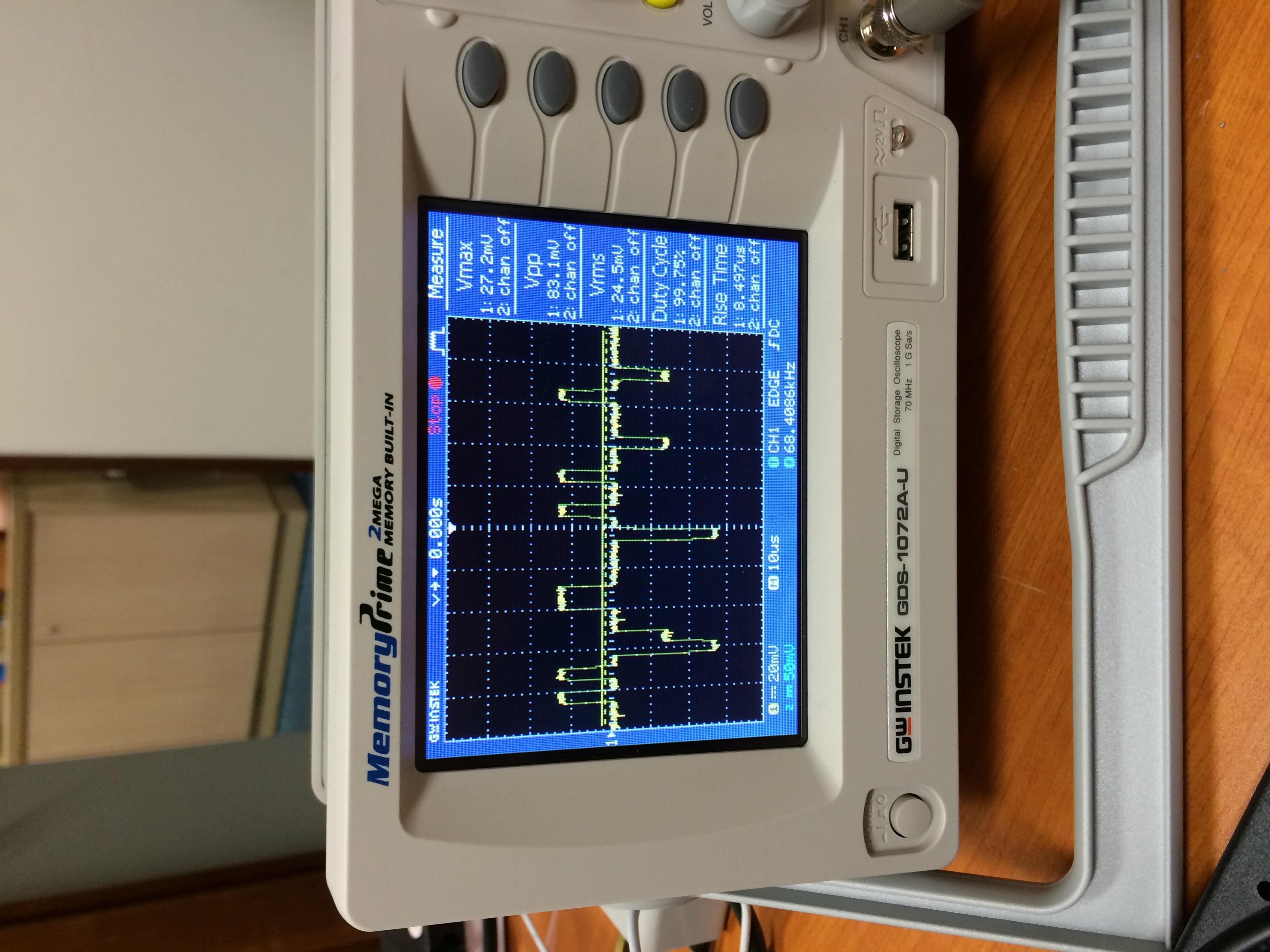

I have received my 4 deck kit last week and quickly build it up. Almost all stock and just want to share some interesting build observation here if this can help anyone.
I started with 1 deck and instead of using waveio board I have use Pi B P5 header I2S into main board running Picoreplayer. I power on the unit happily and observe only mV signal on my scope. Tried spdif same mV signal. I troubleshoot for 2 days and finally decided that the only thing i never do is connect the waveio board. So I plug in and connect to USB and turn on. Viola, there is signal. After playing for few hrs I disconnect the waveio board and reconnect the Pi, this time it works. So I though maybe something I have done wrong somewhere but I dun know where. I reboot the system few time and even change to spdif and another I2S player. All works flawlessly.
This morning I stack the second deck. Again no signal on scope. Then after few hrs troubleshooting I decided to do the same trick again and plug in the waveio board again, viola, music comes. Happily playing music now.
So is there some initialisation in the waveio board into the dddac? Hope this help anyone who has the same problem as me...

Hi CK,
This sounds very akward and I assume you are the only one having this. Question, did you connect a selection switch to the usb or spdif select pin? For me it seems your board is in 3state mode in the I2S bus. You cannot leave the pin open, you have to select something. Connecting the WAVEIO could have caused this.
Hi Doede,
Yes I did...I connect a jumper to it and measure it is shorted to the correct USB/I2S position. All I got is the signal as my attached waveform below.
Then after I connect the waveio board and it works. I disconnect the waveio and then without changing anything I reconnect the Pi. It works flawlessly also. Dac board all stock. My friend is building his dac also and not power on yet. I have asked him to try this and see whether any sound if the first bootup is not waveio board. I will keep posted the result.
Anyway seems like an initialization and then it works, problem solved.

Hi all,
Just want to update on the bug that I encountered. The first power on must connect the waveio board or the output will be at max and no signal. My friend building his kit also encounter same problem and eventually solve connecting the waveio board.
Hope this can help anyone.
