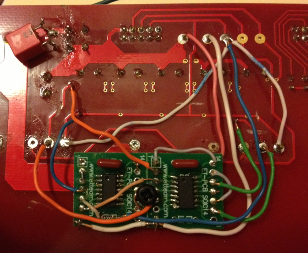

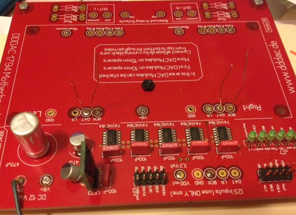

1/2 Clock delay bottom install
I just built a second 1/2 clock delay circuit board but this time I installed it on the bottom of the red main board which puts it out of sight. I think some of the wires lengths may be a little shorter, but this location is no less time consuming to implement.
I drilled an M3 hole through the adaptor boards and main board with a plastic nut spacer and screw to hold it firmly in place. I used 24ga CAT5e wires. For multiple connections I loop a single wire through the points as much as possible.
