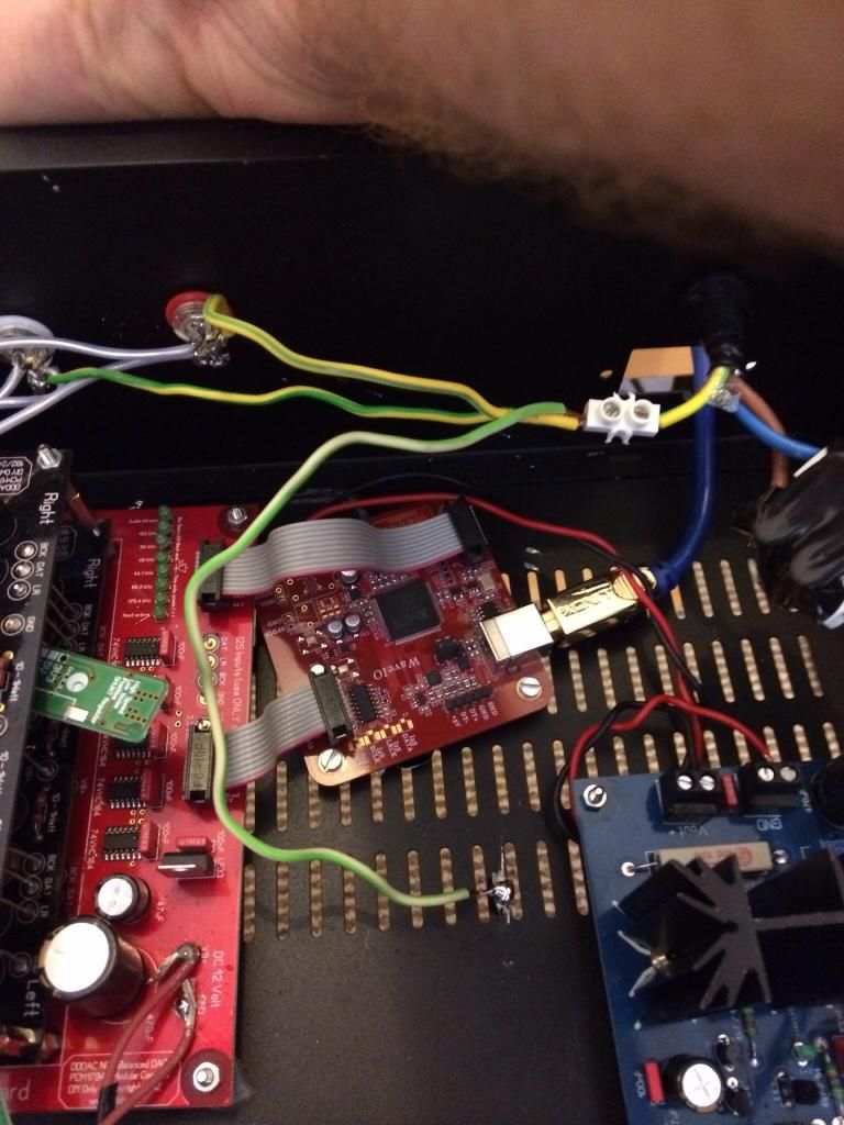

Hmmm, that's kind of the opposite of what I recommended to try... I wouldn't ground the rca to the chassis and wouldn't connect that to mains earth.
Unplug a few bits and see if it effects the noise. Have you tried without the USB plugged in? Without the WaveIO connected to the DDDAC? With the WaveIO and USB connected but with no power to the DDDAC?
I have earthed...
That earthing scheme is asking for a hum problem. only connect the RCA negatives to the common output of the dddac main board. Eventuelly if you want to go by the book, you can connect the earth point/star ground, of the dddac powersupply to a "chassis ground" somewhere, which in turn could be connected to mains ground.
Hi all, thanks for your help here. Yes the ddac still badly hums when it is not earthed and all is floating.
James, I have tried all you suggested, ie making sure the one let of the wav10 is not grounded and making sure the RCA terminals are not touching the case etc and it still hummed. As you can see i have tried the exact opposite in earthing all the above, again to a negative effect.
I will try and swap things out bit by bit to see when the hum stopes.
