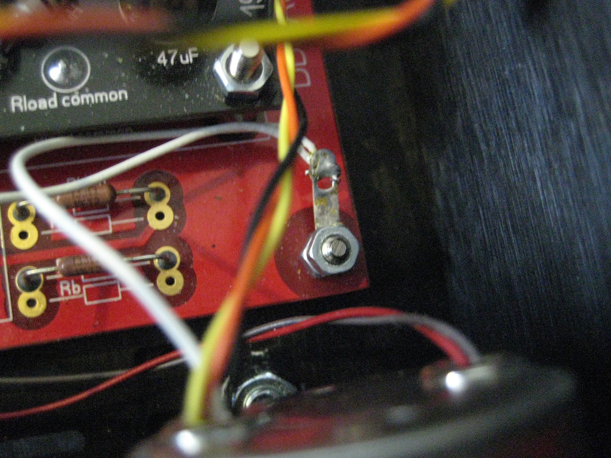

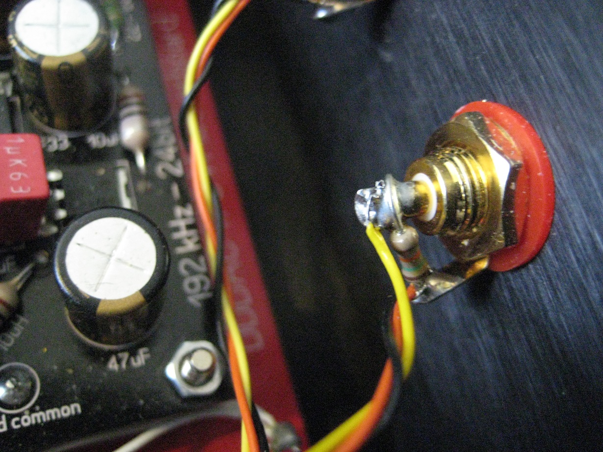

this is clearly not normal. can you post a clear picture how you wired it up?

I had a slightly loose solder joint. I have repaired that and the sound is a lot better, the hum is still there but not quite as bad.
I could post a picture but its a bit of a birds nest in there, as I kind of threw the cinemags in there.

http://i1138.photobucket.com/albums/n533/SovereignKing/imagejpg2-1.jpg
http://i1138.photobucket.com/albums/n533/SovereignKing/imagejpg1-2.jpg
As I said its a birds nest.
Rather than wire the cinemags to the rca's I joined the cinemag wires to the end of the wires going to the rca's, I know it's a bit Micky mouse but I was just wanting a quick demo as I am taking my DAC to a load of Art of Sound members tomorrow for them to hear.
I have traced all the wires back correctly but there is a definite hum that I need to get rid of .

Can't see from those pics, but are your RCAs grounded to the chassis? best if they're not.I have traced all the wires back correctly but there is a definite hum that I need to get rid of .
Also, are you using a WaveIO? If so, there's one of the mounting holes which you don't want to connect to the metal chassis as it's a grounding point. It's the one with the ground symbol by it.
Does the hum change if your Cinemags aren't sat on the metal chassis?
Worth a quick look at these bits, humming often means you have a grounding issue.

the shadows of the wires are hard to distinguish from the real wires 😱http://i1138.photobucket.com/albums/n533/SovereignKing/imagejpg2-1.jpg
it looks as if you have connected the common to something? just to make sure, leave WaveIO floating, cinch floating and only connect POs and NEG terminal to the primary of the transformer. humm is ground loops in most cases
Ahh yes, hard to see, but looks as though you have the outputs connected to common and pos rather than pos and neg.the shadows of the wires are hard to distinguish from the real wires 😱
Also looks like you have them wired out of phase, so one is red for pos, the other is brown for pos. That will make you speakers cancel each other out. Make sure they're on pos and neg and that both channels are wired the same.
I know the pictures are confusing but the cinemags are definitely only wired to pos and neg on the left and right channels , and both reds are on the pos and both browns are on negs. So I'm really confused where the hum is coming from, I'll take some clearer pictures tonight.
Have you tried this...see pics.
So white wire ( shield) to case ground and black wire to signal ground.
It removed the last tiny bit of hum I had....
