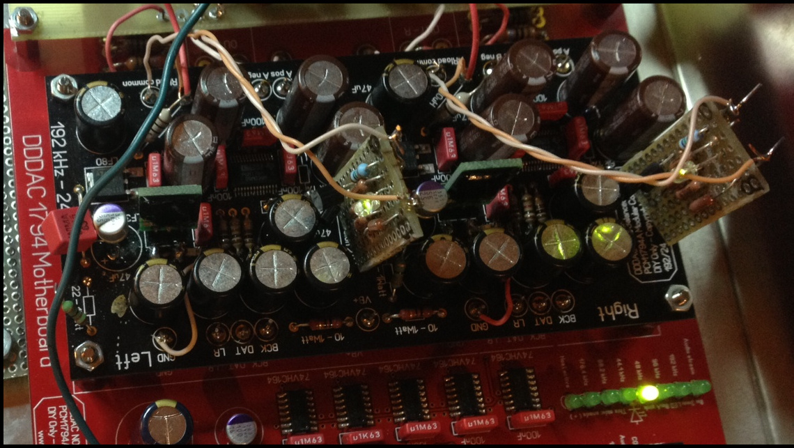

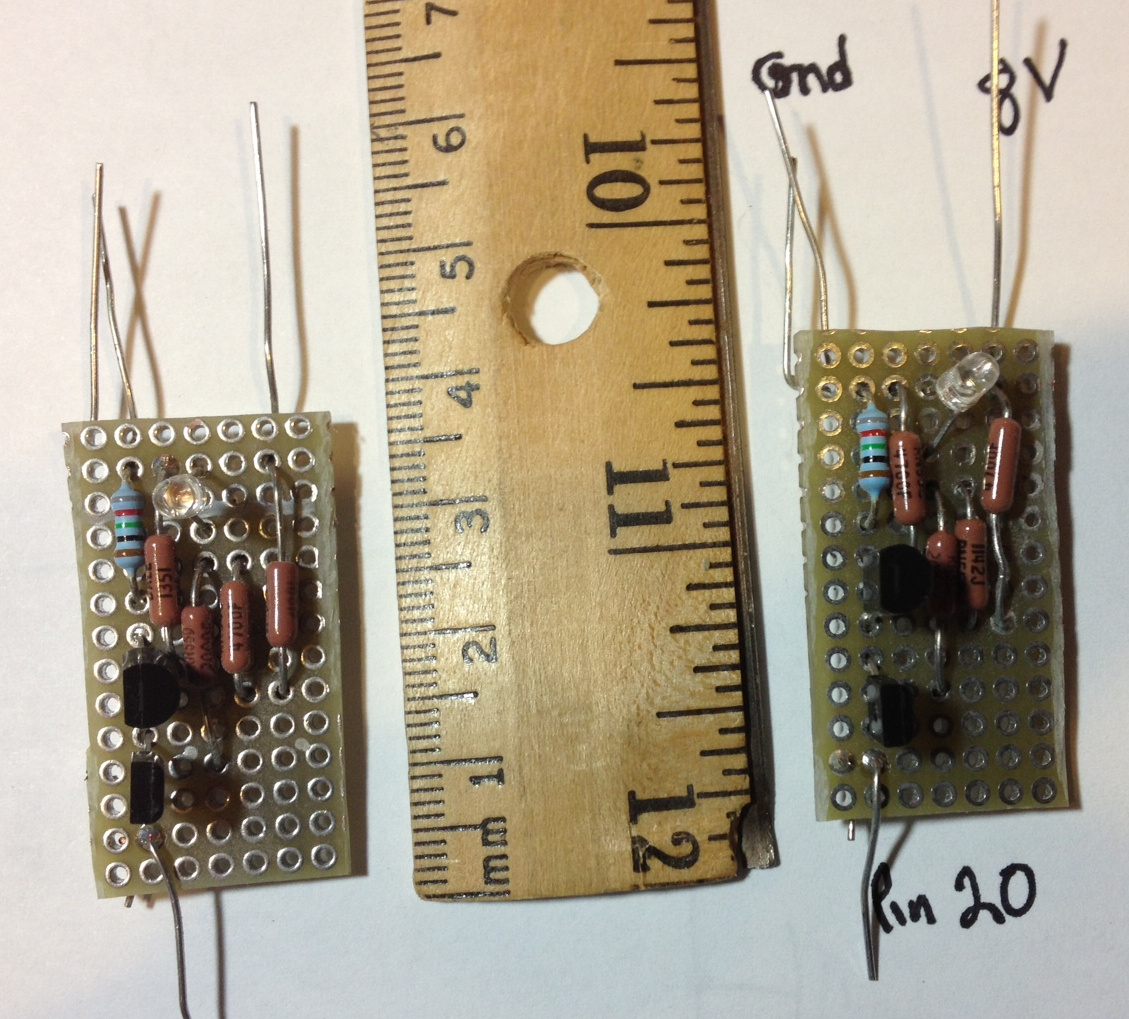

CCS Boards Installed in DDDAC
I built a couple of CCS boards and installed them in my fully tweaked DDDAC board in place of the 6K resistor. The CCS sound is different compared with the 6K resistor. My first reaction is that the music is more forward with more energy - especially in the midrange and bass. Also there is more ambient sound and better instrument/voice separation. Complex treble material congests a bit and bad recordings sound worse, but this could be "new parts sound". The 6K resistor sound is slightly more compressed by comparison.
Measurements at pin 20 are: current = 0.41ma and volts = 2.44. Rload is 2.9 volts.
I will let the DDDAC play 24hours/day for the next 3-4 days for the components to break in. I want to check for long term listenablilty and musicality next. New components always have an "unsettled" sound which should disappear with time. I will then put the 6k resistor back in the circuit for comparison.
The CCS circuit would be 1/4 the size of the test boards using SMD resistors. It will also need a pot to adjust for exactly 0.400ma or 2.40V at pin 20 or 2.7V into 133 ohm load resistors, or whatever the magic number happens to be. This would also accommodate unsorted JFETS.
I hope someone is testing a super premium resistor such as a Rhopoint or TX2575 to pin 20. I find the quality of load resistors always affect total sound quality. This will work on board stacks whereas the CCS with pot can only be easily implemented on a single board DDDAC.

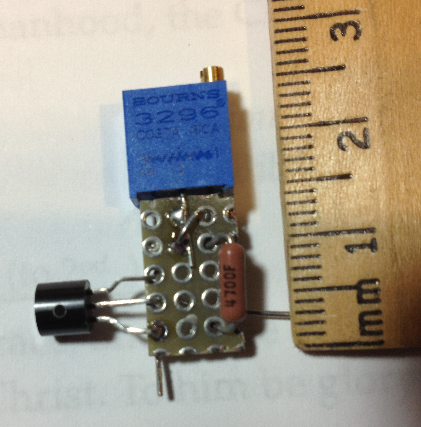

Simple JFET CCS
I tested a simple adjustable JFET CCS circuit using a 2SK170. Attached is a picture of one I constructed. Doede, like the parts count? Breadboard testing showed that the gate resistor is not needed. A fixed 470 ohm resistor and a 500 ohm pot should work. The 2SK369 and 2SK117 should be suitable alternative JFETS. It is simple and small enough for anyone to build. The 2SK170 and the other JFETs are available on eBay. The main issue is that the 6K resistor is closely surrounded with tall components, so solder access is an issue.
I did a dynamic test with .5v signals imposed on 2.4V to the circuit. The scope showed resultant voltage signal variations of 2.2mv across the 709 ohm source resistor as compared to 0.2mv for the 2 transistor CCS. The signal looked clean. This represents a current variation of about 0.8%. Does Spice simulation provide the types and amounts of distortion expected for these two CCS circuit designs? Supposedly JFETs have even order distortion which is pleasing.
I will wait to see how the 2 transistor CCS sounds after 100 hours of break-in time before I insert the simple JFET boards.
